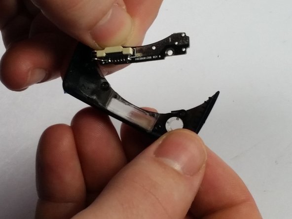

  3. Bell and Howell DNV16HDZ LED Replacement: crwdns2935265:03crwdnd2935265:01crwdnd2935265:01crwdne2935265:0
    • It will still be connected by a plastic film. This can also be disconnected by pulling up the white part where it connects to the light circuit board.

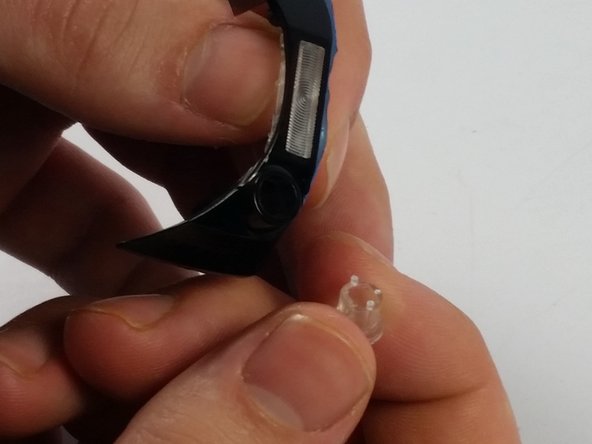

  4. Bell and Howell DNV16HDZ LED Replacement, LED: crwdns2935265:04crwdnd2935265:01crwdnd2935265:01crwdne2935265:0
    • Take out the two 20 mm Phillips #0 screws that attach it to the shutter.
  5. Bell and Howell DNV16HDZ LED Replacement: crwdns2935265:05crwdnd2935265:01crwdnd2935265:03crwdne2935265:0 Bell and Howell DNV16HDZ LED Replacement: crwdns2935265:05crwdnd2935265:02crwdnd2935265:03crwdne2935265:0 Bell and Howell DNV16HDZ LED Replacement: crwdns2935265:05crwdnd2935265:03crwdnd2935265:03crwdne2935265:0
    • The two 30 mm Phillips #0 screws left can be removed to gain access to the circuit board along with the LED.
    • From here we can pop out the LED using the wedge or your fingers if you can manage it.
