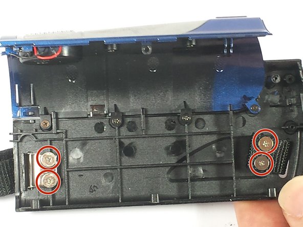

  4. Bell and Howell DNV16HDZ Hand Strap Replacement, Hand Strap: crwdns2935265:04crwdnd2935265:01crwdnd2935265:02crwdne2935265:0 Bell and Howell DNV16HDZ Hand Strap Replacement, Hand Strap: crwdns2935265:04crwdnd2935265:02crwdnd2935265:02crwdne2935265:0
    • Pull the side with the hand strap upwards to disconnect it from the camcorder.
    • Unscrew the four 40 mm Phillips #0 screws.
    • Add the new hand strap now.
