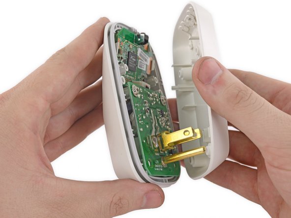

    • Remove the four 11.9 mm triangle screws securing the two halves of the case together.
    • The upper two screws are hidden underneath the label, so you'll need to cut away the sticker directly above the screws.
  3. Belkin WeMo Switch Teardown: crwdns2935265:03crwdnd2935265:01crwdnd2935265:02crwdne2935265:0 Belkin WeMo Switch Teardown: crwdns2935265:03crwdnd2935265:02crwdnd2935265:02crwdne2935265:0
    • Carefully pry the back case off.

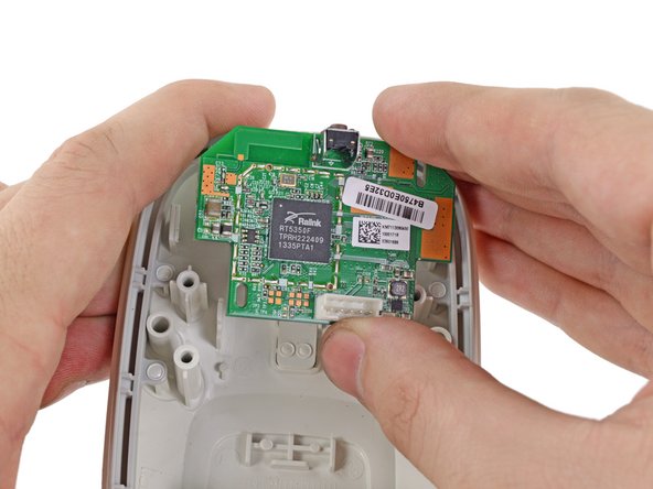

  7. Belkin WeMo Switch Teardown: crwdns2935265:07crwdnd2935265:01crwdnd2935265:03crwdne2935265:0 Belkin WeMo Switch Teardown: crwdns2935265:07crwdnd2935265:02crwdnd2935265:03crwdne2935265:0 Belkin WeMo Switch Teardown: crwdns2935265:07crwdnd2935265:03crwdnd2935265:03crwdne2935265:0
    • Use the flat end of spudger to gently pry the retaining flaps away from the motherboard.
    • The motherboard should now come free.
  8. Belkin WeMo Switch Teardown: crwdns2935265:08crwdnd2935265:01crwdnd2935265:02crwdne2935265:0 Belkin WeMo Switch Teardown: crwdns2935265:08crwdnd2935265:02crwdnd2935265:02crwdne2935265:0
    • Components on the motherboard:
    • Ralink RT5350 Wi-Fi SoC
    • Winbond W9825G6JH-6 256 Mb 166 MHz SDRAM
    • Macronix MX25L12835EMI-10G 128 Mb NOR Flash Memory
    • Momentary push button switch for factory reset
    • Momentary push button switch for power switch
  9. Belkin WeMo Switch Teardown: crwdns2935265:09crwdnd2935265:01crwdnd2935265:02crwdne2935265:0 Belkin WeMo Switch Teardown: crwdns2935265:09crwdnd2935265:02crwdnd2935265:02crwdne2935265:0

Thank you, that was a big help! The exterior on off button had come loose and was rattling around inside and I was able to repair it thanks to your tear down guide.
L Threet - crwdns2934203:0crwdne2934203:0
A T-7 torx screwdriver works well if you don't have the 2mm triangle
olaf - crwdns2934203:0crwdne2934203:0
Thanks, also here 2 of them after little use: The exterior on off button had come loose and was rattling around inside. Very poor quality now I have opened them. Guess need to try and glue them back on.
Helmuth van Es - crwdns2934203:0crwdne2934203:0
