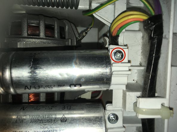

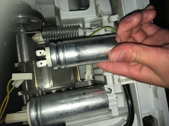

    • Remove the 1 Phillips #2 cross-head screw for the capacitator that says 8 on it
    • Remove the two connectors on the side of the capacitor
To continue, put in your new capacitor then follow the steps in reverse.
