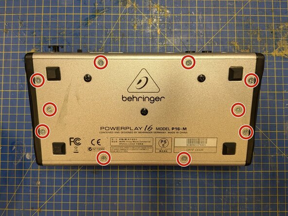

    • Remove 10 Phillips #2 screws from around the edges of the bottom plate
    • Some of these screws are longer than others, so it's worth keeping track of which one came from where.
    • Use a spudger or flathead screwdriver to lever the bottom plate free.

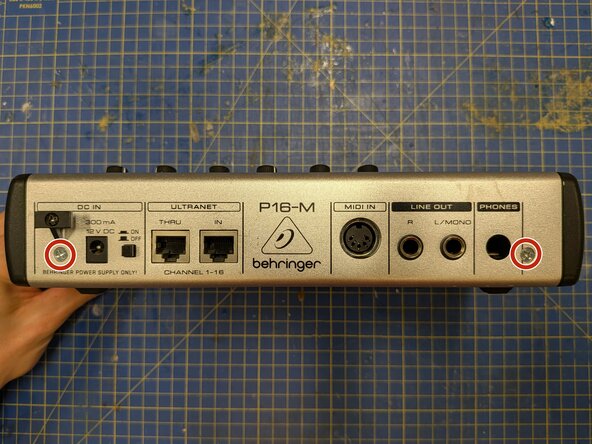

    • Remove the two silver Phillips #2 screws from the back plate.
    • With the P16-M face down on the table, ease the circuit board away from the back plate to free the connectors from their slots, then manoeuvre it out of the case.
