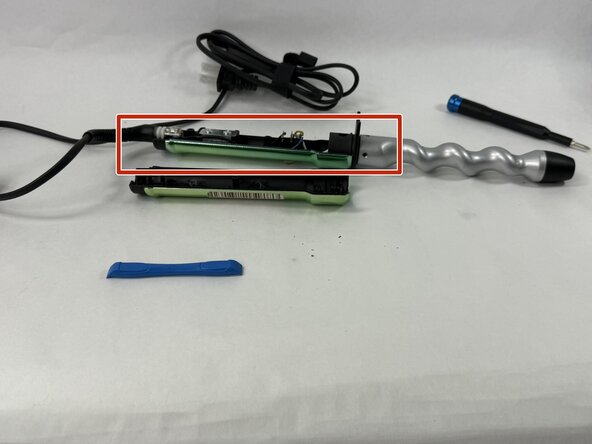

    • Remove all four of the 4 mm Phillips screws on either side of the casing.
  2. Bed Head Curlipops Heating Element Replacement: crwdns2935265:02crwdnd2935265:01crwdnd2935265:01crwdne2935265:0
    • Using a opening tool, insert it along the seam of where both halves of the casing meet, and slowly pry the left side of the casing from the right.
    • Gently pull back the right side of the casing from the center molding.

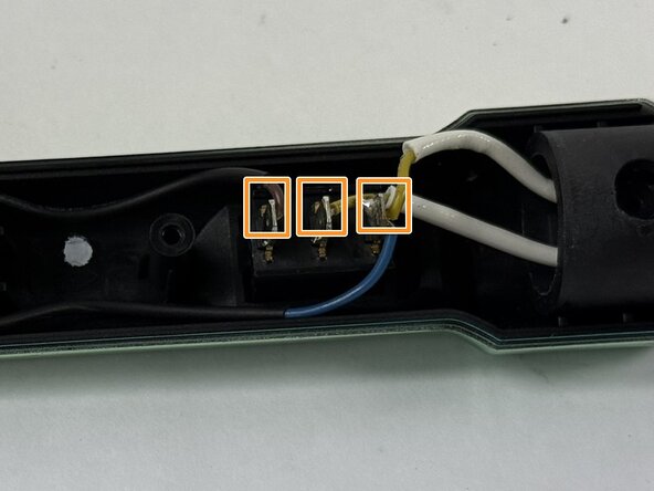

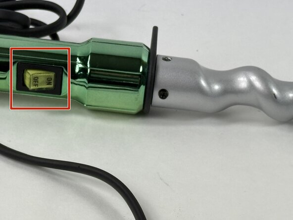

  3. Bed Head Curlipops Heating Element Replacement, On Switch: crwdns2935265:03crwdnd2935265:01crwdnd2935265:01crwdne2935265:0
    • Move wiring or other components away from main soldering field
  4. Bed Head Curlipops Heating Element Replacement: crwdns2935265:04crwdnd2935265:01crwdnd2935265:02crwdne2935265:0 Bed Head Curlipops Heating Element Replacement: crwdns2935265:04crwdnd2935265:02crwdnd2935265:02crwdne2935265:0
    • Release the securing tabs on the on switch to the center molding.
    • Use Flat head Screwdriver 4mm to break off the solder where the wires meet the switch.
  5. Bed Head Curlipops Heating Element Replacement: crwdns2935265:05crwdnd2935265:01crwdnd2935265:01crwdne2935265:0
    • Press new switch back into the center molding and use a soldering iron to solder wires on new switch.

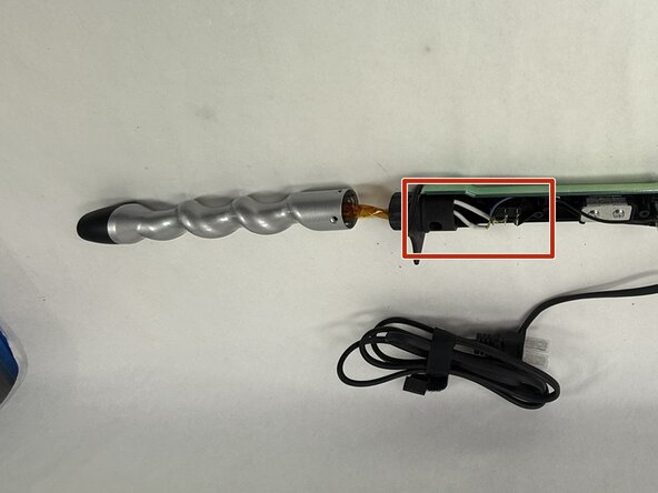

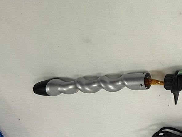

    • Remove the four 4 mm Phillips screws shown on the heating element housing.
    • Pull back on the heater housing to release it from main handle molding.
  7. Bed Head Curlipops Heating Element Replacement: crwdns2935265:07crwdnd2935265:01crwdnd2935265:02crwdne2935265:0 Bed Head Curlipops Heating Element Replacement: crwdns2935265:07crwdnd2935265:02crwdnd2935265:02crwdne2935265:0
    • Locate the wiring of the heating element on the on switch.
    • Use Philips Screwdriver #2 to remove the solder from both wires
    • Once both wires are released, pull back on the heating element to release it from assembly.
  8. Bed Head Curlipops Heating Element Replacement: crwdns2935265:08crwdnd2935265:01crwdnd2935265:01crwdne2935265:0
    • Use Soldering iron to reconnect heating element wires to metal tabs on the on switch.
