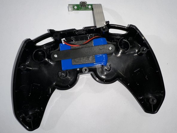

    • Use a Phillips #0 screwdriver to remove the seven 5 mm screws from the back of the controller.
  2. Beboncool Wireless Switch Pro Controller Charging Port Replacement: crwdns2935265:02crwdnd2935265:01crwdnd2935265:02crwdne2935265:0 Beboncool Wireless Switch Pro Controller Charging Port Replacement: crwdns2935265:02crwdnd2935265:02crwdnd2935265:02crwdne2935265:0
    • Gently separate the top and bottom halves of the controller.
  3. Beboncool Wireless Switch Pro Controller Charging Port Replacement: crwdns2935265:03crwdnd2935265:01crwdnd2935265:01crwdne2935265:0
    • Unplug the battery.
  4. Beboncool Wireless Switch Pro Controller Charging Port Replacement: crwdns2935265:04crwdnd2935265:01crwdnd2935265:02crwdne2935265:0 Beboncool Wireless Switch Pro Controller Charging Port Replacement: crwdns2935265:04crwdnd2935265:02crwdnd2935265:02crwdne2935265:0
    • Use a Phillips #0 screwdriver to remove the two 5 mm screws holding the charging port in place.
    • Remove the charging port.
