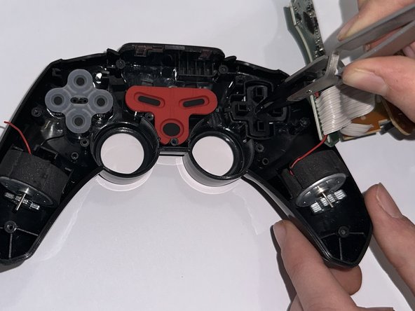

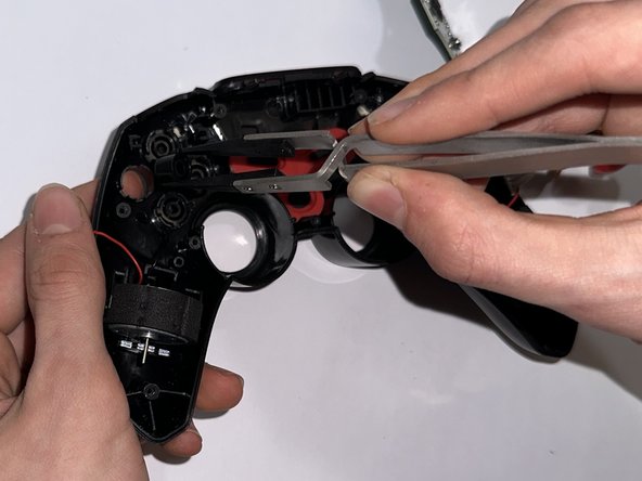

    • To remove the alphabetic buttons, remove the translucent silicone cover.
    • Use tweezers or your fingers to remove the buttons.
    • Pushing a button from below will elevate them enough to easily grab them.
  7. Beboncool Wireless Switch Pro Controller Buttons Replacement: crwdns2935265:07crwdnd2935265:01crwdnd2935265:02crwdne2935265:0 Beboncool Wireless Switch Pro Controller Buttons Replacement: crwdns2935265:07crwdnd2935265:02crwdnd2935265:02crwdne2935265:0
    • To remove the directional buttons, first remove the translucent silicone cover. Then, use tweezers or your fingers to remove the button pad.
    • As with the alphabetic buttons, push on the buttons from below, then grab them.
