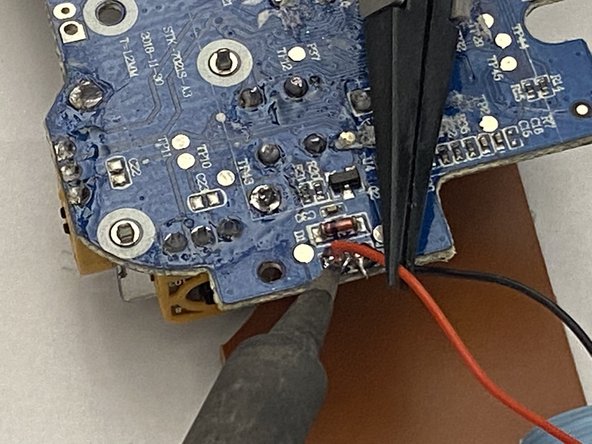

  6. Beboncool Gamepad for Nintendo Switch Vibration Motors Replacement, Vibration Motors: crwdns2935265:06crwdnd2935265:01crwdnd2935265:03crwdne2935265:0 Beboncool Gamepad for Nintendo Switch Vibration Motors Replacement, Vibration Motors: crwdns2935265:06crwdnd2935265:02crwdnd2935265:03crwdne2935265:0 Beboncool Gamepad for Nintendo Switch Vibration Motors Replacement, Vibration Motors: crwdns2935265:06crwdnd2935265:03crwdnd2935265:03crwdne2935265:0
    • Locate the two solder points corresponding to the malfunctioning vibrational motor.
  7. Beboncool Gamepad for Nintendo Switch Vibration Motors Replacement: crwdns2935265:07crwdnd2935265:01crwdnd2935265:02crwdne2935265:0 Beboncool Gamepad for Nintendo Switch Vibration Motors Replacement: crwdns2935265:07crwdnd2935265:02crwdnd2935265:02crwdne2935265:0
    • Desolder the two connection points corresponding to the malfunctioning vibration motor.
    • Once the solder has been sufficiently melted, carefully pull the wires away from the solder point with tweezers.
    • For help with soldering best practices, check out this Soldering and Desoldering Connections Guide.
