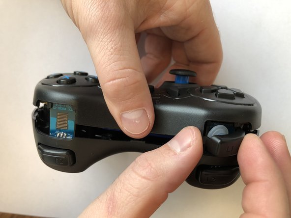

    • Gently separate the two halves of the controller.
    • As the two covers come apart the L1 and R1 button, will fall free from the controller. Be sure not to lose them if they should pop out and fall.

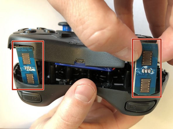

    • Be sure to slide the small circuit boards out of the covers to be able to separate the two halves

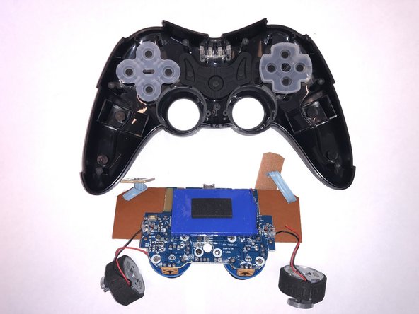

  5. Beboncool Gamepad for Nintendo Switch Joystick Replacement: crwdns2935265:05crwdnd2935265:01crwdnd2935265:03crwdne2935265:0 Beboncool Gamepad for Nintendo Switch Joystick Replacement: crwdns2935265:05crwdnd2935265:02crwdnd2935265:03crwdne2935265:0 Beboncool Gamepad for Nintendo Switch Joystick Replacement: crwdns2935265:05crwdnd2935265:03crwdnd2935265:03crwdne2935265:0

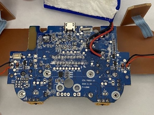

    • Lift the motherboard from the back case with the vibration motors and button boards attached.

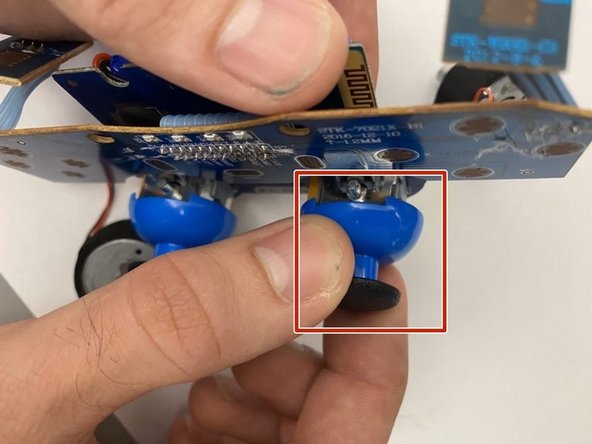

  6. Beboncool Gamepad for Nintendo Switch Joystick Replacement, Joystick: crwdns2935265:06crwdnd2935265:01crwdnd2935265:02crwdne2935265:0 Beboncool Gamepad for Nintendo Switch Joystick Replacement, Joystick: crwdns2935265:06crwdnd2935265:02crwdnd2935265:02crwdne2935265:0
    • Remove the joystick cover from the joystick actuator by firmly pulling the cover away from the actuator.
  7. Beboncool Gamepad for Nintendo Switch Joystick Replacement: crwdns2935265:07crwdnd2935265:01crwdnd2935265:02crwdne2935265:0 Beboncool Gamepad for Nintendo Switch Joystick Replacement: crwdns2935265:07crwdnd2935265:02crwdnd2935265:02crwdne2935265:0
    • Gently separate the battery pack from the back of the motherboard, leaving it connected to the board through its lead cables.

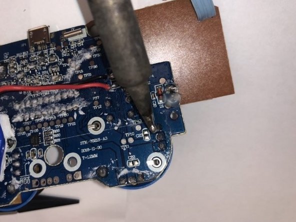

  8. Beboncool Gamepad for Nintendo Switch Joystick Replacement: crwdns2935265:08crwdnd2935265:01crwdnd2935265:01crwdne2935265:0
    • Bend each of the retaining tabs located in the the corners of each joystick actuator straight so that they can be removed.
    • If only one of your joysticks is showing issues, just address the pins corresponding to the problematic joystick.

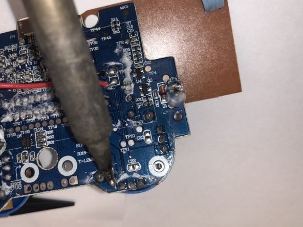

  9. Beboncool Gamepad for Nintendo Switch Joystick Replacement: crwdns2935265:09crwdnd2935265:01crwdnd2935265:03crwdne2935265:0 Beboncool Gamepad for Nintendo Switch Joystick Replacement: crwdns2935265:09crwdnd2935265:02crwdnd2935265:03crwdne2935265:0 Beboncool Gamepad for Nintendo Switch Joystick Replacement: crwdns2935265:09crwdnd2935265:03crwdnd2935265:03crwdne2935265:0
    • Desolder the 12 soldering points connecting the problematic actuator(s) to the motherboard.
    • Remove the actuator from the board.
