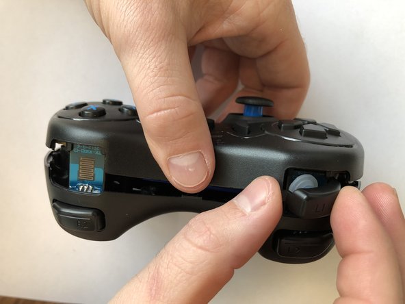

    • Use the plastic opening tool to remove the blue plastic grips from the sides of the controller.

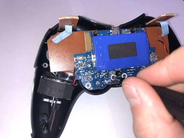

    • Use the Phillips #0 screwdriver to remove the seven 5mm screws from the back of the controller.

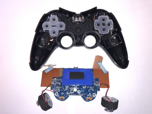

    • Gently separate the two halves of the controller.
    • As the two covers come apart the L1 and R1 button, will fall free from the controller. Be sure not to lose them if they should pop out and fall.

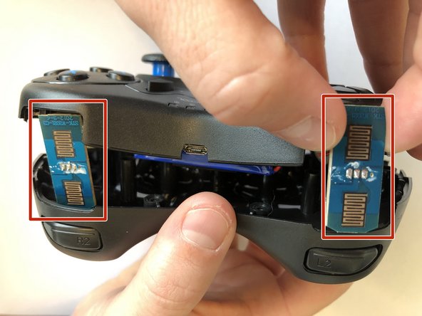

    • Be sure to slide the small circuit boards out of the covers to be able to separate the two halves

    • Use the Phillips #0 screwdriver to remove the two 3.5mm screws holding the circuit board in place.

    • Lift the motherboard from the back case with the vibration motors and button boards attached.

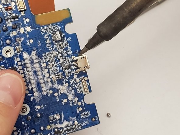

  7. Beboncool Gamepad for Nintendo Switch Charging Port Replacement: crwdns2935265:07crwdnd2935265:01crwdnd2935265:03crwdne2935265:0 Beboncool Gamepad for Nintendo Switch Charging Port Replacement: crwdns2935265:07crwdnd2935265:02crwdnd2935265:03crwdne2935265:0 Beboncool Gamepad for Nintendo Switch Charging Port Replacement: crwdns2935265:07crwdnd2935265:03crwdnd2935265:03crwdne2935265:0

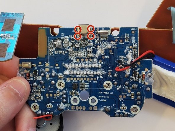

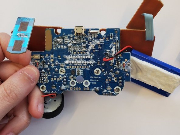

    • Remove the charging port from the edge of the motherboard by desoldering each of its four solder points and lifting the port from the board.
