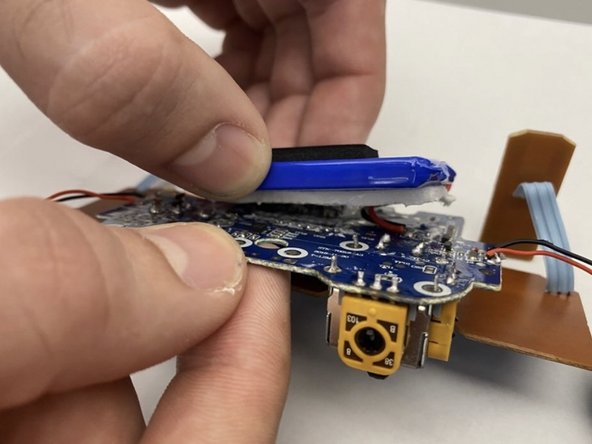

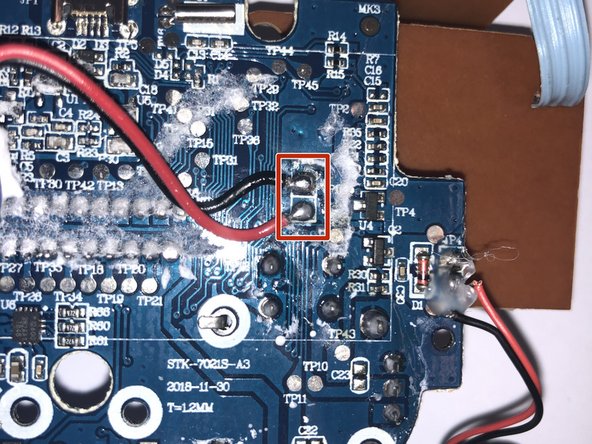

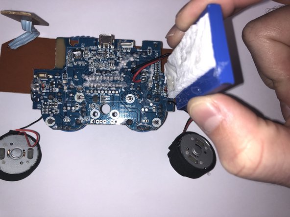

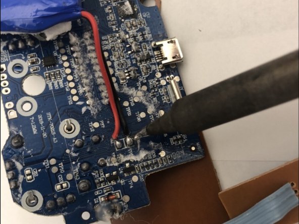

  6. Beboncool Gamepad for Nintendo Switch Battery Replacement, Battery: crwdns2935265:06crwdnd2935265:01crwdnd2935265:03crwdne2935265:0 Beboncool Gamepad for Nintendo Switch Battery Replacement, Battery: crwdns2935265:06crwdnd2935265:02crwdnd2935265:03crwdne2935265:0 Beboncool Gamepad for Nintendo Switch Battery Replacement, Battery: crwdns2935265:06crwdnd2935265:03crwdnd2935265:03crwdne2935265:0
    • Carefully separate the battery which is adhered to the circuit board.
