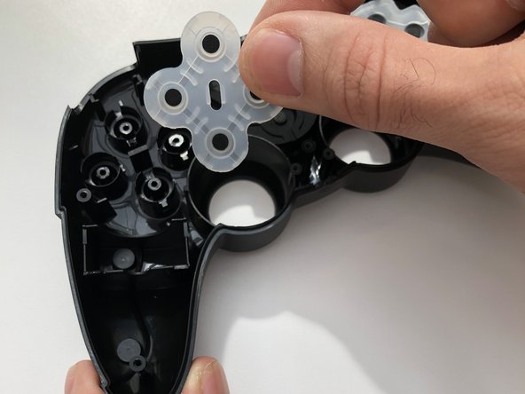

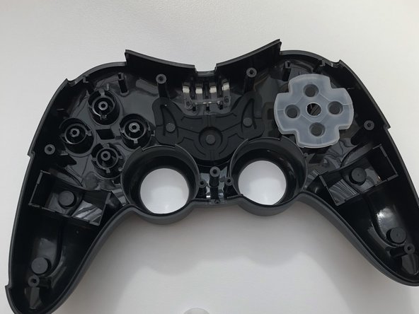

    • Remove the conductive rubber pad that covers the broken action button(s).

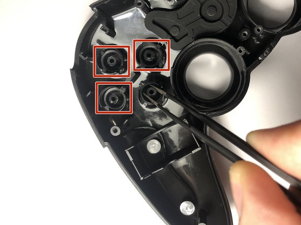

    • Remove the damaged button from the front cover with a pair of tweezers.
    • If removing more than one damaged button, it is important to replace them either one at a time or have the button layout saved as it will be essential to have the correctly labeled buttons put back into place for game play.

    • After both the rubber conductor pad and the button is removed, it is crucial that an inspection be done of both components to confirm the issue.
    • The rubber conductive pad should be inspected for rips, tears, or loss of the black conductive material in the 4 locations the buttons would press them to the circuit board

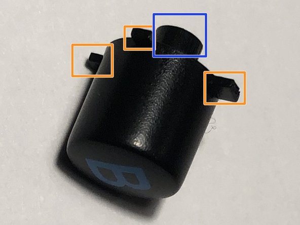

    • The troubled button should be removed and inspected for damage, It should be noted each button has 4 plastic splines that guide it into place in the controllers cover.
    • The button has a cylindrical piece in the center that presses against the rubber conductive pad.
    • After identifying and replacing the damaged component remember to confirm the button layout prior to reassembly.

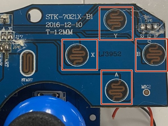

    • The final check is to inspect the components on the action button circuitry. The right side of the controller has the four circular components for the action buttons. Ensure the circuitry is not damaged.
