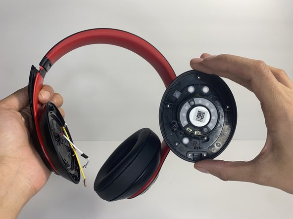

    • Find the separation between the headset and ear cushion.
    • Use an opening tool to go underneath the separation site and split the pieces apart.
  2. Beats Studio3 Wireless Left Driver Assembly Replacement: crwdns2935265:02crwdnd2935265:01crwdnd2935265:03crwdne2935265:0 Beats Studio3 Wireless Left Driver Assembly Replacement: crwdns2935265:02crwdnd2935265:02crwdnd2935265:03crwdne2935265:0 Beats Studio3 Wireless Left Driver Assembly Replacement: crwdns2935265:02crwdnd2935265:03crwdnd2935265:03crwdne2935265:0
    • You can also use your hands to remove it completely.
    • Pulling it off can be challenging; make sure to apply enough pressure.

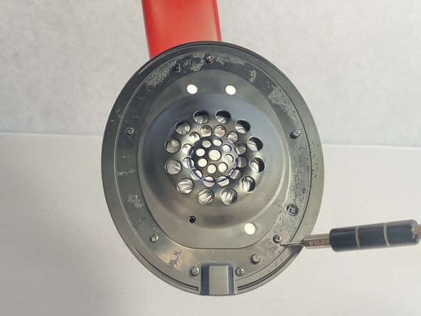

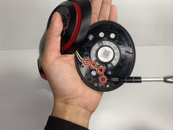

  3. Beats Studio3 Wireless Left Driver Assembly Replacement, Left Driver Assembly: crwdns2935265:03crwdnd2935265:01crwdnd2935265:02crwdne2935265:0 Beats Studio3 Wireless Left Driver Assembly Replacement, Left Driver Assembly: crwdns2935265:03crwdnd2935265:02crwdnd2935265:02crwdne2935265:0
    • Remove seven 3.6 mm screws holding the speaker assembly in place using a Phillips #0 screwdriver.
    • Make sure the screws aren't close to the speaker; due to it being a magnet, the screws could get stuck and damage the speaker.
    • Open the speaker by pulling the top layer of the speaker.

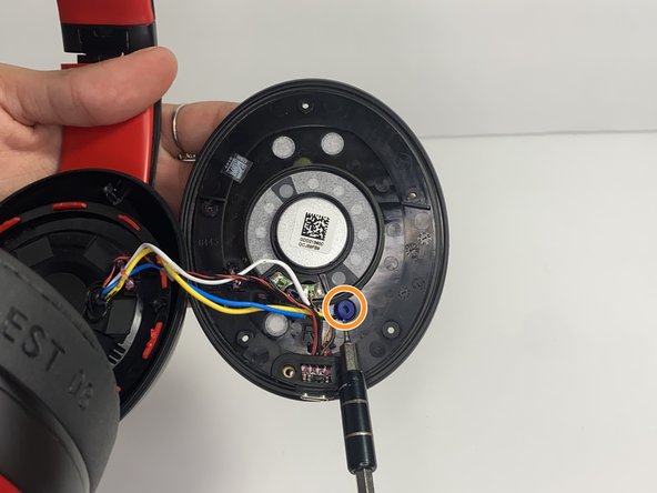

  4. Beats Studio3 Wireless Left Driver Assembly Replacement: crwdns2935265:04crwdnd2935265:01crwdnd2935265:03crwdne2935265:0 Beats Studio3 Wireless Left Driver Assembly Replacement: crwdns2935265:04crwdnd2935265:02crwdnd2935265:03crwdne2935265:0 Beats Studio3 Wireless Left Driver Assembly Replacement: crwdns2935265:04crwdnd2935265:03crwdnd2935265:03crwdne2935265:0
    • With a heat gun or hair dryer, heat the glue that is sticking the wires down until the glue softens.
    • Use a nylon spudger to remove the glue.
    • Pull on the wire to remove it while also removing the blue rubber band.
  5. Beats Studio3 Wireless Left Driver Assembly Replacement: crwdns2935265:05crwdnd2935265:01crwdnd2935265:03crwdne2935265:0 Beats Studio3 Wireless Left Driver Assembly Replacement: crwdns2935265:05crwdnd2935265:02crwdnd2935265:03crwdne2935265:0 Beats Studio3 Wireless Left Driver Assembly Replacement: crwdns2935265:05crwdnd2935265:03crwdnd2935265:03crwdne2935265:0
    • Using a soldering iron to remove the cables on the charger port.
    • For help with soldering, check out the How to Solder and Desolder Connections guide.
    • Remove the two wires connected in the middle of the speaker using a soldering iron.
    • Remove the speaker from the headset.
