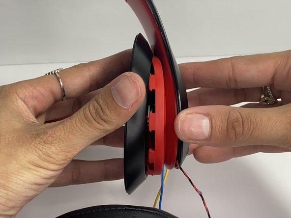

      • Find the separation between the headset and ear cushion.
      • Use an opening tool to go underneath the separation site and split the pieces apart.
    2. Beats Studio3 Wireless Hinge Replacement: crwdns2935265:02crwdnd2935265:01crwdnd2935265:03crwdne2935265:0 Beats Studio3 Wireless Hinge Replacement: crwdns2935265:02crwdnd2935265:02crwdnd2935265:03crwdne2935265:0 Beats Studio3 Wireless Hinge Replacement: crwdns2935265:02crwdnd2935265:03crwdnd2935265:03crwdne2935265:0
      • You can also use your hands to remove it completely.
      • Pulling it off can be challenging; make sure to apply enough pressure.

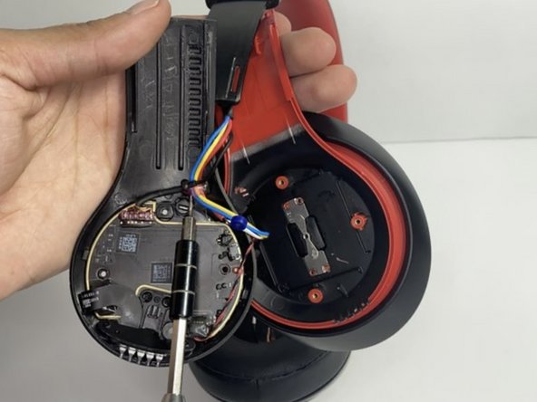

    1. Beats Studio3 Wireless Hinge Replacement, Left Driver Assembly: crwdns2935265:03crwdnd2935265:01crwdnd2935265:02crwdne2935265:0 Beats Studio3 Wireless Hinge Replacement, Left Driver Assembly: crwdns2935265:03crwdnd2935265:02crwdnd2935265:02crwdne2935265:0
      • Remove seven 3.6 mm screws holding the speaker assembly in place using a Phillips #0 screwdriver.
      • Make sure the screws aren't close to the speaker; due to it being a magnet, the screws could get stuck and damage the speaker.
      • Open the speaker by pulling the top layer of the speaker.

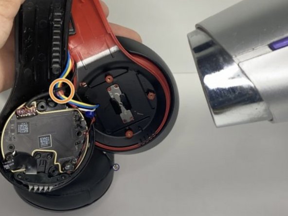

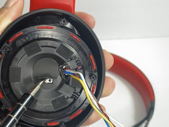

    2. Beats Studio3 Wireless Hinge Replacement: crwdns2935265:04crwdnd2935265:01crwdnd2935265:03crwdne2935265:0 Beats Studio3 Wireless Hinge Replacement: crwdns2935265:04crwdnd2935265:02crwdnd2935265:03crwdne2935265:0 Beats Studio3 Wireless Hinge Replacement: crwdns2935265:04crwdnd2935265:03crwdnd2935265:03crwdne2935265:0
      • With a heat gun or hair dryer, heat the glue that is sticking the wires down until the glue softens.
      • Use a nylon spudger to remove the glue.
      • Pull on the wire to remove it while also removing the blue rubber band.

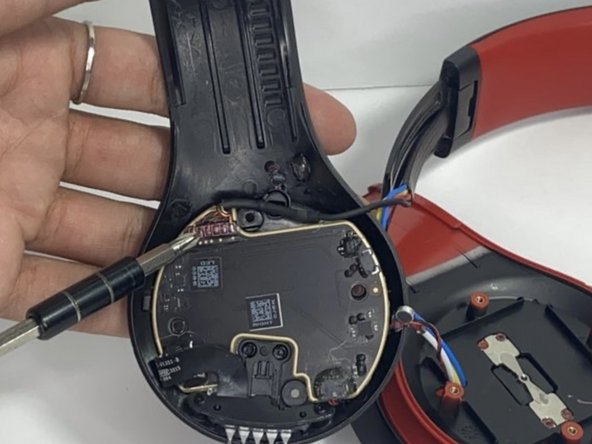

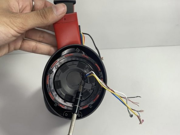

    3. Beats Studio3 Wireless Hinge Replacement: crwdns2935265:05crwdnd2935265:01crwdnd2935265:03crwdne2935265:0 Beats Studio3 Wireless Hinge Replacement: crwdns2935265:05crwdnd2935265:02crwdnd2935265:03crwdne2935265:0 Beats Studio3 Wireless Hinge Replacement: crwdns2935265:05crwdnd2935265:03crwdnd2935265:03crwdne2935265:0
      • Using a soldering iron to remove the cables on the charger port.
      • For help with soldering, check out the How to Solder and Desolder Connections guide.
      • Remove the two wires connected in the middle of the speaker using a soldering iron.
      • Remove the speaker from the headset.

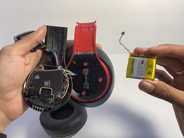

    1. Beats Studio3 Wireless Hinge Replacement, Battery: crwdns2935265:06crwdnd2935265:01crwdnd2935265:02crwdne2935265:0 Beats Studio3 Wireless Hinge Replacement, Battery: crwdns2935265:06crwdnd2935265:02crwdnd2935265:02crwdne2935265:0
      • Use a pointed nylon spudger to remove the center circular panel on the right side of your device.
      • Be gentle while removing this piece as it is glued on with adhesive.
    2. Beats Studio3 Wireless Hinge Replacement: crwdns2935265:07crwdnd2935265:01crwdnd2935265:02crwdne2935265:0 Beats Studio3 Wireless Hinge Replacement: crwdns2935265:07crwdnd2935265:02crwdnd2935265:02crwdne2935265:0
      • Remove the four 3.5 mm screws using a Phillips #0 screwdriver.
    3. Beats Studio3 Wireless Hinge Replacement: crwdns2935265:08crwdnd2935265:01crwdnd2935265:03crwdne2935265:0 Beats Studio3 Wireless Hinge Replacement: crwdns2935265:08crwdnd2935265:02crwdnd2935265:03crwdne2935265:0 Beats Studio3 Wireless Hinge Replacement: crwdns2935265:08crwdnd2935265:03crwdnd2935265:03crwdne2935265:0
      • Using a pointed nylon spudger, remove the tab located on the inner part of the headband labeled "R."
      • Place the nylon spudger in between the side panels and push inward going from bottom to top to separate both sides of the panel.
      • The panel will pop open after separating.
    4. Beats Studio3 Wireless Hinge Replacement: crwdns2935265:09crwdnd2935265:01crwdnd2935265:01crwdne2935265:0
      • Place the nylon spudger underneath the battery, push inward and separate the battery from the inside.
      • Never use sharp tools to pry batteries. Metal spudgers can puncture an unprotected battery, potentially causing a fire.
    5. Beats Studio3 Wireless Hinge Replacement: crwdns2935265:010crwdnd2935265:01crwdnd2935265:02crwdne2935265:0 Beats Studio3 Wireless Hinge Replacement: crwdns2935265:010crwdnd2935265:02crwdnd2935265:02crwdne2935265:0
      • Use a nylon spudger to lift up the glue sticking the wires down.
      • Use a nylon spudger to lift the connector to disconnect the battery.

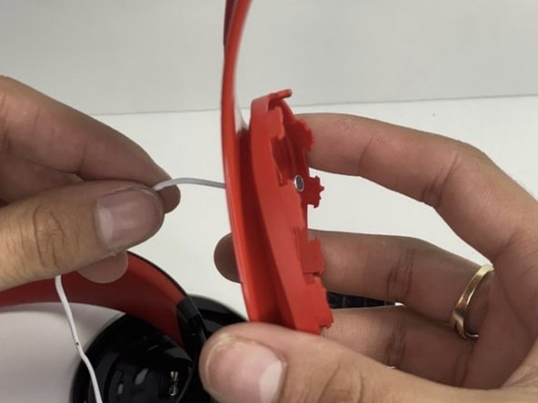

    1. Beats Studio3 Wireless Hinge Replacement, Hinge: crwdns2935265:011crwdnd2935265:01crwdnd2935265:03crwdne2935265:0 Beats Studio3 Wireless Hinge Replacement, Hinge: crwdns2935265:011crwdnd2935265:02crwdnd2935265:03crwdne2935265:0 Beats Studio3 Wireless Hinge Replacement, Hinge: crwdns2935265:011crwdnd2935265:03crwdnd2935265:03crwdne2935265:0
      • Pull the wire making sure that the blue rubber band is off.
      • Heat the glue holding the wires down with a hair dryer or heat gun until the glue softens.
      • Make sure not to overheat any device part, which could cause damage to the sound.
      • With a pointed nylon spudger, remove the glue.
    2. Beats Studio3 Wireless Hinge Replacement: crwdns2935265:012crwdnd2935265:01crwdnd2935265:02crwdne2935265:0 Beats Studio3 Wireless Hinge Replacement: crwdns2935265:012crwdnd2935265:02crwdnd2935265:02crwdne2935265:0

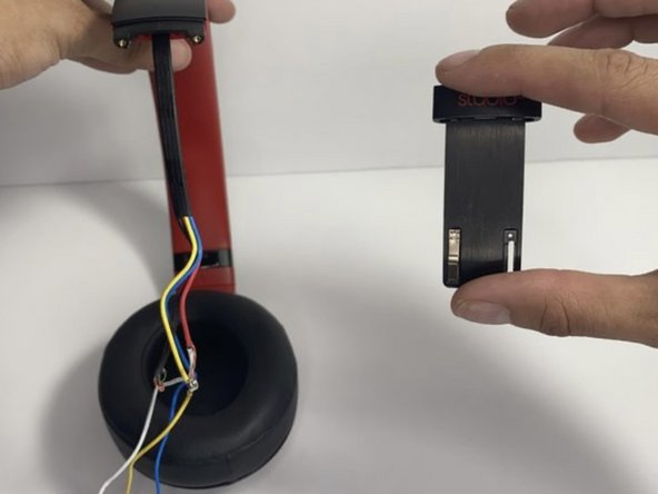

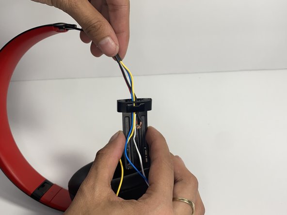

    7. Beats Studio3 Wireless Hinge Replacement: crwdns2935265:017crwdnd2935265:01crwdnd2935265:03crwdne2935265:0 Beats Studio3 Wireless Hinge Replacement: crwdns2935265:017crwdnd2935265:02crwdnd2935265:03crwdne2935265:0 Beats Studio3 Wireless Hinge Replacement: crwdns2935265:017crwdnd2935265:03crwdnd2935265:03crwdne2935265:0
      • Pull the hinge down.
      • Pull on the wires one at a time making sure you don't damage them.
    8. Beats Studio3 Wireless Hinge Replacement: crwdns2935265:018crwdnd2935265:01crwdnd2935265:02crwdne2935265:0 Beats Studio3 Wireless Hinge Replacement: crwdns2935265:018crwdnd2935265:02crwdnd2935265:02crwdne2935265:0

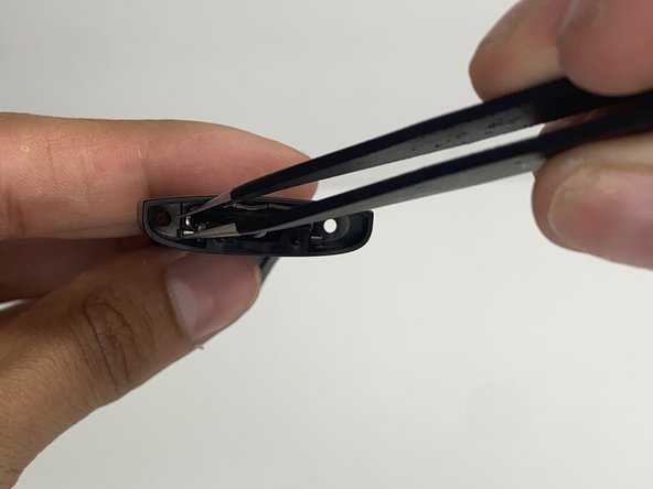

      • With tweezers, remove the pin located inside of the hinge.
