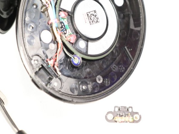

  3. Beats Studio3 Micro USB-B Replacement: crwdns2935265:03crwdnd2935265:01crwdnd2935265:03crwdne2935265:0 Beats Studio3 Micro USB-B Replacement: crwdns2935265:03crwdnd2935265:02crwdnd2935265:03crwdne2935265:0 Beats Studio3 Micro USB-B Replacement: crwdns2935265:03crwdnd2935265:03crwdnd2935265:03crwdne2935265:0
    • Use the soldering iron to carefully desolder five different wires from their respective points.
    • After disconnecting the wires, gently push the charger upward using your fingers to detach it from the base. Be careful to avoid damaging any components
    • Position the new charger by aligning it properly with the base. Push the new charger into place, ensuring it fits snugly and securely.
    • Reattach the five wires to their designated points on the new charger by soldering them securely. Ensure each wire is correctly connected to its corresponding point to guarantee proper functionality.
