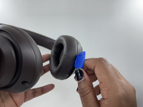

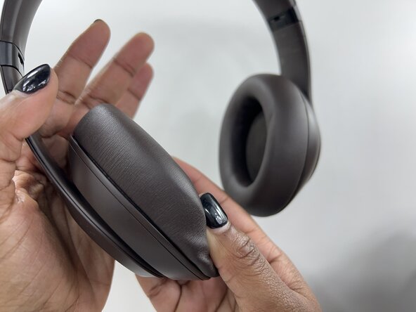

    • Grip the edge of the left or right earpad firmly.
    • Insert an opening pick under the earpad and work your way around the edge to pry it off.
    • Repeat for the second earpad.
    • If the earpads are old and sticky, they may come off in pieces. Take your time to remove them cleanly.

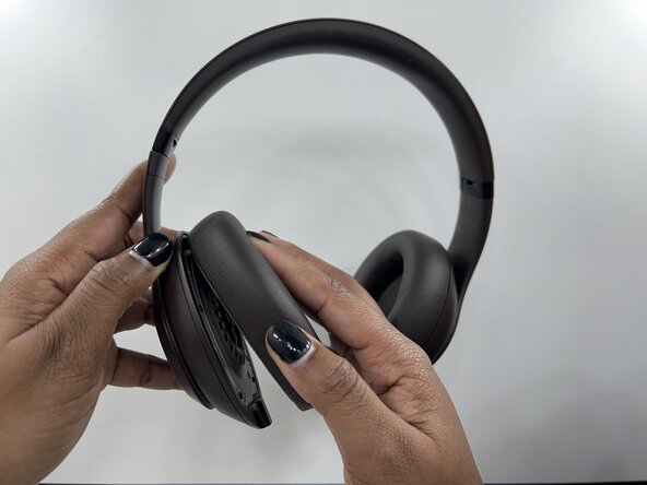

  2. Beats Studio Pro Earpad Replacement: crwdns2935265:02crwdnd2935265:01crwdnd2935265:01crwdne2935265:0
    • Slowly and carefully remove the old earpad.
    • Apply consistent, even pressure until the earpad starts to come out because the adhesive will resist at first.

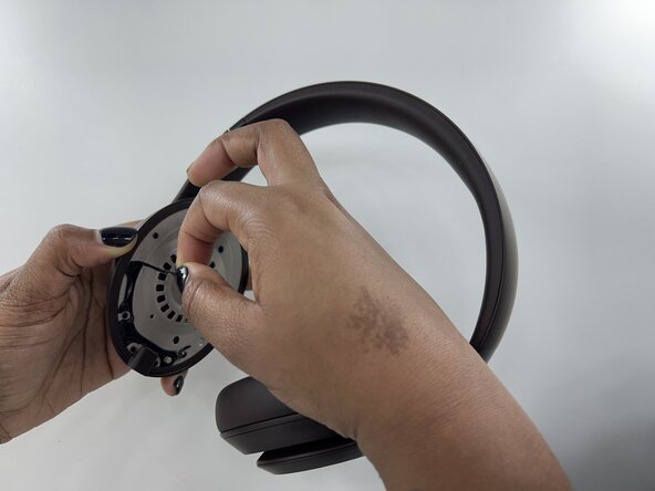

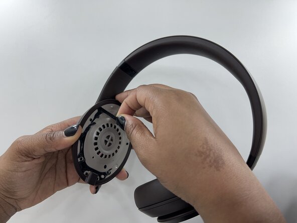

  3. Beats Studio Pro Earpad Replacement: crwdns2935265:03crwdnd2935265:01crwdnd2935265:03crwdne2935265:0 Beats Studio Pro Earpad Replacement: crwdns2935265:03crwdnd2935265:02crwdnd2935265:03crwdne2935265:0 Beats Studio Pro Earpad Replacement: crwdns2935265:03crwdnd2935265:03crwdnd2935265:03crwdne2935265:0
    • Check for leftover adhesive on the speaker housing. Any residue left behind can make it difficult for the new earpads to attach properly.
    • Gently peel off excess adhesive or use adhesive remover to ensure cleanliness.

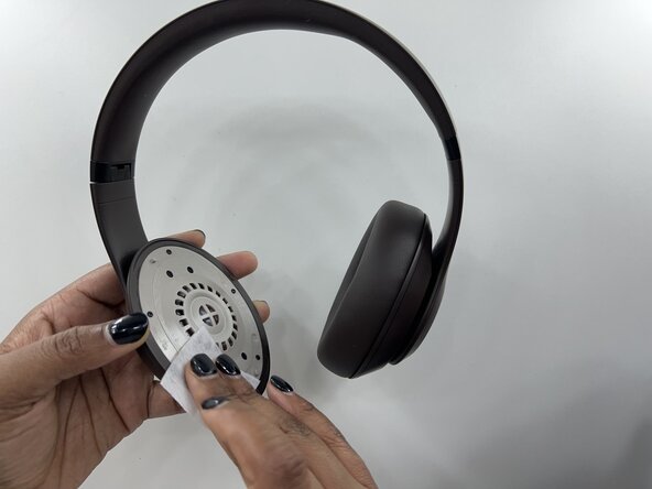

  4. Beats Studio Pro Earpad Replacement: crwdns2935265:04crwdnd2935265:01crwdnd2935265:03crwdne2935265:0 Beats Studio Pro Earpad Replacement: crwdns2935265:04crwdnd2935265:02crwdnd2935265:03crwdne2935265:0 Beats Studio Pro Earpad Replacement: crwdns2935265:04crwdnd2935265:03crwdnd2935265:03crwdne2935265:0
    • Use an alcohol or cleaning wipe to remove the residue left from the adhesive that you peeled off.
    • Make sure the surface is clean and dry before proceeding.
    • A firm attachment for the new earpads is ensured by a cleaned surface.

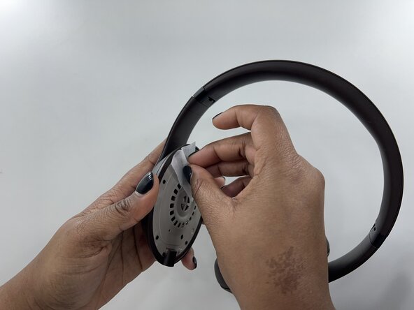

  5. Beats Studio Pro Earpad Replacement: crwdns2935265:05crwdnd2935265:01crwdnd2935265:03crwdne2935265:0 Beats Studio Pro Earpad Replacement: crwdns2935265:05crwdnd2935265:02crwdnd2935265:03crwdne2935265:0 Beats Studio Pro Earpad Replacement: crwdns2935265:05crwdnd2935265:03crwdnd2935265:03crwdne2935265:0
    • Check if the new earpads have pre-applied adhesive.
    • If they do, peel off the protective backing to expose the sticky side.
    • If not, apply double-sided adhesive tape to the back of the earpads.
    • Identify the left and right earpads and align the new earpad with the ear cup.
    • Press firmly onto the headphone, and hold for 30 seconds. This allows the adhesive to bond properly.
    • Repeat for the second earpad and ensure both sides are attached correctly.
