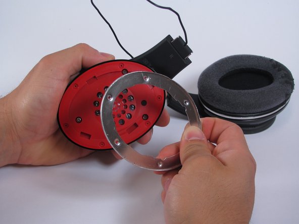

  9. Beats Studio First Generation Speaker Replacement, Speaker: crwdns2935265:09crwdnd2935265:01crwdnd2935265:02crwdne2935265:0 Beats Studio First Generation Speaker Replacement, Speaker: crwdns2935265:09crwdnd2935265:02crwdnd2935265:02crwdne2935265:0
    • Use a 00 Phillips head screwdriver to remove the 3.9 mm Phillips screws holding the metal ring in place. There should be 7 in each earpiece.
    • Make sure the screws you've already removed don't fall into the speaker itself (the circular arrangement of holes on the red piece directly below the metal ring). The speaker itself is magnetic, so getting screws out can be tricky. You should have tweezers available in case a screw or other piece of metal does fall into the speaker.
    • Once all the screws are removed, the metal ring can be removed by hand.

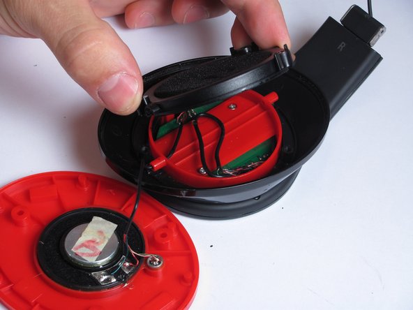

  11. Beats Studio First Generation Speaker Replacement: crwdns2935265:011crwdnd2935265:01crwdnd2935265:01crwdne2935265:0
    • Flipping the speaker assembly over reveals the speaker wire connections to the speaker itself.
    • Check that the wire is intact and not frayed anywhere.
    • If necessary, the wires can be de-soldered to disconnect and replace the speaker assembly.
  12. Beats Studio First Generation Speaker Replacement: crwdns2935265:012crwdnd2935265:01crwdnd2935265:02crwdne2935265:0 Beats Studio First Generation Speaker Replacement: crwdns2935265:012crwdnd2935265:02crwdnd2935265:02crwdne2935265:0
    • If the black part directly beneath the speaker assembly is broken and needs to be replaced, it can be easily removed by hand.
    • If replacing the speaker on the side of the headphones with the power button (as shown in photos), upon reassembly, make sure the foam is inserted as shown in the first picture. If it is forgotten or improperly seated, the speaker could make undesirable vibrations.
