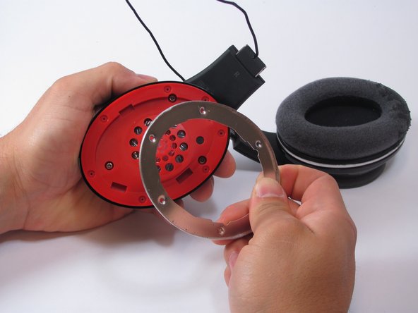

    1. Beats Studio First Generation Motherboard Replacement, Removing Metal Ring Earpiece: crwdns2935265:09crwdnd2935265:01crwdnd2935265:02crwdne2935265:0 Beats Studio First Generation Motherboard Replacement, Removing Metal Ring Earpiece: crwdns2935265:09crwdnd2935265:02crwdnd2935265:02crwdne2935265:0
      • Make sure you are working on the speaker that has the label "R" for the right ear. This speaker is the one you must disassemble in order to access the motherboard.
      • Use a 00 Phillips head screwdriver to remove the screws holding down the metal ring.
      • 7 Phillips type 00, 3.9mm long screws.
      • Set aside the metal ring.

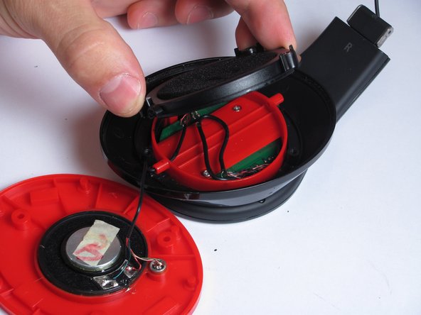

    2. Beats Studio First Generation Motherboard Replacement, Removing the Drive (Speaker): crwdns2935265:010crwdnd2935265:01crwdnd2935265:01crwdne2935265:0
      • Using the 0 Phillips head screwdriver, remove the 3 screws holding down the red speaker assembly.
      • 3 Phillips type 0, 8.0mm long screws.
    3. Beats Studio First Generation Motherboard Replacement, Remove Plastic Cover With Foam Top: crwdns2935265:011crwdnd2935265:01crwdnd2935265:02crwdne2935265:0 Beats Studio First Generation Motherboard Replacement, Remove Plastic Cover With Foam Top: crwdns2935265:011crwdnd2935265:02crwdnd2935265:02crwdne2935265:0
      • The screws removed in the previous step held the cover in place so, go ahead and just lift it out!
      • Easy as 1-2-3!

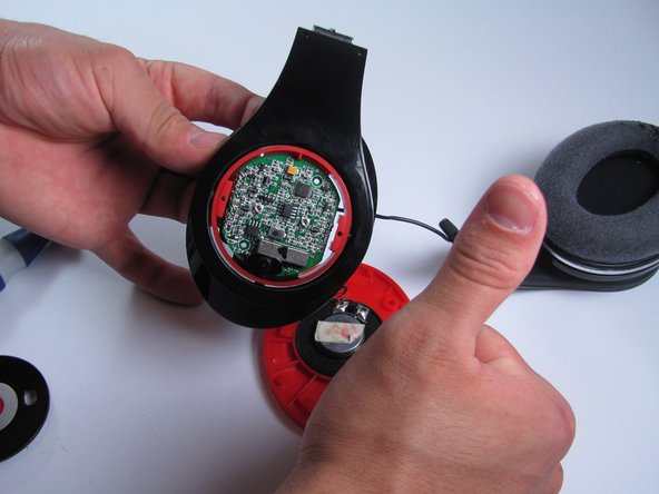

    4. Beats Studio First Generation Motherboard Replacement, Removing Motherboard and Cover: crwdns2935265:012crwdnd2935265:01crwdnd2935265:02crwdne2935265:0 Beats Studio First Generation Motherboard Replacement, Removing Motherboard and Cover: crwdns2935265:012crwdnd2935265:02crwdnd2935265:02crwdne2935265:0
      • Use the 0 Philips screwdriver to remove the two 6.0 mm screws screws that hold the motherboard and cover.
      • Place one hand on the other side ( where the beats logo is) so, that when you take the two screws out, the cover and motherboard don't fall out.
      • 2 Philips type 0, 6.0mm long screws.
    5. Beats Studio First Generation Motherboard Replacement, Remove Motherboard Cover: crwdns2935265:013crwdnd2935265:01crwdnd2935265:02crwdne2935265:0 Beats Studio First Generation Motherboard Replacement, Remove Motherboard Cover: crwdns2935265:013crwdnd2935265:02crwdnd2935265:02crwdne2935265:0
      • Once the screws have been removed from the other side, turn the speaker housing around.
      • Simply lift the cover with the beats logo off.
      • Congratulations! You have uncovered the motherboard!!

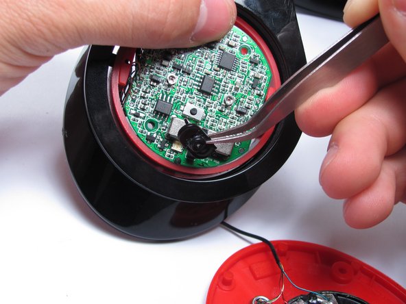

    6. Beats Studio First Generation Motherboard Replacement, Remove Power Button Cover: crwdns2935265:014crwdnd2935265:01crwdnd2935265:02crwdne2935265:0 Beats Studio First Generation Motherboard Replacement, Remove Power Button Cover: crwdns2935265:014crwdnd2935265:02crwdnd2935265:02crwdne2935265:0
      • Locate the black power button switch, then gently remove it with a pair of tweezers.
      • The mute button
      • Power switch.

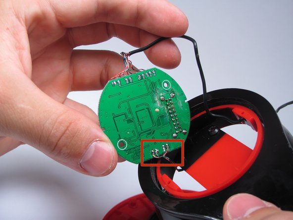

    7. Beats Studio First Generation Motherboard Replacement, Remove Motherboard From Housing: crwdns2935265:015crwdnd2935265:01crwdnd2935265:01crwdne2935265:0
      • Sometimes the motherboard will just fall out of its housing. If it doesn't, use a plastic opening tool to gently pry or push out.
    8. Beats Studio First Generation Motherboard Replacement, The Motherboard has Landed!: crwdns2935265:016crwdnd2935265:01crwdnd2935265:02crwdne2935265:0 Beats Studio First Generation Motherboard Replacement, The Motherboard has Landed!: crwdns2935265:016crwdnd2935265:02crwdnd2935265:02crwdne2935265:0
      • Congratulations, you now have access to the motherboard!
      • The wires can now be de-soldered and the old motherboard can be replaced with a new one.
      • Before you begin soldering, make sure to mark or label all of the wires so that you remember exactly where they go.
