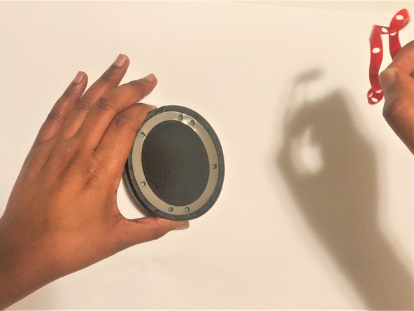

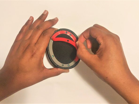

  4. Beats Studio 3 Ear Cushion Replacement: crwdns2935265:04crwdnd2935265:01crwdnd2935265:03crwdne2935265:0 Beats Studio 3 Ear Cushion Replacement: crwdns2935265:04crwdnd2935265:02crwdnd2935265:03crwdne2935265:0 Beats Studio 3 Ear Cushion Replacement: crwdns2935265:04crwdnd2935265:03crwdnd2935265:03crwdne2935265:0
    • Remove the sticker on the new pair of cushions to reveal the adhesive by pulling on the red tab to the side.
    • Do not touch the adhesive ring or lay it on a surface facing downwards. This could cause the adhesive to obtain fingerprints or, collect dust which could make it less effective at attaching to your headphones.
