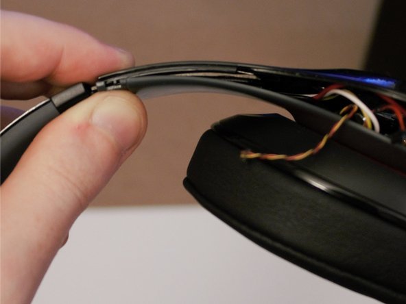

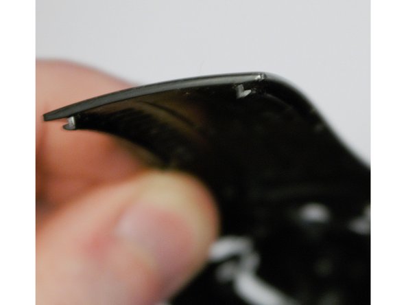

  3. Beats Studio 2.0 Exploratory Teardown, Method for separating outer plastic pieces: crwdns2935265:03crwdnd2935265:01crwdnd2935265:03crwdne2935265:0 Beats Studio 2.0 Exploratory Teardown, Method for separating outer plastic pieces: crwdns2935265:03crwdnd2935265:02crwdnd2935265:03crwdne2935265:0 Beats Studio 2.0 Exploratory Teardown, Method for separating outer plastic pieces: crwdns2935265:03crwdnd2935265:03crwdnd2935265:03crwdne2935265:0
    • By putting a thin spudger between the two halves of the plastic container, it is fairly easy to separate the two halves. But the top likely won't come apart without a fight. There are two primary pieces to keep in mind:
    • The small clips that show "L and "R" should probably be removed before the two pieces are separated. They are clipped into the outer shell and adhered with a similar adhesive to the outer rings that were previously removed. The trick: spread one side outwards as you are prying the broad section away from the rest of the shell.
    • Now to the main issue: there are deep "tracks" that clip the two halves together. I haven't been able to use a technique to make this easier, as you cannot "slide" the two halves apart. Just like the L/R clips, concentrate on stretching the inner (grey) part as much as possible. Force will be necessary; leave a comment if a better way is found.
    • You may be able to separate these pieces once or twice, but they do bend slightly and eventually the rails will deform, making reassembly impossible without modification.

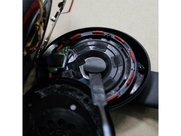

  4. Beats Studio 2.0 Exploratory Teardown, Charger-side earcup contents: crwdns2935265:04crwdnd2935265:01crwdnd2935265:03crwdne2935265:0 Beats Studio 2.0 Exploratory Teardown, Charger-side earcup contents: crwdns2935265:04crwdnd2935265:02crwdnd2935265:03crwdne2935265:0 Beats Studio 2.0 Exploratory Teardown, Charger-side earcup contents: crwdns2935265:04crwdnd2935265:03crwdnd2935265:03crwdne2935265:0
    • Sadly, the earcup's contents weren't as plentiful as I had hoped. Housed inside are the lithium battery, noise-cancelling microphone, LED control circuit, and power/charging circuit.
    • In my case, I initially believed the battery could be the issue. I took a multimeter to the positive and negative connections and read the voltage just above 4v (it's a 3.7v battery), which means that it is holding a full charge. Quite unfortunate for my diagnosis.
    • After completing a visual inspection the circuit board for any signs of component failure (discoloration, burn marks, melted exteriors, etc.), it was time to look to the other earcup for answers.

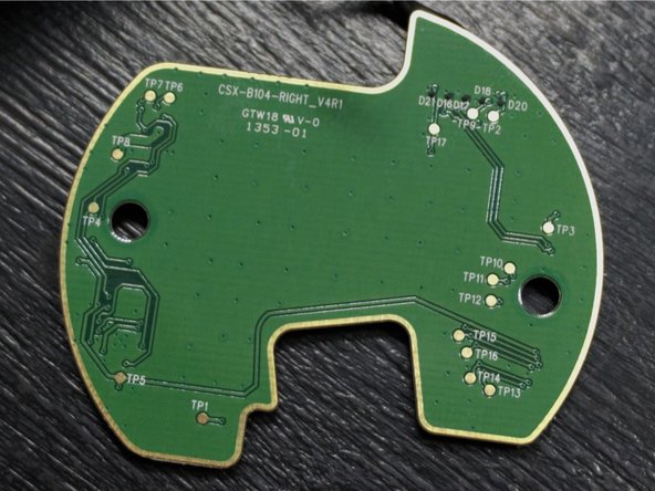

  7. Beats Studio 2.0 Exploratory Teardown, Jack-side contents: crwdns2935265:07crwdnd2935265:01crwdnd2935265:02crwdne2935265:0 Beats Studio 2.0 Exploratory Teardown, Jack-side contents: crwdns2935265:07crwdnd2935265:02crwdnd2935265:02crwdne2935265:0
    • After drilling was performed, I noticed that the headphone would no longer turn on. Upon further inspection, one of the drill holes had penetrated leads in the circuit board.
    • Due to its physical damage, I was unable to perform a good diagnosis on the cause of the headphone issue. While not being an electronics engineer, my best guesses are either a processing chip or a capacitor malfunction (due to initially working but fading out, and functioning for longer periods if they haven't recently had a hard reset)
    • The physical damage prevented me from being as motivated to check for signs of component failure, especially knowing that this pair of headphones was likely irreparable at this point.
    • The second picture shows the reverse side of this circuit board

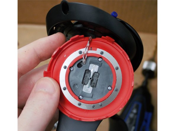

  10. Beats Studio 2.0 Exploratory Teardown, The real challenge: crwdns2935265:010crwdnd2935265:01crwdnd2935265:02crwdne2935265:0 Beats Studio 2.0 Exploratory Teardown, The real challenge: crwdns2935265:010crwdnd2935265:02crwdnd2935265:02crwdne2935265:0
    • After removing the middle screw, I was now at a loss of which direction to go next. The earpiece was still firmly connected to the mysterious red chamber, and I didn't see a logical next step except to simply pull the two sections apart.
    • The slots in the speaker enclosure allowed the rubber to hold on to the speaker enclosure. I began forcing them out of their place to hopefully allow access to the other side.
    • With all rubber nubs removed, I could finally see inside the rubber area - Finally! The 4 screws holding the frame pieces together could be taken off!
    • HOWEVER, I noticed that attempting to reconnect the red rubber piece to the earpiece enclosure was virtually impossible. There may be some technique to improve chances (potentially with fishing wire or tape), but it might be more trouble than it is worth (and I don't say that if I don't have to).
