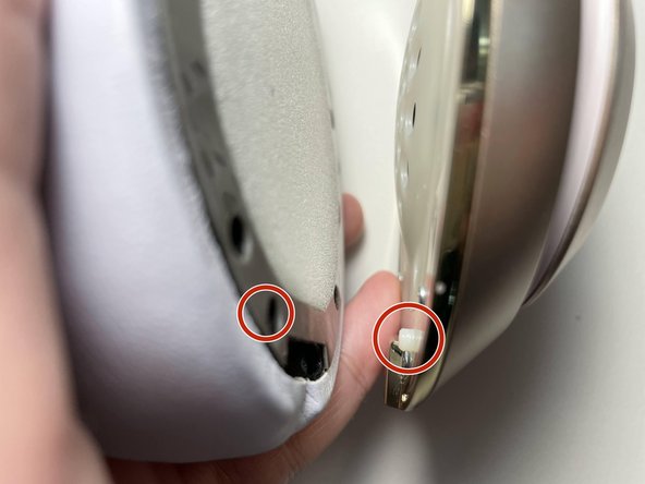

    • Insert a spudger between the plastic part of the headphone and the ear cushion.
    • Using a sharp tool to pry may result in injury or further damage to the device. Instead, use a blunt prying tool such as a nylon spudger.
  2. Beats Studio 2 Wireless Ear Cushions Replacement: crwdns2935265:02crwdnd2935265:01crwdnd2935265:03crwdne2935265:0 Beats Studio 2 Wireless Ear Cushions Replacement: crwdns2935265:02crwdnd2935265:02crwdnd2935265:03crwdne2935265:0 Beats Studio 2 Wireless Ear Cushions Replacement: crwdns2935265:02crwdnd2935265:03crwdnd2935265:03crwdne2935265:0

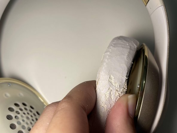

    • Insert the spudger from different angles until the cushion is removed.
    • Pull the rest of the cushion away from the adhesive with your hands.

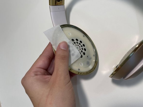

  4. Beats Studio 2 Wireless Ear Cushions Replacement: crwdns2935265:04crwdnd2935265:01crwdnd2935265:03crwdne2935265:0 Beats Studio 2 Wireless Ear Cushions Replacement: crwdns2935265:04crwdnd2935265:02crwdnd2935265:03crwdne2935265:0 Beats Studio 2 Wireless Ear Cushions Replacement: crwdns2935265:04crwdnd2935265:03crwdnd2935265:03crwdne2935265:0
    • Remove any excess adhesive and clean the surface with alcohol wipes.
    • Wait for the surface to completely dry before proceeding.

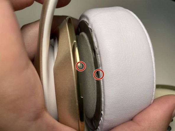

    • Align one cushion to the dowels on one side of the headphones, working from top to bottom.
    • Apply pressure to the cushion and dowel once attached.

    • Align the new cushion to the dowels on the other side of the headphones, working from top to bottom.
  9. Beats Studio 2 Wireless Ear Cushions Replacement: crwdns2935265:09crwdnd2935265:01crwdnd2935265:03crwdne2935265:0 Beats Studio 2 Wireless Ear Cushions Replacement: crwdns2935265:09crwdnd2935265:02crwdnd2935265:03crwdne2935265:0 Beats Studio 2 Wireless Ear Cushions Replacement: crwdns2935265:09crwdnd2935265:03crwdnd2935265:03crwdne2935265:0
    • Leave the headphones pressured to a shoe box overnight, for a more secure adhesive.
