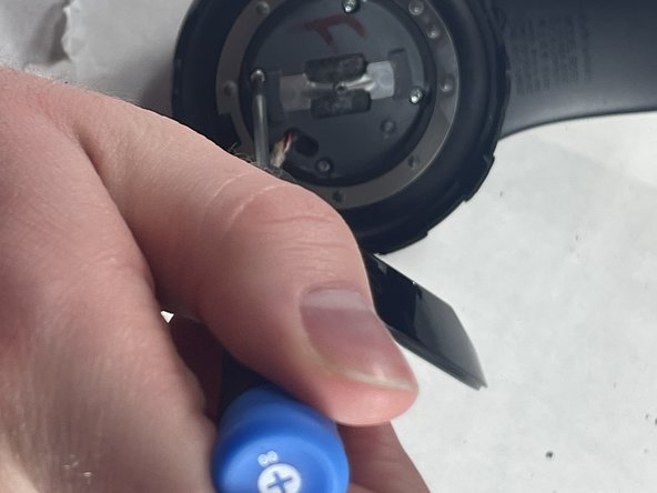

  8. Beats Studio 2 Wireless Bluetooth Board Replacement: crwdns2935265:08crwdnd2935265:01crwdnd2935265:01crwdne2935265:0
    • Remove the center screw using a Phillips #00 screwdriver.

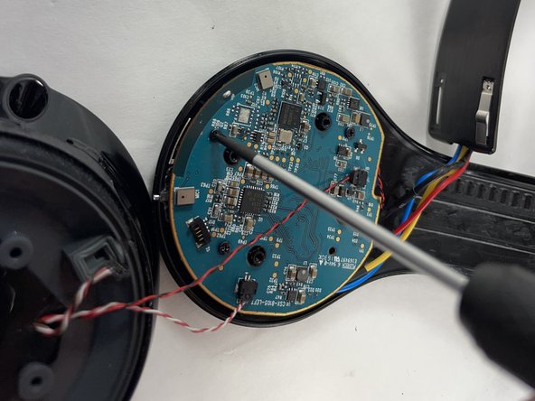

  13. Beats Studio 2 Wireless Bluetooth Board Replacement: crwdns2935265:013crwdnd2935265:01crwdnd2935265:02crwdne2935265:0 Beats Studio 2 Wireless Bluetooth Board Replacement: crwdns2935265:013crwdnd2935265:02crwdnd2935265:02crwdne2935265:0
    • Remove the four screws from the Bluetooth board with the Phillips #00 screwdriver.
    • This will free the Bluetooth board from the back case.

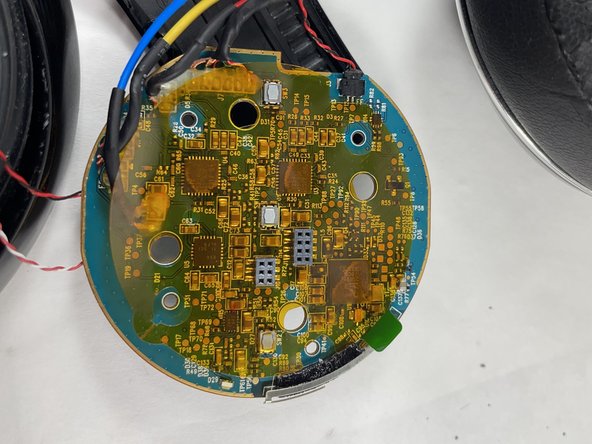

  14. Beats Studio 2 Wireless Bluetooth Board Replacement: crwdns2935265:014crwdnd2935265:01crwdnd2935265:02crwdne2935265:0 Beats Studio 2 Wireless Bluetooth Board Replacement: crwdns2935265:014crwdnd2935265:02crwdnd2935265:02crwdne2935265:0
    • Remove the Bluetooth board from the case.
    • Remove the translucent sticker from the back of the Bluetooth board.
