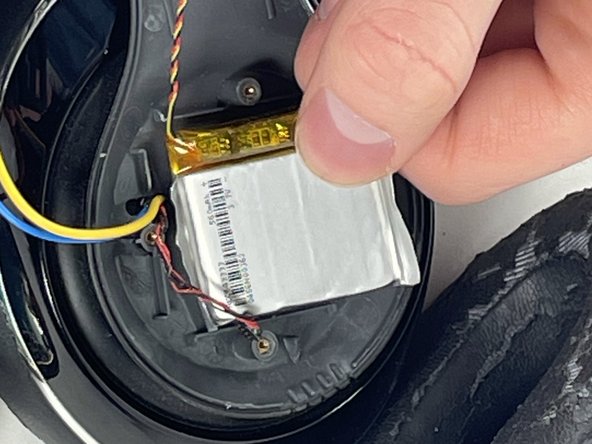

    • Use the pointed tip of a spudger to carefully push on each side of the connector to release it from the socket on the motherboard.
    • Be gentle with the connectors as they can break easily.
    • Don't use a metal spudger to remove a battery or any internal component. This is potentially dangerous as it could puncture the battery and cause a fire or worse.
    • Use a nylon spudger to remove the battery from the headphones.
