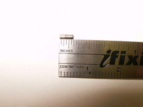

    • Remove the T4 Torx screws located above the right speaker.
  2. Beats Solo HD Right Hinge Pin Repair: crwdns2935265:02crwdnd2935265:01crwdnd2935265:03crwdne2935265:0 Beats Solo HD Right Hinge Pin Repair: crwdns2935265:02crwdnd2935265:02crwdnd2935265:03crwdne2935265:0 Beats Solo HD Right Hinge Pin Repair: crwdns2935265:02crwdnd2935265:03crwdnd2935265:03crwdne2935265:0
    • Lift away the shield covering the screw holes.
    • Pry off the shield directly below it.
  3. Beats Solo HD Right Hinge Pin Repair: crwdns2935265:03crwdnd2935265:01crwdnd2935265:03crwdne2935265:0 Beats Solo HD Right Hinge Pin Repair: crwdns2935265:03crwdnd2935265:02crwdnd2935265:03crwdne2935265:0 Beats Solo HD Right Hinge Pin Repair: crwdns2935265:03crwdnd2935265:03crwdnd2935265:03crwdne2935265:0
    • Lift away the plastic shield and remove the pin.
