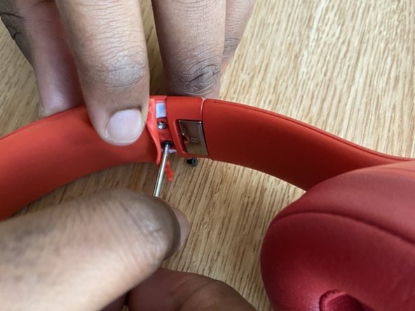

    • Carefully partially remove the headband cushion cover. Be careful not to rip the two headband eyelets just above the screws on each end of the headband.
  2. Beats Solo 3 Headband Replacement: crwdns2935265:02crwdnd2935265:01crwdnd2935265:02crwdne2935265:0 Beats Solo 3 Headband Replacement: crwdns2935265:02crwdnd2935265:02crwdnd2935265:02crwdne2935265:0
    • With the main part of the cover off, pull the head band cover up and out of the metal headband ends, exposing the screws underneath.
  3. Beats Solo 3 Headband Replacement: crwdns2935265:03crwdnd2935265:01crwdnd2935265:03crwdne2935265:0 Beats Solo 3 Headband Replacement: crwdns2935265:03crwdnd2935265:02crwdnd2935265:03crwdne2935265:0 Beats Solo 3 Headband Replacement: crwdns2935265:03crwdnd2935265:03crwdnd2935265:03crwdne2935265:0
    • Unscrew all four 1.4 mm screws on the right and left ends on the underside of the headband using a T5 Torx screwdriver.
  4. Beats Solo 3 Headband Replacement: crwdns2935265:04crwdnd2935265:01crwdnd2935265:01crwdne2935265:0
    • Pull the metal headband end out from the headband slightly, and disconnect the rubber band from the hook.
  5. Beats Solo 3 Headband Replacement: crwdns2935265:05crwdnd2935265:01crwdnd2935265:02crwdne2935265:0 Beats Solo 3 Headband Replacement: crwdns2935265:05crwdnd2935265:02crwdnd2935265:02crwdne2935265:0
    • Remove the inner headband by gently prying the edges and corners.
  6. Beats Solo 3 Headband Replacement: crwdns2935265:06crwdnd2935265:01crwdnd2935265:01crwdne2935265:0
    • Carefully peel up the glued wire in the headband.
  7. Beats Solo 3 Headband Replacement: crwdns2935265:07crwdnd2935265:01crwdnd2935265:01crwdne2935265:0
    • Pull the headband out of the slots gently.
  8. Beats Solo 3 Headband Replacement: crwdns2935265:08crwdnd2935265:01crwdnd2935265:01crwdne2935265:0
    • Put the new headband into the slots carefully.
