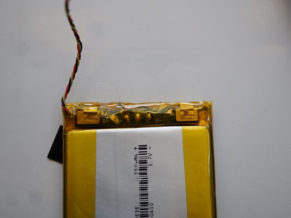

    • You can take the battery out by using a plastic card such as a credit card

    • The Solo 2 wireless uses a lot of TI parts. That means that you can find replacement IC's
    • The battery can be easily replaced, and it's not soldered in.
