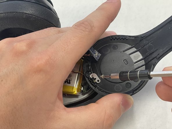

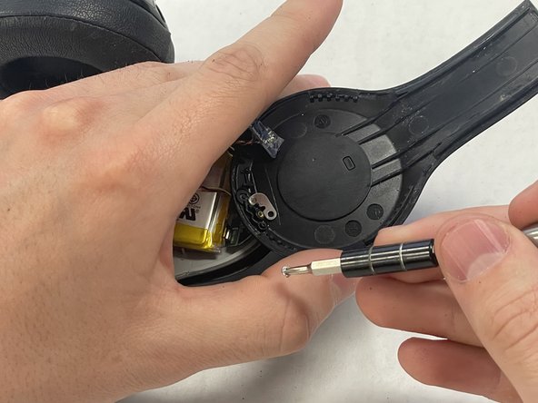

  3. Beats Solo 2 Wireless Power Button Replacement: crwdns2935265:03crwdnd2935265:01crwdnd2935265:03crwdne2935265:0 Beats Solo 2 Wireless Power Button Replacement: crwdns2935265:03crwdnd2935265:02crwdnd2935265:03crwdne2935265:0 Beats Solo 2 Wireless Power Button Replacement: crwdns2935265:03crwdnd2935265:03crwdnd2935265:03crwdne2935265:0
    • Use a Phillips screwdriver to remove the 2.8 mm screw on the outer shell of the headphones.
  4. Beats Solo 2 Wireless Power Button Replacement: crwdns2935265:04crwdnd2935265:01crwdnd2935265:01crwdne2935265:0
    • Remove the power button with your hand or a spudger by prying out the end that is still attached.
    • Beware of the sponge piece when putting the power button assembly back together.
