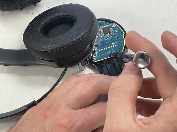

    • Insert an opening pick in the seam between the left outer speaker casing and the speaker housing.
    • Slide the pick around the perimeter of the casing until the outer casing releases entirely from the speaker housing.
    • Failure to loosen the seams may result in the piece breaking partially or completely when removing.

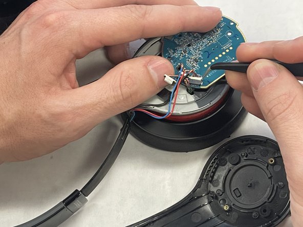

    • Use tweezers to remove the tape from the motherboard.
    • Loosen the wires from the casing with tweezers.
    • The wires attached to the shell are pinched together in a piece of plastic that will be difficult to remove
  4. Beats Solo 2 Wireless Motherboard Replacement: crwdns2935265:04crwdnd2935265:01crwdnd2935265:02crwdne2935265:0 Beats Solo 2 Wireless Motherboard Replacement: crwdns2935265:04crwdnd2935265:02crwdnd2935265:02crwdne2935265:0
    • Use a Phillips screwdriver to remove all four of the 4.25 mm screw that secure the motherboard.
  5. Beats Solo 2 Wireless Motherboard Replacement: crwdns2935265:05crwdnd2935265:01crwdnd2935265:02crwdne2935265:0 Beats Solo 2 Wireless Motherboard Replacement: crwdns2935265:05crwdnd2935265:02crwdnd2935265:02crwdne2935265:0
    • Disconnect all of the motherboard connectors.
    • Do not pull on the wires.
  6. Beats Solo 2 Wireless Motherboard Replacement: crwdns2935265:06crwdnd2935265:01crwdnd2935265:01crwdne2935265:0
    • Lift the motherboard up and out of the housing.
