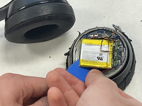

  4. Beats Solo 2 Wireless Battery Replacement: crwdns2935265:04crwdnd2935265:01crwdnd2935265:03crwdne2935265:0 Beats Solo 2 Wireless Battery Replacement: crwdns2935265:04crwdnd2935265:02crwdnd2935265:03crwdne2935265:0 Beats Solo 2 Wireless Battery Replacement: crwdns2935265:04crwdnd2935265:03crwdnd2935265:03crwdne2935265:0
    • Use an opening pick to gently pry up the battery.
    • The battery is secured in the housing with adhesive. You can apply some high-concentration alcohol beneath the battery to help loosen the adhesive.
    • Avoid bending or puncturing the battery.

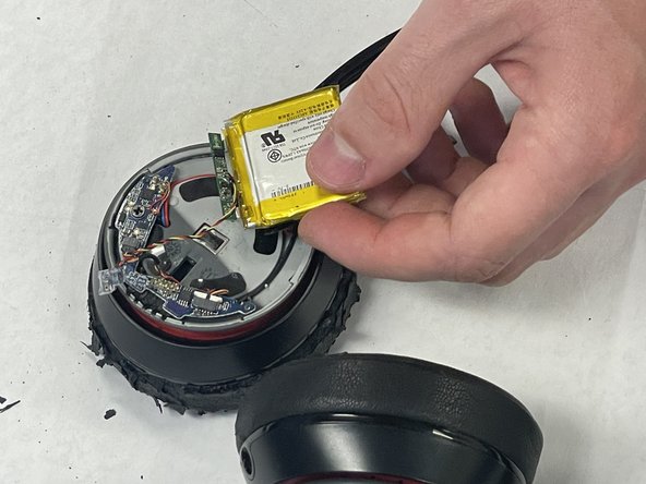

  5. Beats Solo 2 Wireless Battery Replacement: crwdns2935265:05crwdnd2935265:01crwdnd2935265:01crwdne2935265:0
    • Lift the battery up and out of the chassis.
