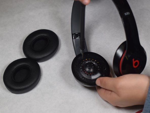

  2. Beats Solo 2 Wire Replacement: crwdns2935265:02crwdnd2935265:01crwdnd2935265:02crwdne2935265:0 Beats Solo 2 Wire Replacement: crwdns2935265:02crwdnd2935265:02crwdnd2935265:02crwdne2935265:0
    • Remove the ear cushions from the headset. The preferred method to do this is to use a screwdriver and pry the cushions off.
  3. Beats Solo 2 Wire Replacement: crwdns2935265:03crwdnd2935265:01crwdnd2935265:03crwdne2935265:0 Beats Solo 2 Wire Replacement: crwdns2935265:03crwdnd2935265:02crwdnd2935265:03crwdne2935265:0 Beats Solo 2 Wire Replacement: crwdns2935265:03crwdnd2935265:03crwdnd2935265:03crwdne2935265:0
    • Remove the second cushion until both cushions are removed.

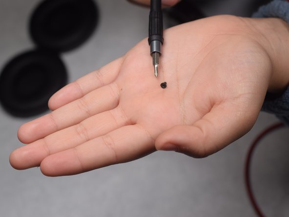

  4. Beats Solo 2 Wire Replacement: crwdns2935265:04crwdnd2935265:01crwdnd2935265:03crwdne2935265:0 Beats Solo 2 Wire Replacement: crwdns2935265:04crwdnd2935265:02crwdnd2935265:03crwdne2935265:0 Beats Solo 2 Wire Replacement: crwdns2935265:04crwdnd2935265:03crwdnd2935265:03crwdne2935265:0
    • Remove the screws from both ear bases.
