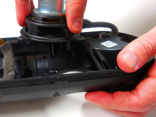

  9. Beats Pill XL Speaker Replacement: crwdns2935265:09crwdnd2935265:01crwdnd2935265:01crwdne2935265:0
    • Using a Phillips #2 screwdriver, remove the 4 (8mm maxi-loc Phillips #2) screws holding the speaker to the case.
  10. Beats Pill XL Speaker Replacement: crwdns2935265:010crwdnd2935265:01crwdnd2935265:02crwdne2935265:0 Beats Pill XL Speaker Replacement: crwdns2935265:010crwdnd2935265:02crwdnd2935265:02crwdne2935265:0
    • While holding the case with one hand, pull up on the speaker you wish to replace.
    • This guide showed how to replace one of the two larger speakers, but the two smaller speakers are replaced the same way.
