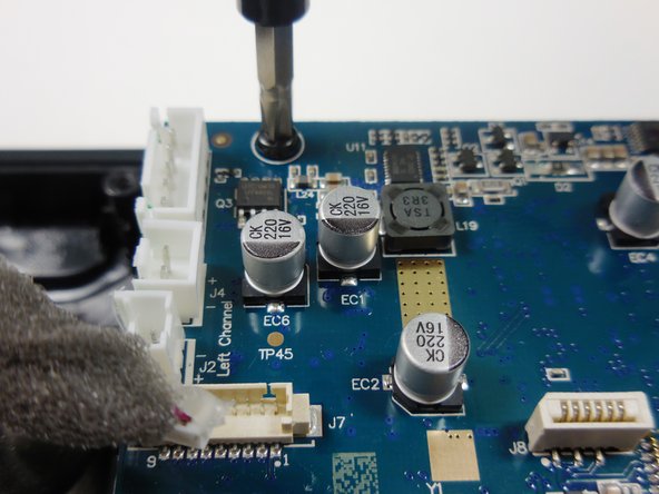

  11. Beats Pill XL Motherboard Replacement: crwdns2935265:011crwdnd2935265:01crwdnd2935265:02crwdne2935265:0 Beats Pill XL Motherboard Replacement: crwdns2935265:011crwdnd2935265:02crwdnd2935265:02crwdne2935265:0
    • Using a Phillips #2 screwdriver, unscrew the 4 (8mm pan head Phillips #2) screws holding the motherboard onto the case. They are located in the four corners of the board.
  12. Beats Pill XL Motherboard Replacement: crwdns2935265:012crwdnd2935265:01crwdnd2935265:02crwdne2935265:0 Beats Pill XL Motherboard Replacement: crwdns2935265:012crwdnd2935265:02crwdnd2935265:02crwdne2935265:0
    • Using both hands, gently lift the motherboard from the case.
    • You have successfully removed the motherboard.
