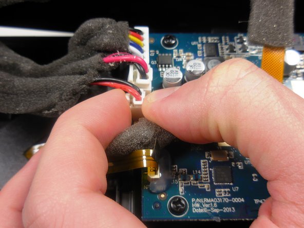

    • Remove the speaker cables by using gentle constant force with fingers.

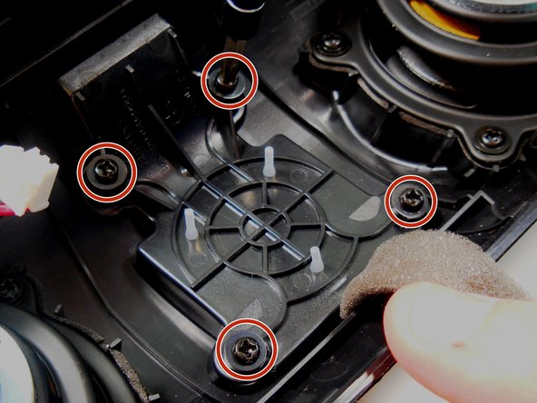

  9. Beats Pill XL 'b' Button Replacement: crwdns2935265:09crwdnd2935265:01crwdnd2935265:02crwdne2935265:0 Beats Pill XL 'b' Button Replacement: crwdns2935265:09crwdnd2935265:02crwdnd2935265:02crwdne2935265:0
    • Using a Phillips #2 screwdriver, remove the 4 (8mm pan head Phillips #2) screws using a Philips #02 screwdriver.
