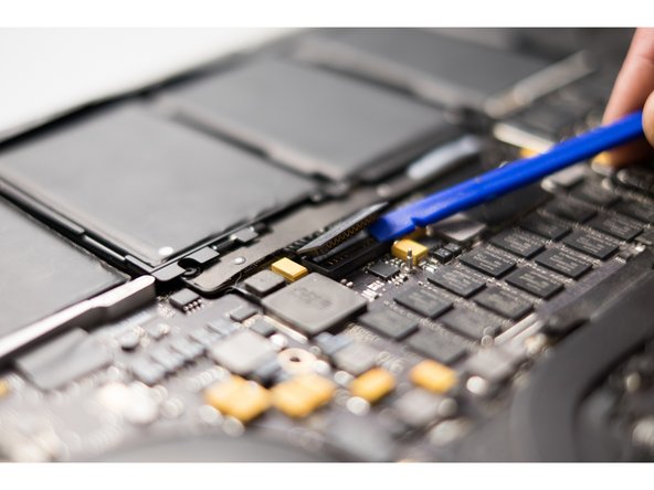

    • Peel back the warning label covering the battery connector.
  4. Battery and Trackpad. Disassembling MacBook Pro 15" Retina 2012-2015: crwdns2935265:04crwdnd2935265:01crwdnd2935265:03crwdne2935265:0 Battery and Trackpad. Disassembling MacBook Pro 15" Retina 2012-2015: crwdns2935265:04crwdnd2935265:02crwdnd2935265:03crwdne2935265:0 Battery and Trackpad. Disassembling MacBook Pro 15" Retina 2012-2015: crwdns2935265:04crwdnd2935265:03crwdnd2935265:03crwdne2935265:0
    • No metal tools!
    • Using the flat end of a spudger, gently pry the battery connector straight up out of its socket on the logic board.
    • Bend the battery cables back and out of the way, ensuring that the battery connector doesn't accidentally make contact with the logic board.

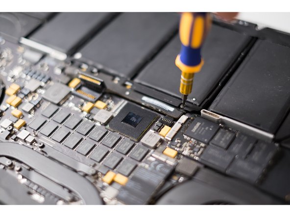

    • Remove the following T5 Torx battery screws.

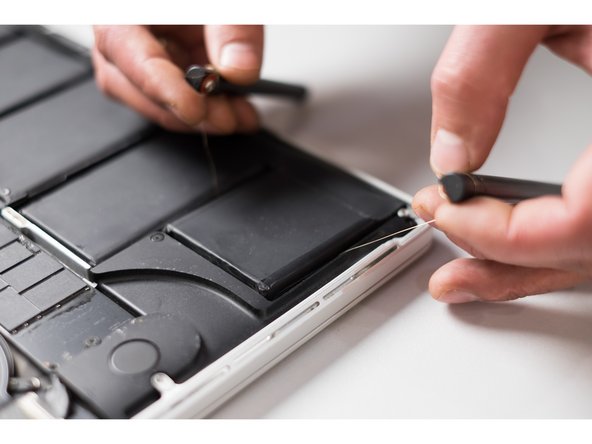

  6. Battery and Trackpad. Disassembling MacBook Pro 15" Retina 2012-2015: crwdns2935265:06crwdnd2935265:01crwdnd2935265:03crwdne2935265:0 Battery and Trackpad. Disassembling MacBook Pro 15" Retina 2012-2015: crwdns2935265:06crwdnd2935265:02crwdnd2935265:03crwdne2935265:0 Battery and Trackpad. Disassembling MacBook Pro 15" Retina 2012-2015: crwdns2935265:06crwdnd2935265:03crwdnd2935265:03crwdne2935265:0
    • There is risk to damage the battery! (Do not use ANY metal tools - puncturing the battery can cause fire and possibly leak battery gel!)
    • Please note: carefully cut the duct tape layer under the battery with thin wire string. Pull back and forth slowly. Do not pry up with any metal tools.

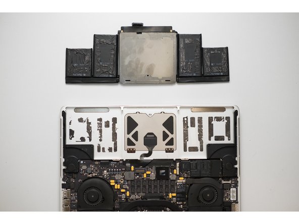

  8. Battery and Trackpad. Disassembling MacBook Pro 15" Retina 2012-2015: crwdns2935265:08crwdnd2935265:01crwdnd2935265:02crwdne2935265:0 Battery and Trackpad. Disassembling MacBook Pro 15" Retina 2012-2015: crwdns2935265:08crwdnd2935265:02crwdnd2935265:02crwdne2935265:0
    • Remove battery

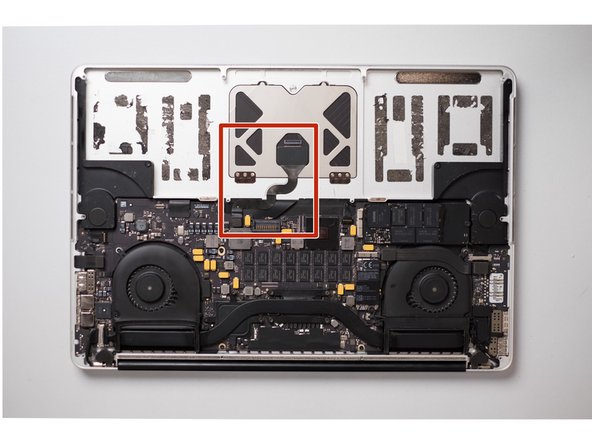

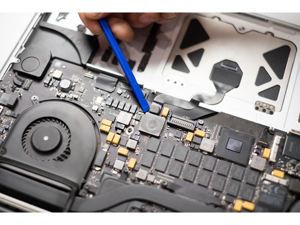

  9. Battery and Trackpad. Disassembling MacBook Pro 15" Retina 2012-2015: crwdns2935265:09crwdnd2935265:01crwdnd2935265:02crwdne2935265:0 Battery and Trackpad. Disassembling MacBook Pro 15" Retina 2012-2015: crwdns2935265:09crwdnd2935265:02crwdnd2935265:02crwdne2935265:0

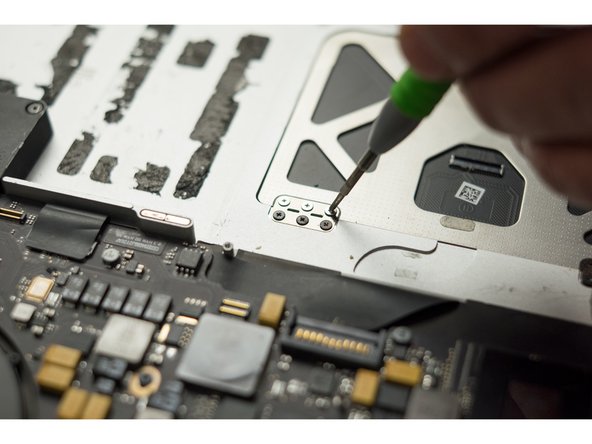

    • Using the flat end of a spudger, pry the trackpad connector.
  10. Battery and Trackpad. Disassembling MacBook Pro 15" Retina 2012-2015: crwdns2935265:010crwdnd2935265:01crwdnd2935265:03crwdne2935265:0 Battery and Trackpad. Disassembling MacBook Pro 15" Retina 2012-2015: crwdns2935265:010crwdnd2935265:02crwdnd2935265:03crwdne2935265:0 Battery and Trackpad. Disassembling MacBook Pro 15" Retina 2012-2015: crwdns2935265:010crwdnd2935265:03crwdnd2935265:03crwdne2935265:0

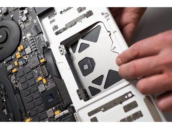

    • Unscrew the light-colored screws
    • Remove trackpad.
  11. Battery and Trackpad. Disassembling MacBook Pro 15" Retina 2012-2015: crwdns2935265:011crwdnd2935265:01crwdnd2935265:01crwdne2935265:0
    • Adjustment of trackpad touching level
