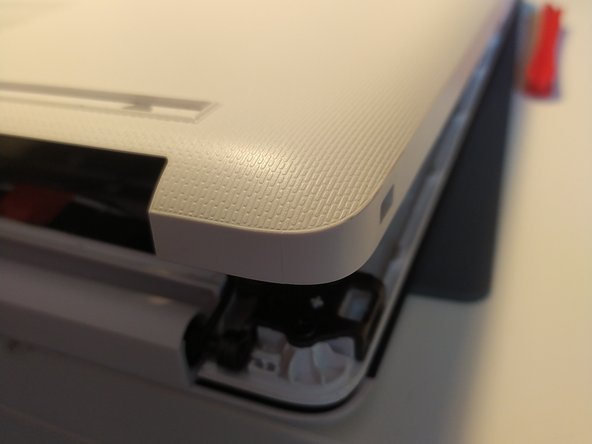

    3. Battery Replacement: crwdns2935265:03crwdnd2935265:01crwdnd2935265:02crwdne2935265:0 Battery Replacement: crwdns2935265:03crwdnd2935265:02crwdnd2935265:02crwdne2935265:0
      • Insert a spudger between the bottom cover and the keyboard module, then go around the whole cover to uncip everything.
      • Remove the bottom cover from the computer.
