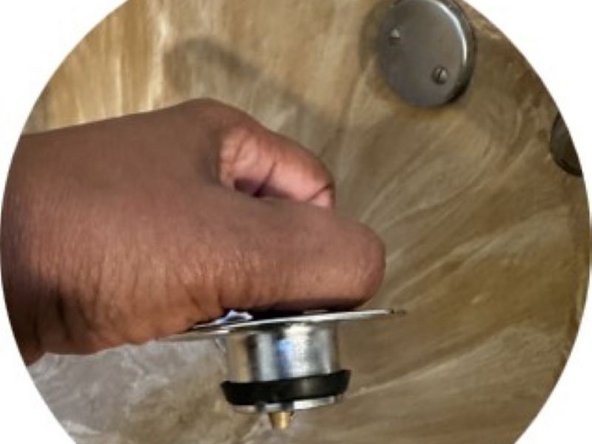

    • Remove the old stopper from the drain.
  3. Bathtub Drain Stopper Replacement: crwdns2935265:03crwdnd2935265:01crwdnd2935265:03crwdne2935265:0 Bathtub Drain Stopper Replacement: crwdns2935265:03crwdnd2935265:02crwdnd2935265:03crwdne2935265:0 Bathtub Drain Stopper Replacement: crwdns2935265:03crwdnd2935265:03crwdnd2935265:03crwdne2935265:0

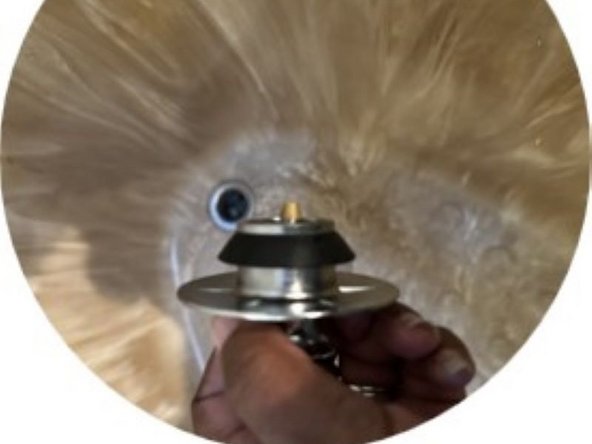

    • The gaskets come in two sizes, large and small. To determine which is the correct size, position the gasket into the groove of the stopper. The flange side should be in an upright position.
    • Insert the stopper with the gasket in the drain.
    • You may have to try both gaskets to ensure the best fit. If it is too loose, water may leak through.
