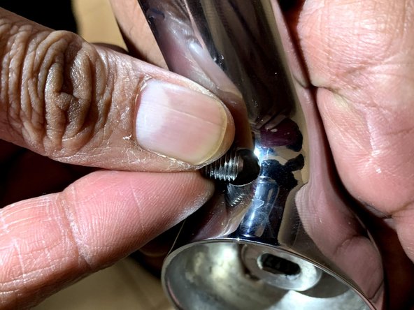

  2. Bath Tub Cartridge Replacement: crwdns2935265:02crwdnd2935265:01crwdnd2935265:02crwdne2935265:0 Bath Tub Cartridge Replacement: crwdns2935265:02crwdnd2935265:02crwdnd2935265:02crwdne2935265:0

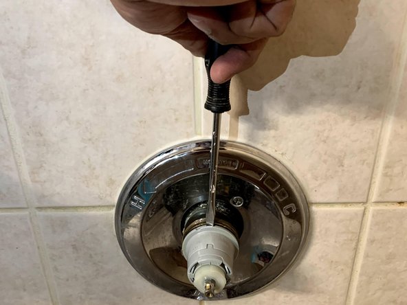

    • Loosen the faucet screw using an Allen key.
    • Every tub faucet is different, so yours may require a different size Allen key or screwdriver.

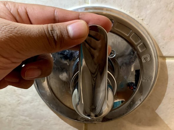

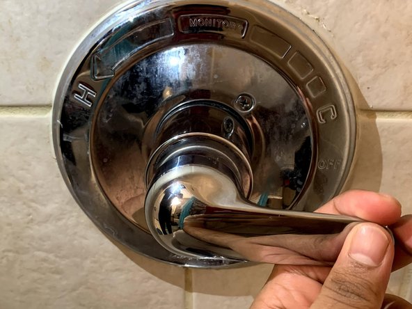

  3. Bath Tub Cartridge Replacement: crwdns2935265:03crwdnd2935265:01crwdnd2935265:01crwdne2935265:0
    • When the screw is loosened, slide the handle off.
    • To keep screws from falling down the drain, place a towel over the drain to catch the screws.

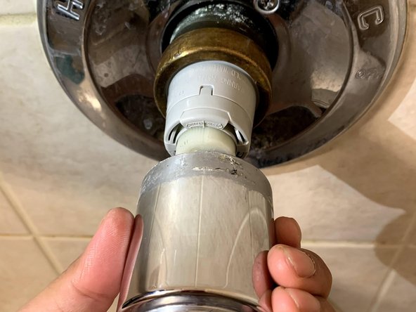

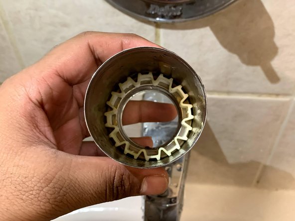

  4. Bath Tub Cartridge Replacement: crwdns2935265:04crwdnd2935265:01crwdnd2935265:03crwdne2935265:0 Bath Tub Cartridge Replacement: crwdns2935265:04crwdnd2935265:02crwdnd2935265:03crwdne2935265:0 Bath Tub Cartridge Replacement: crwdns2935265:04crwdnd2935265:03crwdnd2935265:03crwdne2935265:0
    • Remove the metal cap by sliding it off.
  5. Bath Tub Cartridge Replacement: crwdns2935265:05crwdnd2935265:01crwdnd2935265:03crwdne2935265:0 Bath Tub Cartridge Replacement: crwdns2935265:05crwdnd2935265:02crwdnd2935265:03crwdne2935265:0 Bath Tub Cartridge Replacement: crwdns2935265:05crwdnd2935265:03crwdnd2935265:03crwdne2935265:0

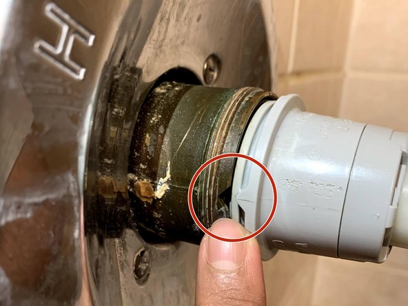

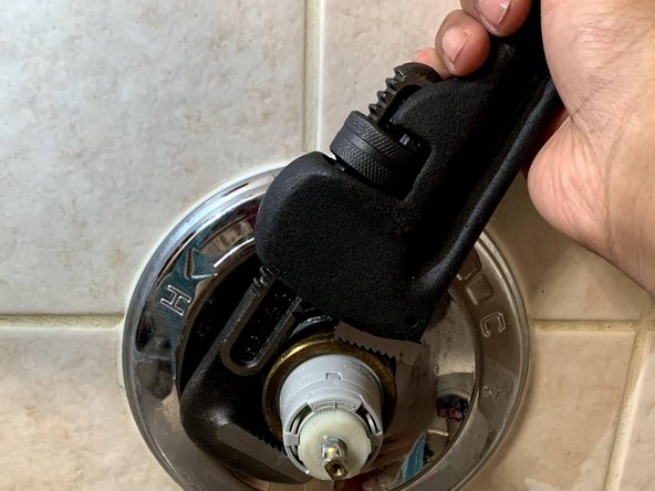

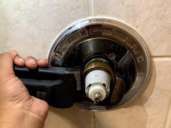

    • Use your hands to turn the ring to the left to loosen it. If the ring is not turning then use a wrench.
    • Do not use force when using the wrench as this will damage the pile.

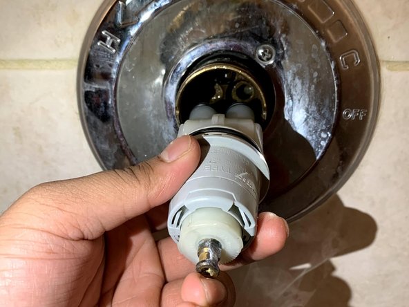

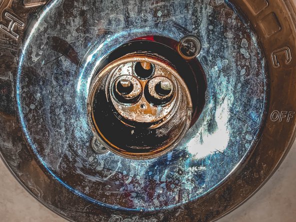

  6. Bath Tub Cartridge Replacement: crwdns2935265:06crwdnd2935265:01crwdnd2935265:03crwdne2935265:0 Bath Tub Cartridge Replacement: crwdns2935265:06crwdnd2935265:02crwdnd2935265:03crwdne2935265:0 Bath Tub Cartridge Replacement: crwdns2935265:06crwdnd2935265:03crwdnd2935265:03crwdne2935265:0

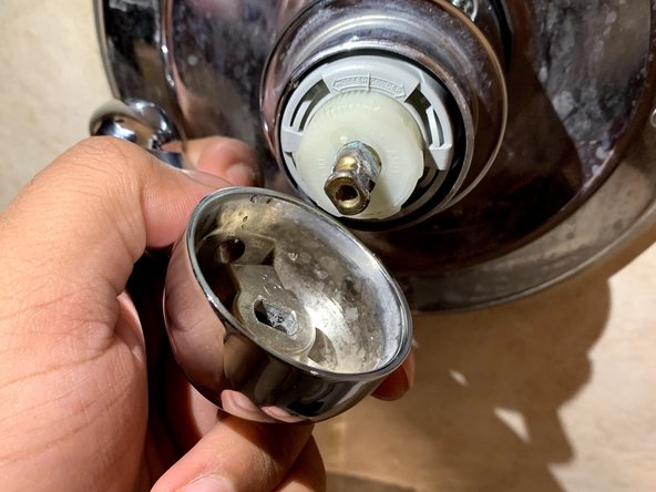

    • Use your hand to slide the cartridge out.
    • If the cartridge is stuck, you can use a spudger to remove it. There is a slight nook in between the pile and cartridge which can be used for leverage.
    • Not much force is needed to remove the cartridge.
    • Once the cartridge is removed, water remaining in the pile will flow out.

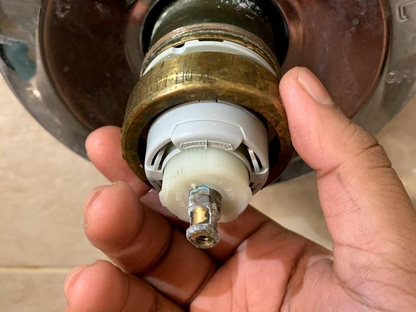

  7. Bath Tub Cartridge Replacement: crwdns2935265:07crwdnd2935265:01crwdnd2935265:03crwdne2935265:0 Bath Tub Cartridge Replacement: crwdns2935265:07crwdnd2935265:02crwdnd2935265:03crwdne2935265:0 Bath Tub Cartridge Replacement: crwdns2935265:07crwdnd2935265:03crwdnd2935265:03crwdne2935265:0
    • Line up the side of the new cartridge with the pile.

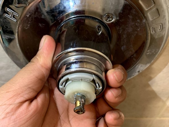

  8. Bath Tub Cartridge Replacement: crwdns2935265:08crwdnd2935265:01crwdnd2935265:02crwdne2935265:0 Bath Tub Cartridge Replacement: crwdns2935265:08crwdnd2935265:02crwdnd2935265:02crwdne2935265:0

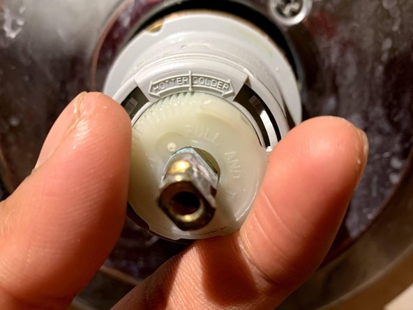

    • If the cartridge is successfully installed, it will be flush with the pile. For an extra measure you can push the cartridge inward, but do not use a lot of force.
    • The front end of the cartridge will be able to determine the temperature of your water. Pull the plastic toward yourself, and turn it to the right for cold water, and to the left for hot water. You can also keep the plastic in the middle, but the temperature of the water will be less accurate. This means it will either be too cold or too hot.
