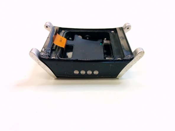

    • First, you begin by taking off the straps. . If you have taken out a watch strap before, it is a similar method
    • Flip the watch, use the plastic opening tool and slide into end of the strap, then push the spring contacts until the strap just breaks away from its catch
    • Independent electrodes to possibly modulate AC Signal onto your skin and measure at the receiving end. Possibly measuring impedance (thereby knowing how much you sweat)

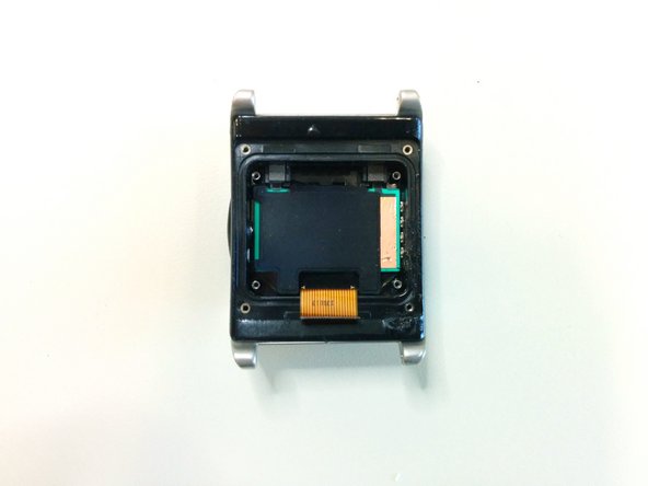

    • You see the gap in between here? That gap exist where the LCD sits beneath the MCU board.
    • Using a bit of highly precise de-soldering technique (left quite a few melted marks btw), you have to desolder the 4 contact points in order to separate the board from the LCD panel
    • P/S: Credit to my peer who helped me out. Fortunately it wasn't me. Else I would have left quite a larger mess :)

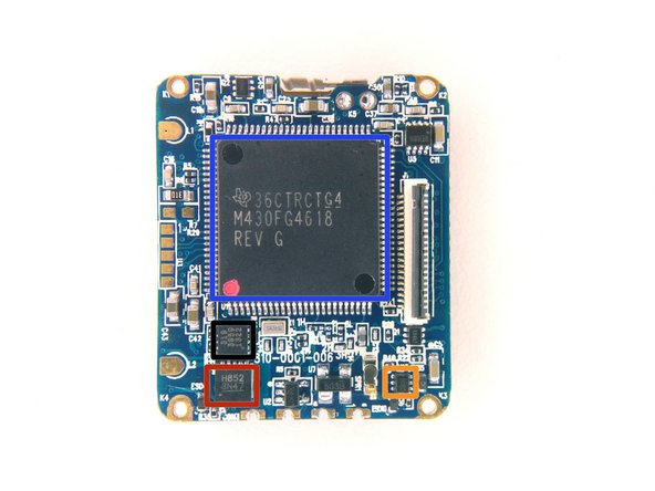

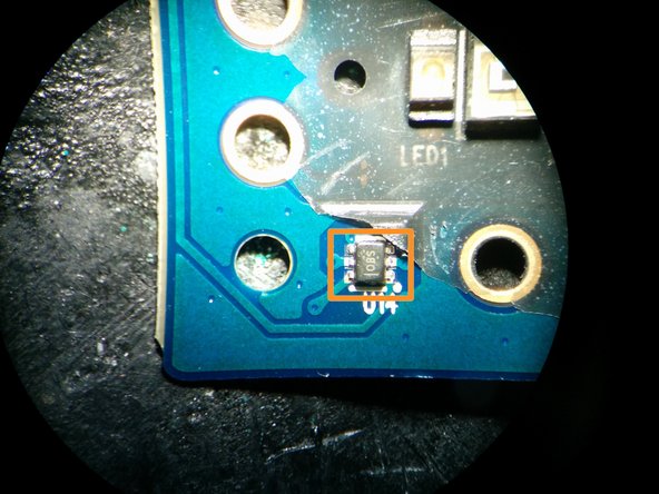

    • 1st Temperature Sensor (Texas Instruments) TMP112 marked as OBS. This might be one of the sensors that detects the ambient temperature as it is positioned away from the human body
    • Thanks to Luis Filipe Rossi for identifying the external SOT563 temperature sensors
    • 25P32V6G - ST 32MB NOR Serial Flash Memory
    • Analog Devices - ADXL335B, 3-Axis Accelerometer
    • Freescale MPR121 Proximity Capacitive Touch Sensor Controller (for the 4 capacitive touch buttons) as listed at this site & pictured here
    • MSP430xG461x- Texas Instruments MSP430 family of ultralow-power mixed signal microcontroller. Built-in Temperature Sensor.
    • Unknown 31939591322
    • Unknown H852 3N47

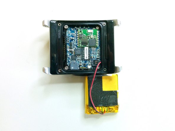

    • I'm quite interested of what they have done here. Instead of doing their own RF design, they employed a module design. Too bad there is no way to give the RF Module company any publicity Edit - the module is BT23 from ampedrf
    • Cortex M3 - STM32F103C6; Low-density performance line, ARM-based 32-bit MCU with 16 or 32 KB Flash, USB, CAN, 6 timers, 2 ADCs, 6 communication interfaces. Built-in temperature sensor here
    • Unknown 2500D8, 90MT323 Bluetooth Transceiver Chip
    • Chip Antenna

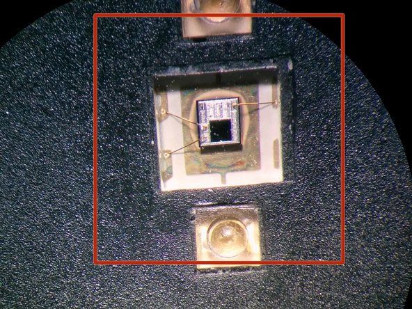

    • The wire bonded Optical Blood Flow Sensor (under a magnifying glass) with the two LED
    • 2nd Temperature Sensor (Texas Instruments) TMP112 marked as OBS. This might be one of the sensors that detects the body temperature as it is positioned nearer to the human body

I don't see any mention of USB on the MSP430's data sheet, so those two unknown chips *might* be a USB-serial bridge and an EEPROM for the VID/PID/etc. They're right next to what seems to be an oscillator too.
I didn't separate the boards on mine so I couldn't get a good look, but my battery was marked: Cyber-Power CYL-352426 3.7V, 190mAh

Quick comment, the temperature sensors used in the device are not the ones embedded in the microcontrollers but the 2 TMP112. These are the ICs with SOT563 package marked as OBS.
Luis Filipe Rossi - crwdns2934203:0crwdne2934203:0
Thanks Luis!, I will update the page shortly. PS; you can update this page too. I've set edit reputation to 0 should the general public discover more information than me
