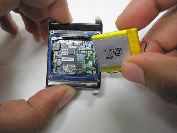

  4. Basis B1 Band LED Screen Replacement, Battery: crwdns2935265:04crwdnd2935265:01crwdnd2935265:01crwdne2935265:0
    • Use tweezers to remove elastomeric, or zebra, connector.
  5. Basis B1 Band LED Screen Replacement: crwdns2935265:05crwdnd2935265:01crwdnd2935265:02crwdne2935265:0 Basis B1 Band LED Screen Replacement: crwdns2935265:05crwdnd2935265:02crwdnd2935265:02crwdne2935265:0
    • Use the flat end of the spudger to carefully lift the battery until adhesive seal is broken.
  6. Basis B1 Band LED Screen Replacement: crwdns2935265:06crwdnd2935265:01crwdnd2935265:01crwdne2935265:0
    • Use the pointy edge of the spudger tool to detach battery leads from the circuit board.

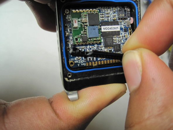

  7. Basis B1 Band LED Screen Replacement, LED Screen: crwdns2935265:07crwdnd2935265:01crwdnd2935265:02crwdne2935265:0 Basis B1 Band LED Screen Replacement, LED Screen: crwdns2935265:07crwdnd2935265:02crwdnd2935265:02crwdne2935265:0
    • Use PH000 screw driver to remove two 6mm bracketed screws.
    • Remove bracket.
  8. Basis B1 Band LED Screen Replacement: crwdns2935265:08crwdnd2935265:01crwdnd2935265:01crwdne2935265:0
    • Use PH000 tool to remove two 4mm screws.
  9. Basis B1 Band LED Screen Replacement: crwdns2935265:09crwdnd2935265:01crwdnd2935265:01crwdne2935265:0
  10. Basis B1 Band LED Screen Replacement: crwdns2935265:010crwdnd2935265:01crwdnd2935265:01crwdne2935265:0
    • Use spudger tool to lift the clasp of LED connector strip and remove from watch case.
  11. Basis B1 Band LED Screen Replacement: crwdns2935265:011crwdnd2935265:01crwdnd2935265:01crwdne2935265:0
    • Use spudger tool to remove the LED screen from the watch case.
