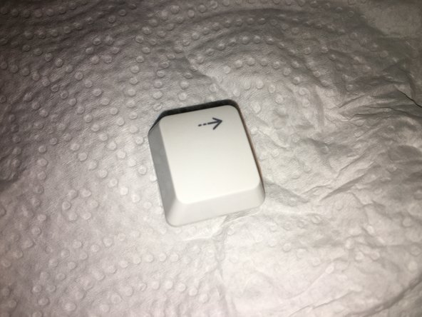

  4. Basic cleaning for the A1048 Keyboard, Keycap cleaning: crwdns2935265:04crwdnd2935265:01crwdnd2935265:03crwdne2935265:0 Basic cleaning for the A1048 Keyboard, Keycap cleaning: crwdns2935265:04crwdnd2935265:02crwdnd2935265:03crwdne2935265:0 Basic cleaning for the A1048 Keyboard, Keycap cleaning: crwdns2935265:04crwdnd2935265:03crwdnd2935265:03crwdne2935265:0
    • Individually clean each key until they reach their former white glory.
    • If your keys are yellowed, you can 'retrobright' them removing any yellow caused by the sun. There are many tutorials online showing you how to do this.
    • It may be easier to fill a bowl with soapy hot water and dump all of the keys in to clean unreachable areas.
    • Dry each keycap ready for installation.
