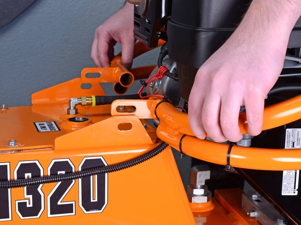

  9. Barreto Tillers E1320HTRLR 2016 Wheel Drive Motor Replacement, Remove the breather tube from the engine guard: crwdns2935265:09crwdnd2935265:01crwdnd2935265:03crwdne2935265:0 Barreto Tillers E1320HTRLR 2016 Wheel Drive Motor Replacement, Remove the breather tube from the engine guard: crwdns2935265:09crwdnd2935265:02crwdnd2935265:03crwdne2935265:0 Barreto Tillers E1320HTRLR 2016 Wheel Drive Motor Replacement, Remove the breather tube from the engine guard: crwdns2935265:09crwdnd2935265:03crwdnd2935265:03crwdne2935265:0
    • Remove the end of the tank breather tube from inside the engine guard structural pipe.
  10. Barreto Tillers E1320HTRLR 2016 Wheel Drive Motor Replacement, Tilt up the engine guard: crwdns2935265:010crwdnd2935265:01crwdnd2935265:01crwdne2935265:0
    • Use a 9/16 inch socket and wrench to remove the two bolts and accompanying nuts securing the engine guard to the tank lid, one on each side.
  11. Barreto Tillers E1320HTRLR 2016 Wheel Drive Motor Replacement: crwdns2935265:011crwdnd2935265:01crwdnd2935265:02crwdne2935265:0 Barreto Tillers E1320HTRLR 2016 Wheel Drive Motor Replacement: crwdns2935265:011crwdnd2935265:02crwdnd2935265:02crwdne2935265:0
    • Lift the engine guard up above the tank lid flanges.

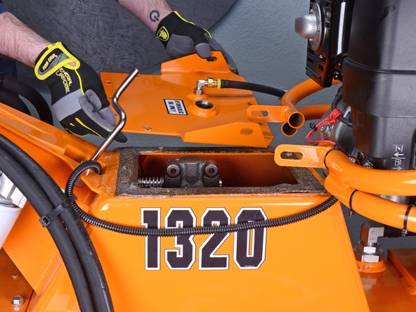

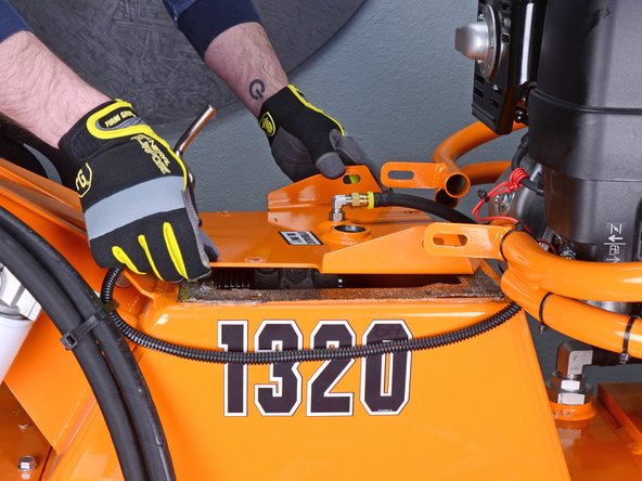

  12. Barreto Tillers E1320HTRLR 2016 Wheel Drive Motor Replacement, Remove the tank lid bolts: crwdns2935265:012crwdnd2935265:01crwdnd2935265:01crwdne2935265:0
    • Use a 3/8 inch socket to remove the ten bolts securing the tank lid.

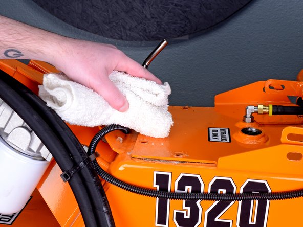

  13. Barreto Tillers E1320HTRLR 2016 Wheel Drive Motor Replacement, Clean the lid: crwdns2935265:013crwdnd2935265:01crwdnd2935265:02crwdne2935265:0 Barreto Tillers E1320HTRLR 2016 Wheel Drive Motor Replacement, Clean the lid: crwdns2935265:013crwdnd2935265:02crwdnd2935265:02crwdne2935265:0
    • Use a shop towel to clean and remove any remnants of silicone gasket material from the top of the lid and surrounding areas.
    • Try to prevent any silicone remnants from falling into the hydraulic fluid tank.
  14. Barreto Tillers E1320HTRLR 2016 Wheel Drive Motor Replacement, Remove the tank lid: crwdns2935265:014crwdnd2935265:01crwdnd2935265:02crwdne2935265:0 Barreto Tillers E1320HTRLR 2016 Wheel Drive Motor Replacement, Remove the tank lid: crwdns2935265:014crwdnd2935265:02crwdnd2935265:02crwdne2935265:0
    • Lift up on the lid to break the seal around the perimeter of the gasket.
  15. Barreto Tillers E1320HTRLR 2016 Wheel Drive Motor Replacement: crwdns2935265:015crwdnd2935265:01crwdnd2935265:03crwdne2935265:0 Barreto Tillers E1320HTRLR 2016 Wheel Drive Motor Replacement: crwdns2935265:015crwdnd2935265:02crwdnd2935265:03crwdne2935265:0 Barreto Tillers E1320HTRLR 2016 Wheel Drive Motor Replacement: crwdns2935265:015crwdnd2935265:03crwdnd2935265:03crwdne2935265:0
    • Lift the tank lid out and around the engine guard mounting tabs to remove it.

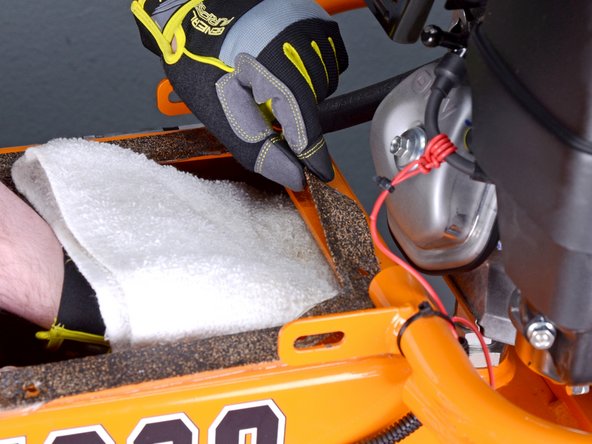

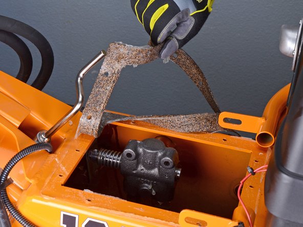

  16. Barreto Tillers E1320HTRLR 2016 Wheel Drive Motor Replacement, Remove the old gasket: crwdns2935265:016crwdnd2935265:01crwdnd2935265:03crwdne2935265:0 Barreto Tillers E1320HTRLR 2016 Wheel Drive Motor Replacement, Remove the old gasket: crwdns2935265:016crwdnd2935265:02crwdnd2935265:03crwdne2935265:0 Barreto Tillers E1320HTRLR 2016 Wheel Drive Motor Replacement, Remove the old gasket: crwdns2935265:016crwdnd2935265:03crwdnd2935265:03crwdne2935265:0
    • When peeling up the gasket, hold a shop towel underneath the lip of the tank to prevent any silicone remnants from falling in.
    • Peel the gasket up from around the perimeter of the tank.
    • Remove the gasket.

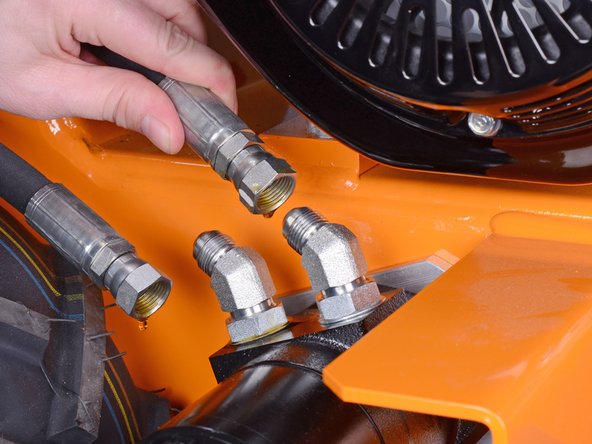

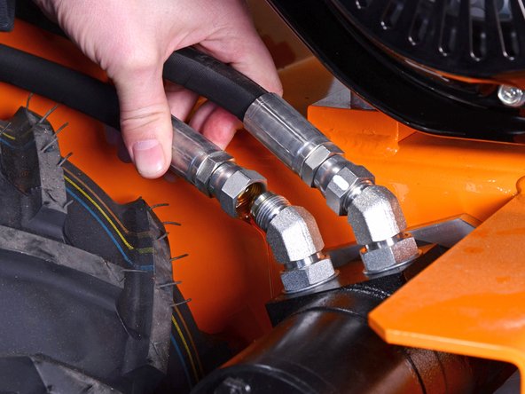

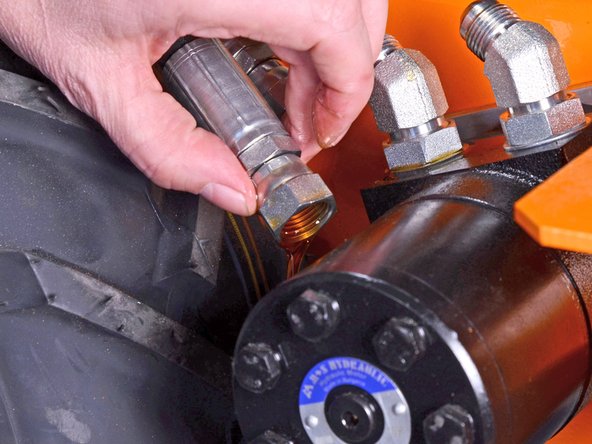

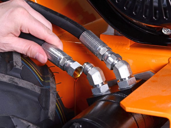

  19. Barreto Tillers E1320HTRLR 2016 Wheel Drive Motor Replacement, Remove the fluid hoses: crwdns2935265:019crwdnd2935265:01crwdnd2935265:01crwdne2935265:0
    • Use an adjustable wrench to loosen the nut securing the lower fluid hose to the fitting on the wheel motor.
  20. Barreto Tillers E1320HTRLR 2016 Wheel Drive Motor Replacement: crwdns2935265:020crwdnd2935265:01crwdnd2935265:03crwdne2935265:0 Barreto Tillers E1320HTRLR 2016 Wheel Drive Motor Replacement: crwdns2935265:020crwdnd2935265:02crwdnd2935265:03crwdne2935265:0 Barreto Tillers E1320HTRLR 2016 Wheel Drive Motor Replacement: crwdns2935265:020crwdnd2935265:03crwdnd2935265:03crwdne2935265:0
    • Remove the lower fluid hose from the wheel motor.
    • Allow residual fluid in the hose to drip into the drain pan underneath the motor.
  21. Barreto Tillers E1320HTRLR 2016 Wheel Drive Motor Replacement: crwdns2935265:021crwdnd2935265:01crwdnd2935265:01crwdne2935265:0
    • Use an adjustable wrench to loosen the nut securing the upper fluid hose to the fitting on the wheel motor.
  22. Barreto Tillers E1320HTRLR 2016 Wheel Drive Motor Replacement: crwdns2935265:022crwdnd2935265:01crwdnd2935265:03crwdne2935265:0 Barreto Tillers E1320HTRLR 2016 Wheel Drive Motor Replacement: crwdns2935265:022crwdnd2935265:02crwdnd2935265:03crwdne2935265:0 Barreto Tillers E1320HTRLR 2016 Wheel Drive Motor Replacement: crwdns2935265:022crwdnd2935265:03crwdnd2935265:03crwdne2935265:0
    • Remove the upper fluid hose from the wheel motor.
  23. Barreto Tillers E1320HTRLR 2016 Wheel Drive Motor Replacement: crwdns2935265:023crwdnd2935265:01crwdnd2935265:01crwdne2935265:0
    • Place paper towels into the hose openings to block residual fluid from dripping as you continue the procedure.

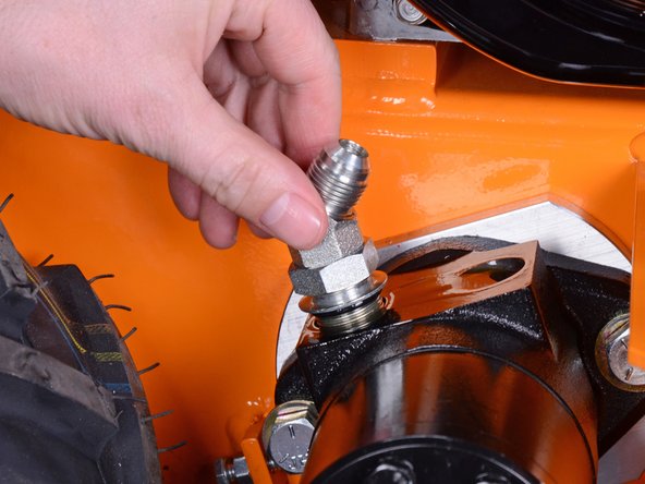

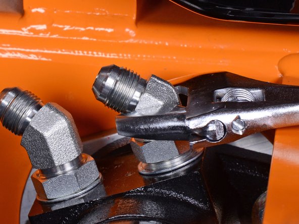

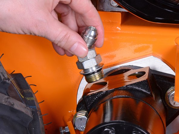

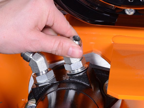

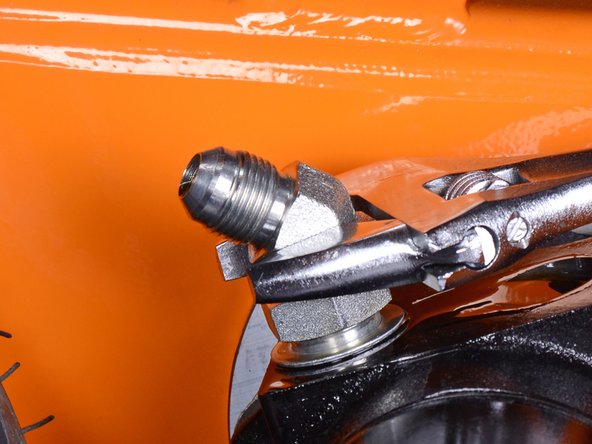

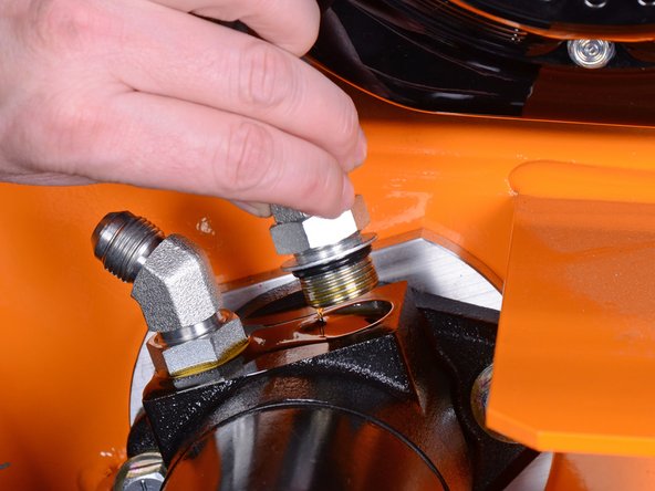

  24. Barreto Tillers E1320HTRLR 2016 Wheel Drive Motor Replacement, Remove the fittings: crwdns2935265:024crwdnd2935265:01crwdnd2935265:01crwdne2935265:0
    • Use an adjustable wrench to loosen the nut locking the upper hose fitting to the wheel motor.
  25. Barreto Tillers E1320HTRLR 2016 Wheel Drive Motor Replacement: crwdns2935265:025crwdnd2935265:01crwdnd2935265:02crwdne2935265:0 Barreto Tillers E1320HTRLR 2016 Wheel Drive Motor Replacement: crwdns2935265:025crwdnd2935265:02crwdnd2935265:02crwdne2935265:0
    • Use an adjustable wrench on the fitting body to unthread it from the wheel motor.
  26. Barreto Tillers E1320HTRLR 2016 Wheel Drive Motor Replacement: crwdns2935265:026crwdnd2935265:01crwdnd2935265:03crwdne2935265:0 Barreto Tillers E1320HTRLR 2016 Wheel Drive Motor Replacement: crwdns2935265:026crwdnd2935265:02crwdnd2935265:03crwdne2935265:0 Barreto Tillers E1320HTRLR 2016 Wheel Drive Motor Replacement: crwdns2935265:026crwdnd2935265:03crwdnd2935265:03crwdne2935265:0
    • Remove the upper fitting.
  27. Barreto Tillers E1320HTRLR 2016 Wheel Drive Motor Replacement: crwdns2935265:027crwdnd2935265:01crwdnd2935265:01crwdne2935265:0
    • Use an adjustable wrench to loosen the nut locking the lower hose fitting to the wheel motor.
  28. Barreto Tillers E1320HTRLR 2016 Wheel Drive Motor Replacement: crwdns2935265:028crwdnd2935265:01crwdnd2935265:02crwdne2935265:0 Barreto Tillers E1320HTRLR 2016 Wheel Drive Motor Replacement: crwdns2935265:028crwdnd2935265:02crwdnd2935265:02crwdne2935265:0
  29. Barreto Tillers E1320HTRLR 2016 Wheel Drive Motor Replacement: crwdns2935265:029crwdnd2935265:01crwdnd2935265:03crwdne2935265:0 Barreto Tillers E1320HTRLR 2016 Wheel Drive Motor Replacement: crwdns2935265:029crwdnd2935265:02crwdnd2935265:03crwdne2935265:0 Barreto Tillers E1320HTRLR 2016 Wheel Drive Motor Replacement: crwdns2935265:029crwdnd2935265:03crwdnd2935265:03crwdne2935265:0
    • Remove the lower fitting.

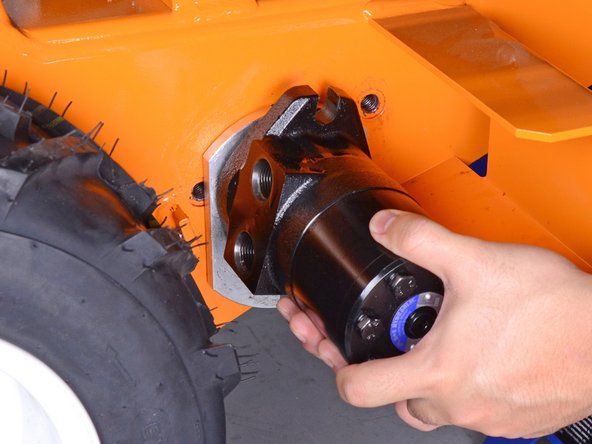

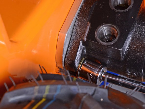

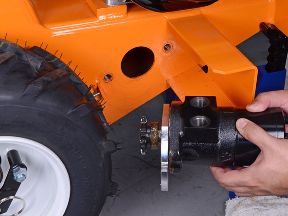

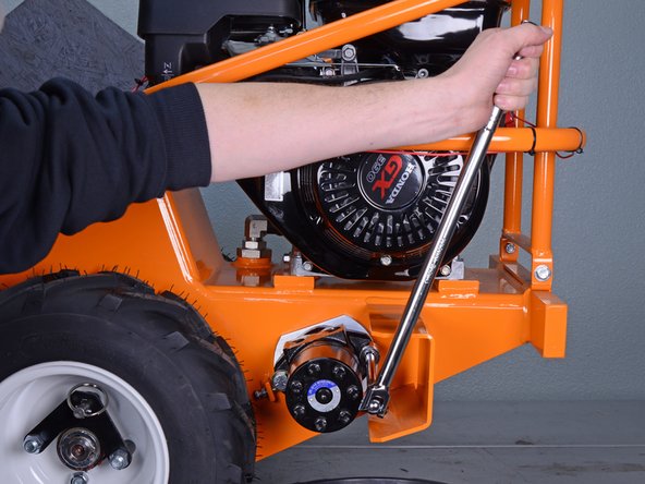

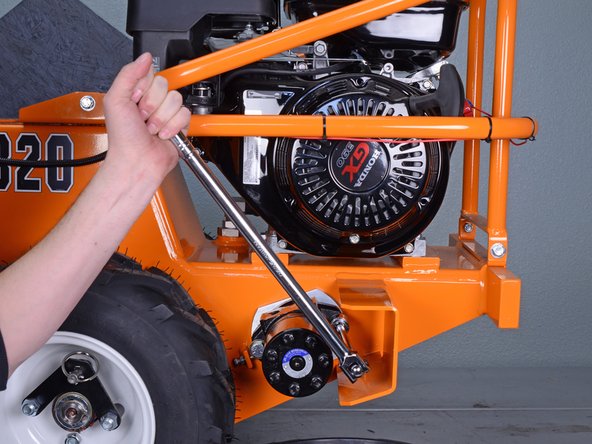

  31. Barreto Tillers E1320HTRLR 2016 Wheel Drive Motor Replacement, Remove the motor bolts: crwdns2935265:031crwdnd2935265:01crwdnd2935265:03crwdne2935265:0 Barreto Tillers E1320HTRLR 2016 Wheel Drive Motor Replacement, Remove the motor bolts: crwdns2935265:031crwdnd2935265:02crwdnd2935265:03crwdne2935265:0 Barreto Tillers E1320HTRLR 2016 Wheel Drive Motor Replacement, Remove the motor bolts: crwdns2935265:031crwdnd2935265:03crwdnd2935265:03crwdne2935265:0
    • Use a 3/4 inch socket and breaker bar to remove the two bolts securing the wheel drive motor to the frame.
  32. Barreto Tillers E1320HTRLR 2016 Wheel Drive Motor Replacement, Reinstallation tip: crwdns2935265:032crwdnd2935265:01crwdnd2935265:03crwdne2935265:0 Barreto Tillers E1320HTRLR 2016 Wheel Drive Motor Replacement, Reinstallation tip: crwdns2935265:032crwdnd2935265:02crwdnd2935265:03crwdne2935265:0 Barreto Tillers E1320HTRLR 2016 Wheel Drive Motor Replacement, Reinstallation tip: crwdns2935265:032crwdnd2935265:03crwdnd2935265:03crwdne2935265:0
    • During reinstallation, tighten the tensioner bolt down onto the motor housing to help align the motor with the spacer.
    • Tighten down both motor mounting bolts until there is no gap between the spacer and the frame or between the motor and the spacer.
    • Ensure the motor is aligned with the spacer before tightening.

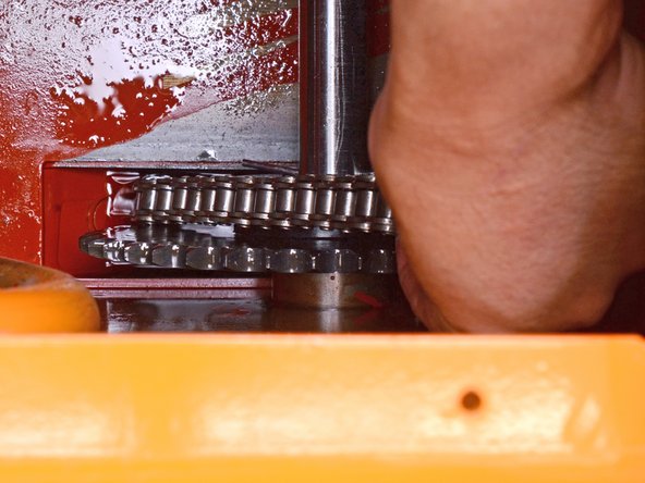

  33. Barreto Tillers E1320HTRLR 2016 Wheel Drive Motor Replacement, Give the chain slack: crwdns2935265:033crwdnd2935265:01crwdnd2935265:03crwdne2935265:0 Barreto Tillers E1320HTRLR 2016 Wheel Drive Motor Replacement, Give the chain slack: crwdns2935265:033crwdnd2935265:02crwdnd2935265:03crwdne2935265:0 Barreto Tillers E1320HTRLR 2016 Wheel Drive Motor Replacement, Give the chain slack: crwdns2935265:033crwdnd2935265:03crwdnd2935265:03crwdne2935265:0
    • With the motor loose, rotate it 90˚ counterclockwise and push it as far left as it will go to give the drive chain some slack.

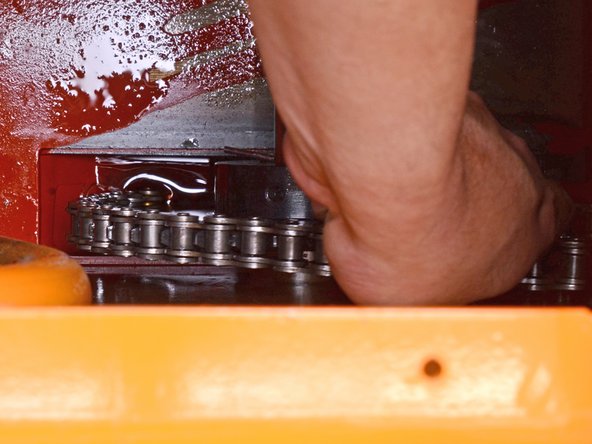

  34. Barreto Tillers E1320HTRLR 2016 Wheel Drive Motor Replacement, Remove the chain from both gears: crwdns2935265:034crwdnd2935265:01crwdnd2935265:03crwdne2935265:0 Barreto Tillers E1320HTRLR 2016 Wheel Drive Motor Replacement, Remove the chain from both gears: crwdns2935265:034crwdnd2935265:02crwdnd2935265:03crwdne2935265:0 Barreto Tillers E1320HTRLR 2016 Wheel Drive Motor Replacement, Remove the chain from both gears: crwdns2935265:034crwdnd2935265:03crwdnd2935265:03crwdne2935265:0
    • Reaching in from the top of the tank, lift the drive chain up and off of the axle gear.
    • If necessary, have another person hold the motor against the left side of the housing while the chain is being removed.
    • Remove the chain from the wheel drive motor sprocket.

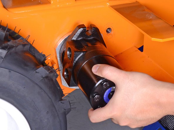

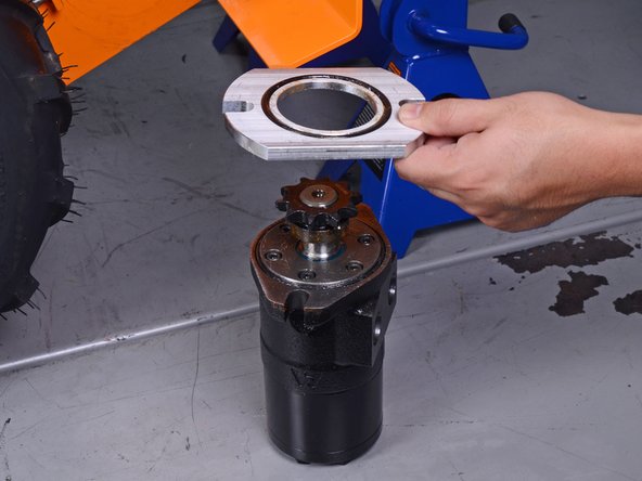

  35. Barreto Tillers E1320HTRLR 2016 Wheel Drive Motor Replacement, Remove the motor assembly: crwdns2935265:035crwdnd2935265:01crwdnd2935265:02crwdne2935265:0 Barreto Tillers E1320HTRLR 2016 Wheel Drive Motor Replacement, Remove the motor assembly: crwdns2935265:035crwdnd2935265:02crwdnd2935265:02crwdne2935265:0
    • Remove the wheel drive motor, spacer, and sprocket assembly.
  36. Barreto Tillers E1320HTRLR 2016 Wheel Drive Motor Replacement, Remove the spacer: crwdns2935265:036crwdnd2935265:01crwdnd2935265:02crwdne2935265:0 Barreto Tillers E1320HTRLR 2016 Wheel Drive Motor Replacement, Remove the spacer: crwdns2935265:036crwdnd2935265:02crwdnd2935265:02crwdne2935265:0
    • Remove the wheel motor spacer.

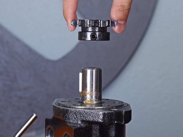

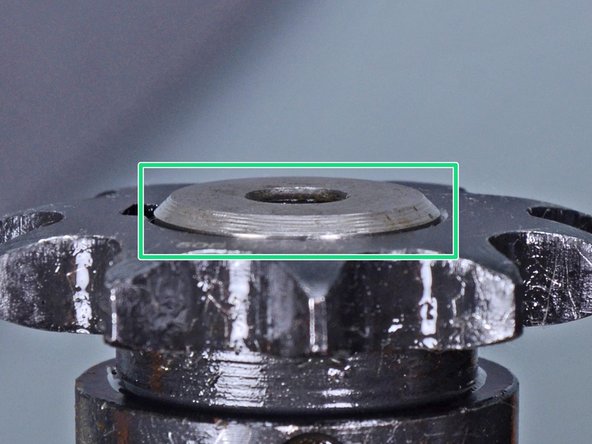

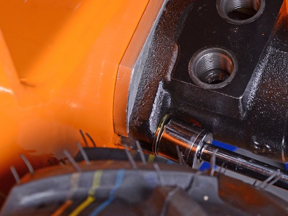

  37. Barreto Tillers E1320HTRLR 2016 Wheel Drive Motor Replacement, Loosen the sprocket set screw: crwdns2935265:037crwdnd2935265:01crwdnd2935265:01crwdne2935265:0
    • Use a 5/32 inch hex key to loosen the set screw securing the sprocket to the wheel motor shaft.
  38. Barreto Tillers E1320HTRLR 2016 Wheel Drive Motor Replacement, Remove the sprocket: crwdns2935265:038crwdnd2935265:01crwdnd2935265:03crwdne2935265:0 Barreto Tillers E1320HTRLR 2016 Wheel Drive Motor Replacement, Remove the sprocket: crwdns2935265:038crwdnd2935265:02crwdnd2935265:03crwdne2935265:0 Barreto Tillers E1320HTRLR 2016 Wheel Drive Motor Replacement, Remove the sprocket: crwdns2935265:038crwdnd2935265:03crwdnd2935265:03crwdne2935265:0
    • Remove the sprocket from the wheel motor shaft.
    • Reinstallation tip:
    • Align the top face of the sprocket with the end of the shaft's chamfer.
    • Only the motor remains.
