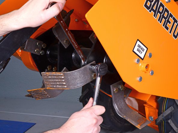

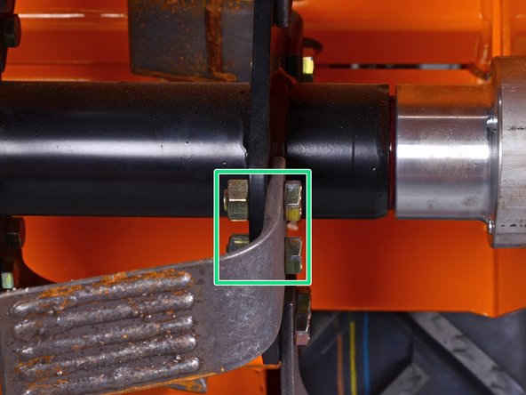

  7. Barreto Tillers E1320HTRLR 2016 Tine Replacement, Loosen the tine bolts: crwdns2935265:07crwdnd2935265:01crwdnd2935265:03crwdne2935265:0 Barreto Tillers E1320HTRLR 2016 Tine Replacement, Loosen the tine bolts: crwdns2935265:07crwdnd2935265:02crwdnd2935265:03crwdne2935265:0 Barreto Tillers E1320HTRLR 2016 Tine Replacement, Loosen the tine bolts: crwdns2935265:07crwdnd2935265:03crwdnd2935265:03crwdne2935265:0
    • Use a 5/8 inch socket with an 11/16 inch wrench to loosen the two 5/8 inch bolts and two 11/16 inch nuts securing the tine to the tine shaft.
    • Remove the two tine nuts.

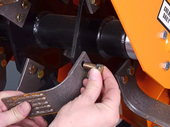

  8. Barreto Tillers E1320HTRLR 2016 Tine Replacement, Remove the tine bolts: crwdns2935265:08crwdnd2935265:01crwdnd2935265:02crwdne2935265:0 Barreto Tillers E1320HTRLR 2016 Tine Replacement, Remove the tine bolts: crwdns2935265:08crwdnd2935265:02crwdnd2935265:02crwdne2935265:0
    • Remove the two bolts holding the tine to the tine shaft.
    • During reassembly, use Loctite 271 on tine bolt threads to prevent them from loosening.

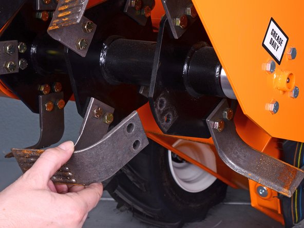

  9. Barreto Tillers E1320HTRLR 2016 Tine Replacement, Remove the tine: crwdns2935265:09crwdnd2935265:01crwdnd2935265:02crwdne2935265:0 Barreto Tillers E1320HTRLR 2016 Tine Replacement, Remove the tine: crwdns2935265:09crwdnd2935265:02crwdnd2935265:02crwdne2935265:0
    • Remove the tine.
    • Repeat this procedure for each tine you need to replace.
    • Keep track of each tine's orientation.
