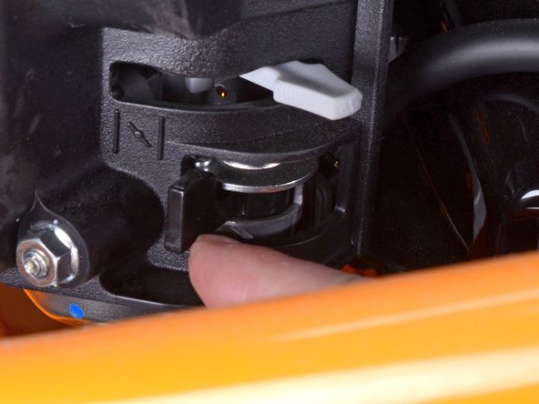

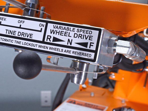

  4. Barreto Tillers E1320HTRLR 2016 Tine Drive Motor Bearing Replacement, Turn off the ignition: crwdns2935265:04crwdnd2935265:01crwdnd2935265:02crwdne2935265:0 Barreto Tillers E1320HTRLR 2016 Tine Drive Motor Bearing Replacement, Turn off the ignition: crwdns2935265:04crwdnd2935265:02crwdnd2935265:02crwdne2935265:0
    • Flip the ignition switch to the OFF position.
    • Ensure the wheel drive control lever is set to the neutral position.

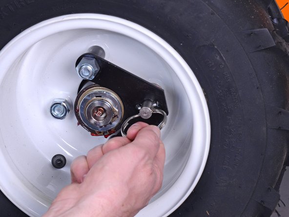

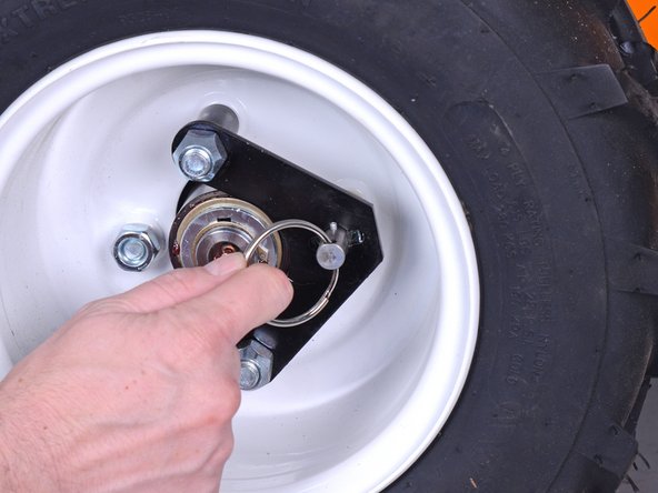

  5. Barreto Tillers E1320HTRLR 2016 Tine Drive Motor Bearing Replacement, Allow the wheels to freewheel: crwdns2935265:05crwdnd2935265:01crwdnd2935265:03crwdne2935265:0 Barreto Tillers E1320HTRLR 2016 Tine Drive Motor Bearing Replacement, Allow the wheels to freewheel: crwdns2935265:05crwdnd2935265:02crwdnd2935265:03crwdne2935265:0 Barreto Tillers E1320HTRLR 2016 Tine Drive Motor Bearing Replacement, Allow the wheels to freewheel: crwdns2935265:05crwdnd2935265:03crwdnd2935265:03crwdne2935265:0
    • Pull the locking pin out and rotate it 90˚ to unlock the right wheel from the hub.
    • Repeat for the left wheel.

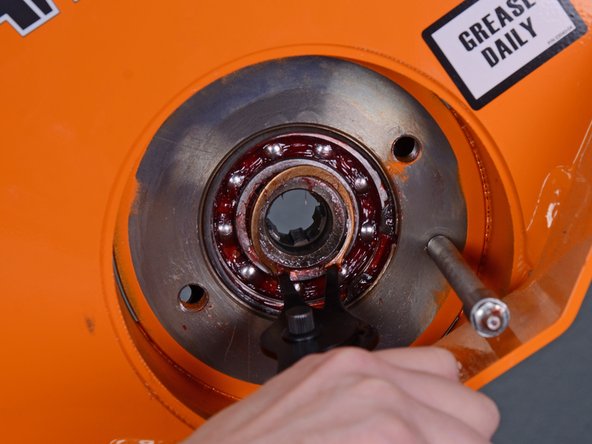

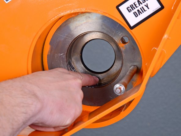

  7. Barreto Tillers E1320HTRLR 2016 Tine Drive Motor Bearing Replacement, Remove the grease fitting: crwdns2935265:07crwdnd2935265:01crwdnd2935265:01crwdne2935265:0
    • Use an 8 mm socket to remove the outboard bearing grease fitting.

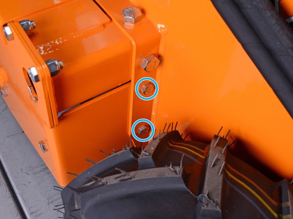

  8. Barreto Tillers E1320HTRLR 2016 Tine Drive Motor Bearing Replacement, Remove the side plate bolts: crwdns2935265:08crwdnd2935265:01crwdnd2935265:02crwdne2935265:0 Barreto Tillers E1320HTRLR 2016 Tine Drive Motor Bearing Replacement, Remove the side plate bolts: crwdns2935265:08crwdnd2935265:02crwdnd2935265:02crwdne2935265:0
    • Use a 9/16 inch socket to remove the four bolts securing the tine shaft to the side plate.
    • Use a 9/16 socket and wrench to remove the five bolts and accompanying nuts securing the side plate to the frame, three on the outside and two in the wheel well.

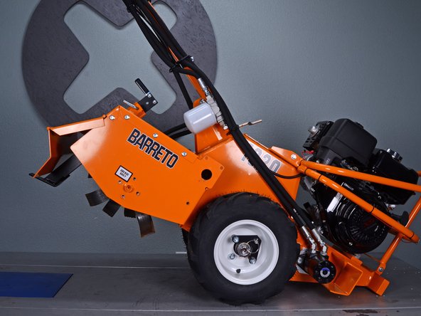

  9. Barreto Tillers E1320HTRLR 2016 Tine Drive Motor Bearing Replacement, Tilt the tiller: crwdns2935265:09crwdnd2935265:01crwdnd2935265:02crwdne2935265:0 Barreto Tillers E1320HTRLR 2016 Tine Drive Motor Bearing Replacement, Tilt the tiller: crwdns2935265:09crwdnd2935265:02crwdnd2935265:02crwdne2935265:0
    • Tilt the tiller up so the motor side is resting on the work surface with the tines raised.

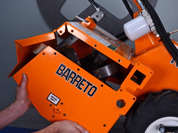

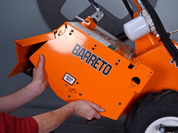

  11. Barreto Tillers E1320HTRLR 2016 Tine Drive Motor Bearing Replacement, Remove the side plate: crwdns2935265:011crwdnd2935265:01crwdnd2935265:03crwdne2935265:0 Barreto Tillers E1320HTRLR 2016 Tine Drive Motor Bearing Replacement, Remove the side plate: crwdns2935265:011crwdnd2935265:02crwdnd2935265:03crwdne2935265:0 Barreto Tillers E1320HTRLR 2016 Tine Drive Motor Bearing Replacement, Remove the side plate: crwdns2935265:011crwdnd2935265:03crwdnd2935265:03crwdne2935265:0
    • Slide the side plate down and away from the device to remove it.

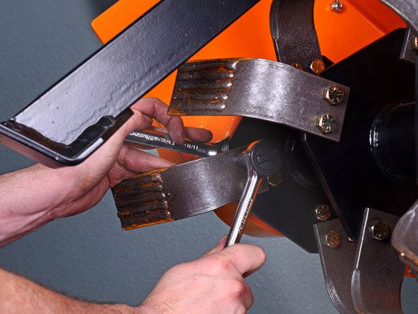

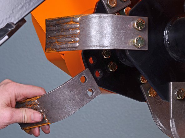

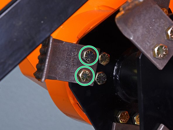

  12. Barreto Tillers E1320HTRLR 2016 Tine Drive Motor Bearing Replacement, Remove the tine bolts: crwdns2935265:012crwdnd2935265:01crwdnd2935265:03crwdne2935265:0 Barreto Tillers E1320HTRLR 2016 Tine Drive Motor Bearing Replacement, Remove the tine bolts: crwdns2935265:012crwdnd2935265:02crwdnd2935265:03crwdne2935265:0 Barreto Tillers E1320HTRLR 2016 Tine Drive Motor Bearing Replacement, Remove the tine bolts: crwdns2935265:012crwdnd2935265:03crwdnd2935265:03crwdne2935265:0
    • The tines closest to the tine drive motor need to be removed in order to allow access to the bolts securing the tine shaft to the hub.
    • Use a 5/8 inch socket with an 11/16 inch wrench to loosen the two 5/8 inch bolts and two 11/16 inch nuts securing the tine to the tine shaft.
    • Remove the two tine nuts.
  13. Barreto Tillers E1320HTRLR 2016 Tine Drive Motor Bearing Replacement: crwdns2935265:013crwdnd2935265:01crwdnd2935265:02crwdne2935265:0 Barreto Tillers E1320HTRLR 2016 Tine Drive Motor Bearing Replacement: crwdns2935265:013crwdnd2935265:02crwdnd2935265:02crwdne2935265:0
    • Remove the two bolts holding the tine to the tine shaft.

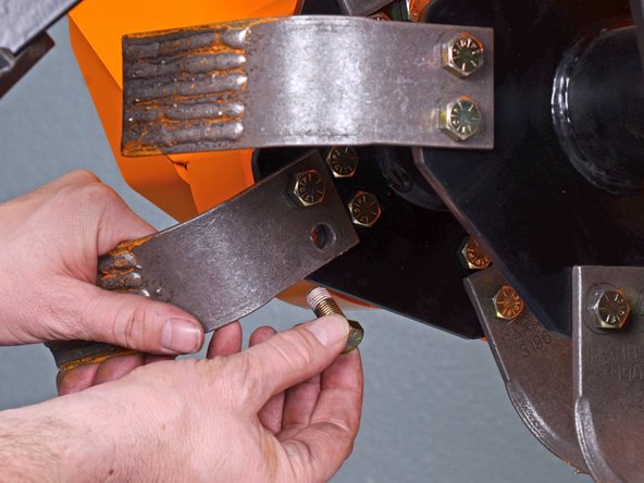

  14. Barreto Tillers E1320HTRLR 2016 Tine Drive Motor Bearing Replacement, Remove the tines: crwdns2935265:014crwdnd2935265:01crwdnd2935265:02crwdne2935265:0 Barreto Tillers E1320HTRLR 2016 Tine Drive Motor Bearing Replacement, Remove the tines: crwdns2935265:014crwdnd2935265:02crwdnd2935265:02crwdne2935265:0
    • Remove the tine.
    • Repeat this procedure for all four tines closest to the tine drive motor, opposite the outboard bearing assembly.
    • Keep track of each tine's orientation.

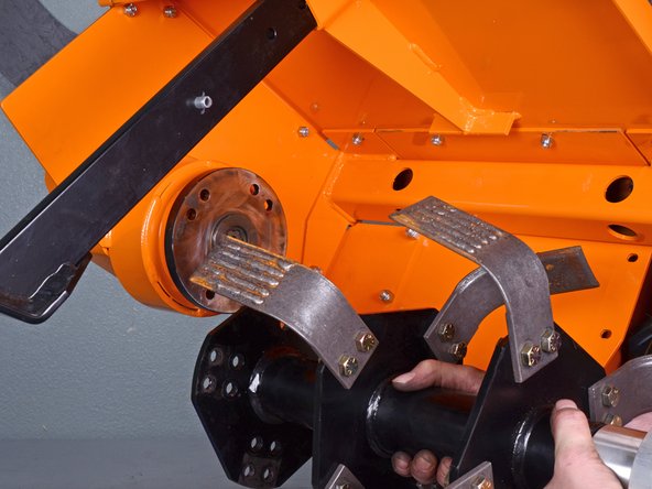

  15. Barreto Tillers E1320HTRLR 2016 Tine Drive Motor Bearing Replacement, Remove the tine shaft bolts: crwdns2935265:015crwdnd2935265:01crwdnd2935265:01crwdne2935265:0
    • Use a 5/8 inch socket with an 11/16 inch wrench to remove the two 5/8 inch bolts and two 11/16 inch nuts behind each removed tine.
    • Repeat this for each of the four tine locations; there are a total of eight bolts to remove.

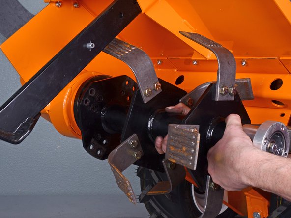

  16. Barreto Tillers E1320HTRLR 2016 Tine Drive Motor Bearing Replacement, Remove the tine shaft: crwdns2935265:016crwdnd2935265:01crwdnd2935265:03crwdne2935265:0 Barreto Tillers E1320HTRLR 2016 Tine Drive Motor Bearing Replacement, Remove the tine shaft: crwdns2935265:016crwdnd2935265:02crwdnd2935265:03crwdne2935265:0 Barreto Tillers E1320HTRLR 2016 Tine Drive Motor Bearing Replacement, Remove the tine shaft: crwdns2935265:016crwdnd2935265:03crwdnd2935265:03crwdne2935265:0
    • Remove the tine shaft from the hub.

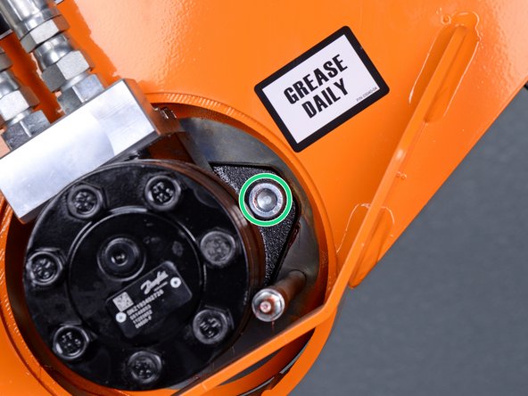

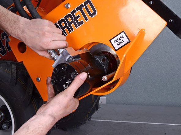

  17. Barreto Tillers E1320HTRLR 2016 Tine Drive Motor Bearing Replacement, Remove the tine drive motor cap screws: crwdns2935265:017crwdnd2935265:01crwdnd2935265:02crwdne2935265:0 Barreto Tillers E1320HTRLR 2016 Tine Drive Motor Bearing Replacement, Remove the tine drive motor cap screws: crwdns2935265:017crwdnd2935265:02crwdnd2935265:02crwdne2935265:0
    • Use a 3/8 inch hex driver to remove the two cap screws securing the tine drive motor to the lefthand side plate.
  18. Barreto Tillers E1320HTRLR 2016 Tine Drive Motor Bearing Replacement, Remove the tine drive motor: crwdns2935265:018crwdnd2935265:01crwdnd2935265:02crwdne2935265:0 Barreto Tillers E1320HTRLR 2016 Tine Drive Motor Bearing Replacement, Remove the tine drive motor: crwdns2935265:018crwdnd2935265:02crwdnd2935265:02crwdne2935265:0
    • Pull the motor away from the side plate to remove it.

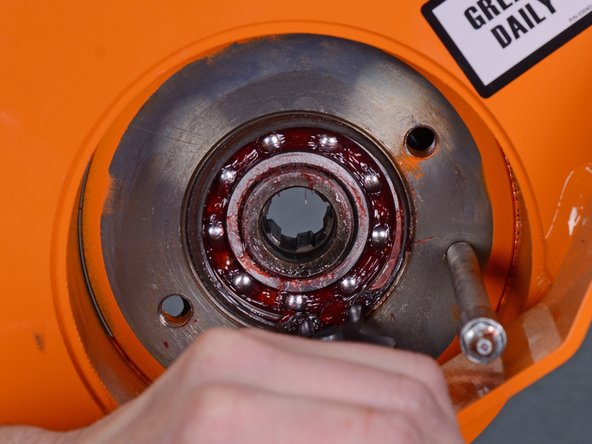

  19. Barreto Tillers E1320HTRLR 2016 Tine Drive Motor Bearing Replacement, Clean the bearing: crwdns2935265:019crwdnd2935265:01crwdnd2935265:01crwdne2935265:0
    • Use a clean paper towel or shop rag to remove the grease from the tine drive motor bearing.

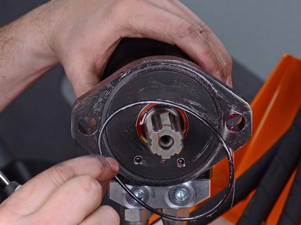

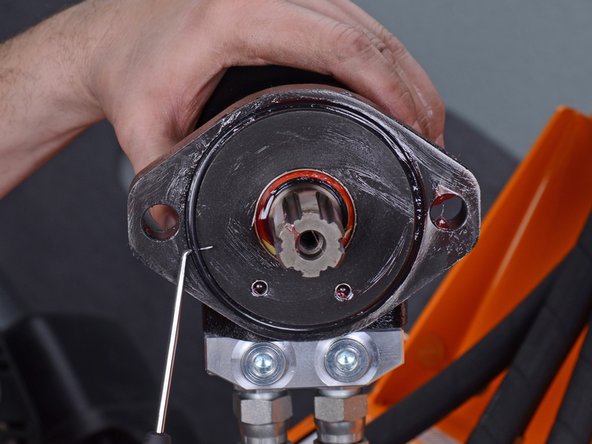

  20. Barreto Tillers E1320HTRLR 2016 Tine Drive Motor Bearing Replacement, Remove the O-ring: crwdns2935265:020crwdnd2935265:01crwdnd2935265:03crwdne2935265:0 Barreto Tillers E1320HTRLR 2016 Tine Drive Motor Bearing Replacement, Remove the O-ring: crwdns2935265:020crwdnd2935265:02crwdnd2935265:03crwdne2935265:0 Barreto Tillers E1320HTRLR 2016 Tine Drive Motor Bearing Replacement, Remove the O-ring: crwdns2935265:020crwdnd2935265:03crwdnd2935265:03crwdne2935265:0
    • Use a pick tool to remove the O-ring from its recess on the outer edge of the tine drive motor.
    • During reassembly, install a new O-ring.

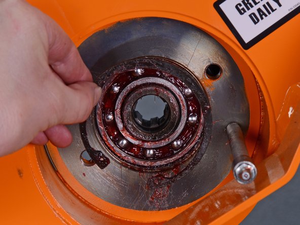

  21. Barreto Tillers E1320HTRLR 2016 Tine Drive Motor Bearing Replacement, Remove the inner snap ring: crwdns2935265:021crwdnd2935265:01crwdnd2935265:03crwdne2935265:0 Barreto Tillers E1320HTRLR 2016 Tine Drive Motor Bearing Replacement, Remove the inner snap ring: crwdns2935265:021crwdnd2935265:02crwdnd2935265:03crwdne2935265:0 Barreto Tillers E1320HTRLR 2016 Tine Drive Motor Bearing Replacement, Remove the inner snap ring: crwdns2935265:021crwdnd2935265:03crwdnd2935265:03crwdne2935265:0
    • Use a pair of snap ring pliers to remove the inner snap ring from the tine drive motor bearing.

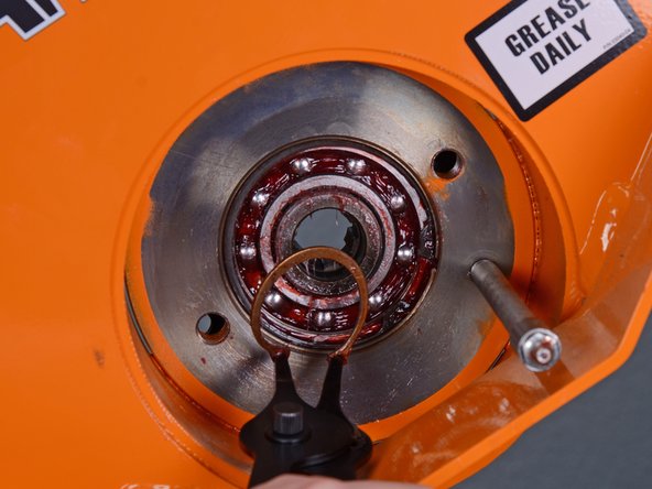

  22. Barreto Tillers E1320HTRLR 2016 Tine Drive Motor Bearing Replacement, Remove the outer snap ring: crwdns2935265:022crwdnd2935265:01crwdnd2935265:03crwdne2935265:0 Barreto Tillers E1320HTRLR 2016 Tine Drive Motor Bearing Replacement, Remove the outer snap ring: crwdns2935265:022crwdnd2935265:02crwdnd2935265:03crwdne2935265:0 Barreto Tillers E1320HTRLR 2016 Tine Drive Motor Bearing Replacement, Remove the outer snap ring: crwdns2935265:022crwdnd2935265:03crwdnd2935265:03crwdne2935265:0
    • Use a pair of snap ring pliers to remove the outer snap ring from the tine drive motor bearing.

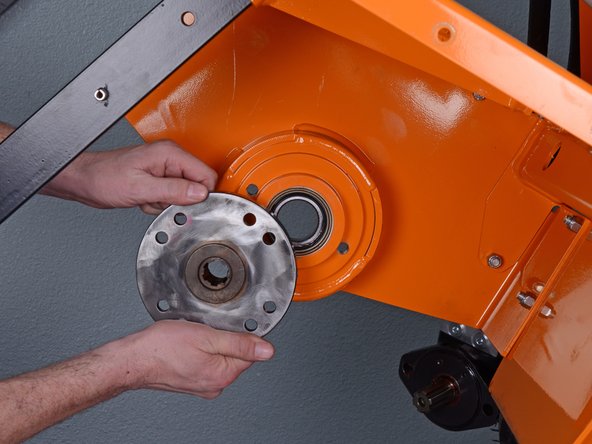

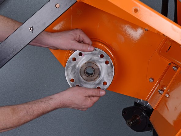

  23. Barreto Tillers E1320HTRLR 2016 Tine Drive Motor Bearing Replacement, Remove the hub: crwdns2935265:023crwdnd2935265:01crwdnd2935265:03crwdne2935265:0 Barreto Tillers E1320HTRLR 2016 Tine Drive Motor Bearing Replacement, Remove the hub: crwdns2935265:023crwdnd2935265:02crwdnd2935265:03crwdne2935265:0 Barreto Tillers E1320HTRLR 2016 Tine Drive Motor Bearing Replacement, Remove the hub: crwdns2935265:023crwdnd2935265:03crwdnd2935265:03crwdne2935265:0
    • Remove the tine drive motor hub.

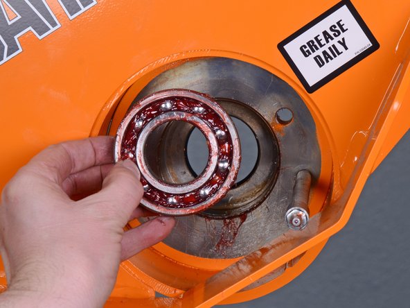

  24. Barreto Tillers E1320HTRLR 2016 Tine Drive Motor Bearing Replacement, Remove the internal bearing: crwdns2935265:024crwdnd2935265:01crwdnd2935265:03crwdne2935265:0 Barreto Tillers E1320HTRLR 2016 Tine Drive Motor Bearing Replacement, Remove the internal bearing: crwdns2935265:024crwdnd2935265:02crwdnd2935265:03crwdne2935265:0 Barreto Tillers E1320HTRLR 2016 Tine Drive Motor Bearing Replacement, Remove the internal bearing: crwdns2935265:024crwdnd2935265:03crwdnd2935265:03crwdne2935265:0
    • Use a bearing removal tool to remove the ball bearing from the housing.
    • Grease the internal walls of the outboard bearing housing before installing new bearings.
    • During reassembly, ensure the new bearings sit flush along the inner lip of the housing.
