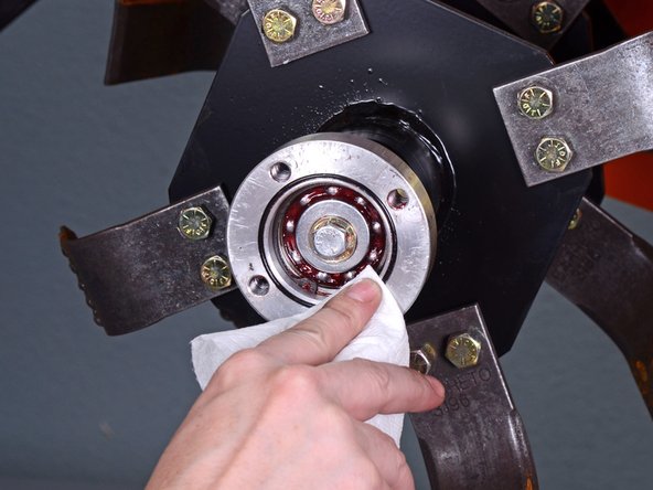

  12. Barreto Tillers E1320HTRLR 2016 Outboard Internal Bearings Replacement, Clean the assembly: crwdns2935265:012crwdnd2935265:01crwdnd2935265:02crwdne2935265:0 Barreto Tillers E1320HTRLR 2016 Outboard Internal Bearings Replacement, Clean the assembly: crwdns2935265:012crwdnd2935265:02crwdnd2935265:02crwdne2935265:0
    • Use a clean paper towel or shop rag to remove the grease from the outboard bearing assembly.

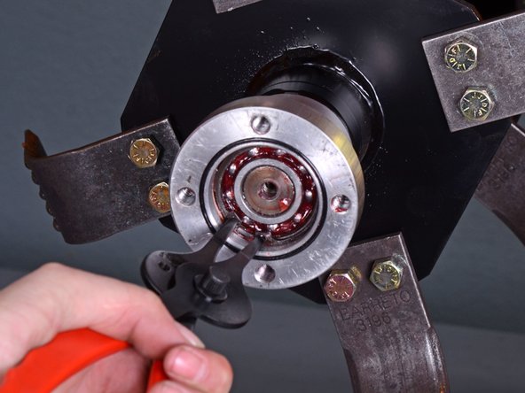

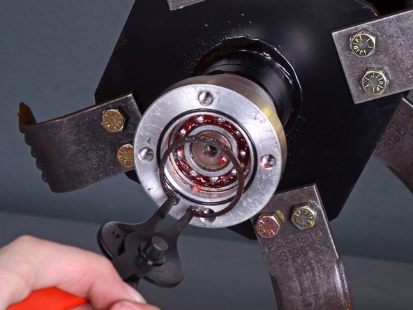

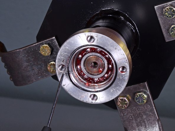

  15. Barreto Tillers E1320HTRLR 2016 Outboard Internal Bearings Replacement, Remove the snap ring: crwdns2935265:015crwdnd2935265:01crwdnd2935265:03crwdne2935265:0 Barreto Tillers E1320HTRLR 2016 Outboard Internal Bearings Replacement, Remove the snap ring: crwdns2935265:015crwdnd2935265:02crwdnd2935265:03crwdne2935265:0 Barreto Tillers E1320HTRLR 2016 Outboard Internal Bearings Replacement, Remove the snap ring: crwdns2935265:015crwdnd2935265:03crwdnd2935265:03crwdne2935265:0
    • Use a pair of snap ring pliers to remove the snap ring from the outboard bearing assembly.

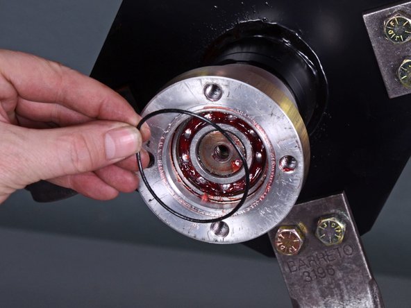

  16. Barreto Tillers E1320HTRLR 2016 Outboard Internal Bearings Replacement, Remove the O-ring: crwdns2935265:016crwdnd2935265:01crwdnd2935265:03crwdne2935265:0 Barreto Tillers E1320HTRLR 2016 Outboard Internal Bearings Replacement, Remove the O-ring: crwdns2935265:016crwdnd2935265:02crwdnd2935265:03crwdne2935265:0 Barreto Tillers E1320HTRLR 2016 Outboard Internal Bearings Replacement, Remove the O-ring: crwdns2935265:016crwdnd2935265:03crwdnd2935265:03crwdne2935265:0
    • Use a pick tool to remove the O-ring from its recess on the outer edge of the assembly.
    • During reassembly, install a new O-ring.

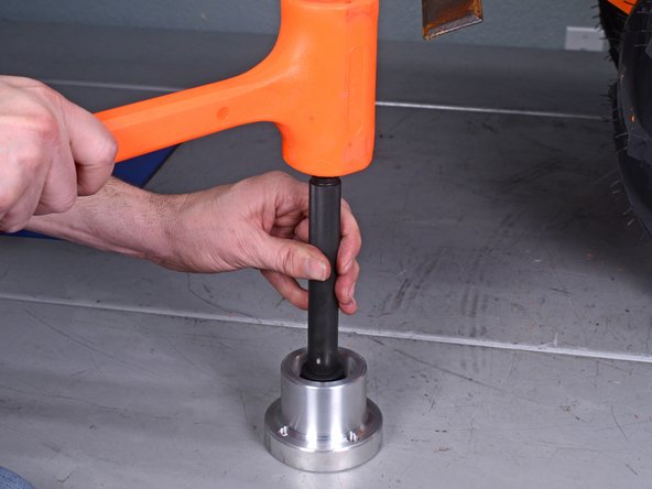

  18. Barreto Tillers E1320HTRLR 2016 Outboard Internal Bearings Replacement, Remove the internal ball bearings: crwdns2935265:018crwdnd2935265:01crwdnd2935265:03crwdne2935265:0 Barreto Tillers E1320HTRLR 2016 Outboard Internal Bearings Replacement, Remove the internal ball bearings: crwdns2935265:018crwdnd2935265:02crwdnd2935265:03crwdne2935265:0 Barreto Tillers E1320HTRLR 2016 Outboard Internal Bearings Replacement, Remove the internal ball bearings: crwdns2935265:018crwdnd2935265:03crwdnd2935265:03crwdne2935265:0
    • Set the assembly flange-down onto the work surface.
    • Use a bearing removal tool or bearing press to remove the ball bearings from the housing.
    • Grease the internal walls of the outboard bearing housing before installing new bearings.
    • During reassembly, ensure the new bearings sit flush along the inner lip of the housing.

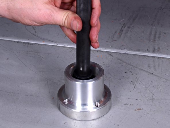

  19. Barreto Tillers E1320HTRLR 2016 Outboard Internal Bearings Replacement, Remove the dust shield: crwdns2935265:019crwdnd2935265:01crwdnd2935265:01crwdne2935265:0
    • With the bearings removed from the housing, remove the dust shield.
    • During reassembly, install the dust shield after both bearings are pressed into place.
