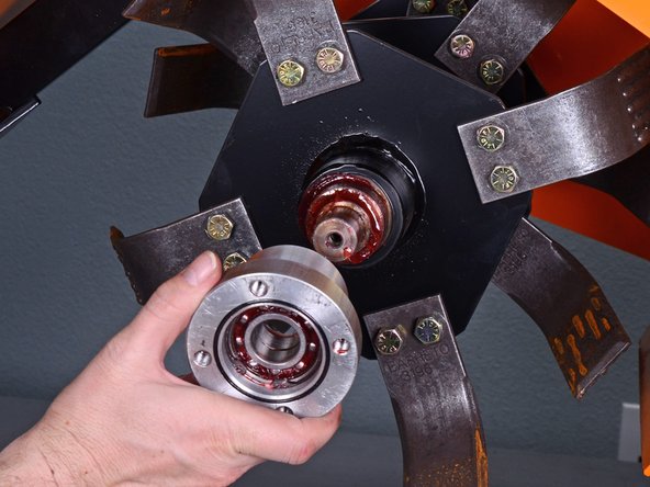

  13. Barreto Tillers E1320HTRLR 2016 Outboard Bearing Assembly Replacement, Remove the outboard bearing assembly bolt: crwdns2935265:013crwdnd2935265:01crwdnd2935265:01crwdne2935265:0
    • Use a 9/16 inch socket to remove the bolt securing the outboard bearing assembly to the tine shaft.
  14. Barreto Tillers E1320HTRLR 2016 Outboard Bearing Assembly Replacement, Remove the washers: crwdns2935265:014crwdnd2935265:01crwdnd2935265:01crwdne2935265:0
    • Remove the three washers, held in place by the bolt, from the outboard bearing assembly.
  15. Barreto Tillers E1320HTRLR 2016 Outboard Bearing Assembly Replacement, Remove the outboard bearing assembly: crwdns2935265:015crwdnd2935265:01crwdnd2935265:02crwdne2935265:0 Barreto Tillers E1320HTRLR 2016 Outboard Bearing Assembly Replacement, Remove the outboard bearing assembly: crwdns2935265:015crwdnd2935265:02crwdnd2935265:02crwdne2935265:0
    • Pull the assembly off of the tine shaft to remove it.
