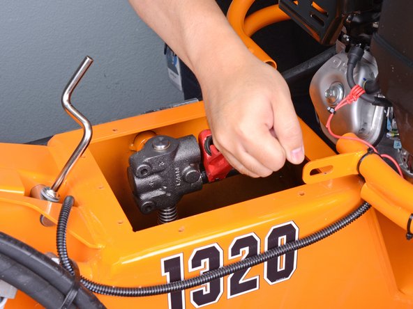

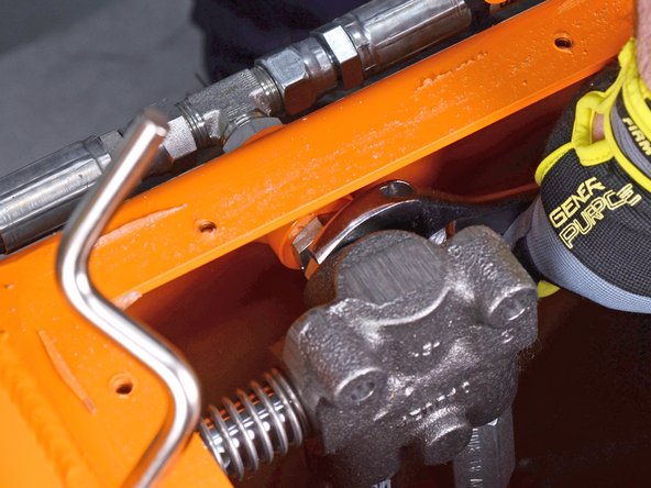

  18. Barreto Tillers E1320HTRLR 2016 Actuator Valve Replacement, Loosen the fitting's lock nut: crwdns2935265:018crwdnd2935265:01crwdnd2935265:03crwdne2935265:0 Barreto Tillers E1320HTRLR 2016 Actuator Valve Replacement, Loosen the fitting's lock nut: crwdns2935265:018crwdnd2935265:02crwdnd2935265:03crwdne2935265:0 Barreto Tillers E1320HTRLR 2016 Actuator Valve Replacement, Loosen the fitting's lock nut: crwdns2935265:018crwdnd2935265:03crwdnd2935265:03crwdne2935265:0
    • Use a 7/8 inch open-ended wrench or an adjustable wrench to loosen the lock nut closest to the valve on the actuator fitting.
  19. Barreto Tillers E1320HTRLR 2016 Actuator Valve Replacement, Rotate the actuator valve horizontal: crwdns2935265:019crwdnd2935265:01crwdnd2935265:02crwdne2935265:0 Barreto Tillers E1320HTRLR 2016 Actuator Valve Replacement, Rotate the actuator valve horizontal: crwdns2935265:019crwdnd2935265:02crwdnd2935265:02crwdne2935265:0
    • Rotate the actuator valve so the return tube and relief valve are horizontal and parallel to the tank opening, facing the engine.

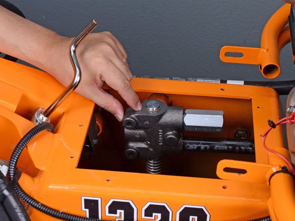

  20. Barreto Tillers E1320HTRLR 2016 Actuator Valve Replacement, Remove the relief valve: crwdns2935265:020crwdnd2935265:01crwdnd2935265:03crwdne2935265:0 Barreto Tillers E1320HTRLR 2016 Actuator Valve Replacement, Remove the relief valve: crwdns2935265:020crwdnd2935265:02crwdnd2935265:03crwdne2935265:0 Barreto Tillers E1320HTRLR 2016 Actuator Valve Replacement, Remove the relief valve: crwdns2935265:020crwdnd2935265:03crwdnd2935265:03crwdne2935265:0
    • Use a 1-1/16 inch wrench to loosen and remove the relief valve.
    • This may require a bit of force. Use a breaker bar if necessary.

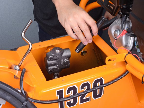

  21. Barreto Tillers E1320HTRLR 2016 Actuator Valve Replacement, Remove the return tube: crwdns2935265:021crwdnd2935265:01crwdnd2935265:03crwdne2935265:0 Barreto Tillers E1320HTRLR 2016 Actuator Valve Replacement, Remove the return tube: crwdns2935265:021crwdnd2935265:02crwdnd2935265:03crwdne2935265:0 Barreto Tillers E1320HTRLR 2016 Actuator Valve Replacement, Remove the return tube: crwdns2935265:021crwdnd2935265:03crwdnd2935265:03crwdne2935265:0
    • Use a pipe wrench to remove the return tube.

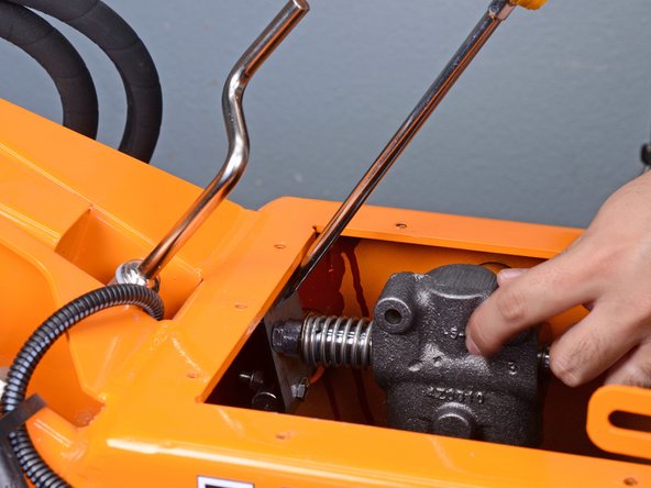

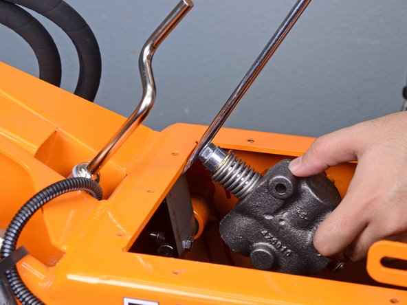

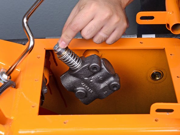

  22. Barreto Tillers E1320HTRLR 2016 Actuator Valve Replacement, Loosen the actuator valve: crwdns2935265:022crwdnd2935265:01crwdnd2935265:03crwdne2935265:0 Barreto Tillers E1320HTRLR 2016 Actuator Valve Replacement, Loosen the actuator valve: crwdns2935265:022crwdnd2935265:02crwdnd2935265:03crwdne2935265:0 Barreto Tillers E1320HTRLR 2016 Actuator Valve Replacement, Loosen the actuator valve: crwdns2935265:022crwdnd2935265:03crwdnd2935265:03crwdne2935265:0
    • Rotate the actuator valve counterclockwise to loosen it from the tank fitting.
    • Rotate the valve until the plunger assembly becomes blocked by the lip of the tank edge.

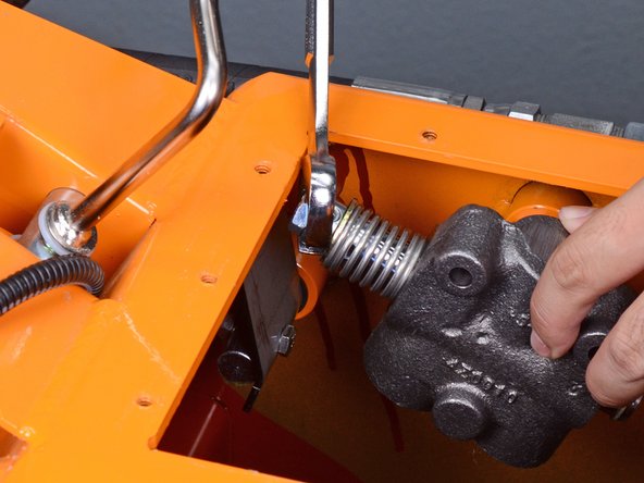

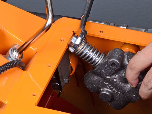

  23. Barreto Tillers E1320HTRLR 2016 Actuator Valve Replacement: crwdns2935265:023crwdnd2935265:01crwdnd2935265:03crwdne2935265:0 Barreto Tillers E1320HTRLR 2016 Actuator Valve Replacement: crwdns2935265:023crwdnd2935265:02crwdnd2935265:03crwdne2935265:0 Barreto Tillers E1320HTRLR 2016 Actuator Valve Replacement: crwdns2935265:023crwdnd2935265:03crwdnd2935265:03crwdne2935265:0
    • Using a long flathead screwdriver, pivot one end off of the edge of the tank, compressing the plunger assembly on the actuator valve.
    • While the plunger assembly is compressed, rotate the actuator valve down, past the edge of the tank, and onto the strike plate.
    • Repeat the last two steps to continue to loosen the actuator valve from the tank fitting.
  24. Barreto Tillers E1320HTRLR 2016 Actuator Valve Replacement, Reassembly tip: crwdns2935265:024crwdnd2935265:01crwdnd2935265:03crwdne2935265:0 Barreto Tillers E1320HTRLR 2016 Actuator Valve Replacement, Reassembly tip: crwdns2935265:024crwdnd2935265:02crwdnd2935265:03crwdne2935265:0 Barreto Tillers E1320HTRLR 2016 Actuator Valve Replacement, Reassembly tip: crwdns2935265:024crwdnd2935265:03crwdnd2935265:03crwdne2935265:0
    • Reassembly tip: In order to bring the plunger assembly backwards, up and over the tank edge, use an open-ended wrench to compress the plunger assembly while rotating the actuator valve.

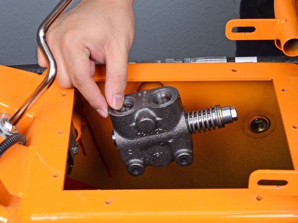

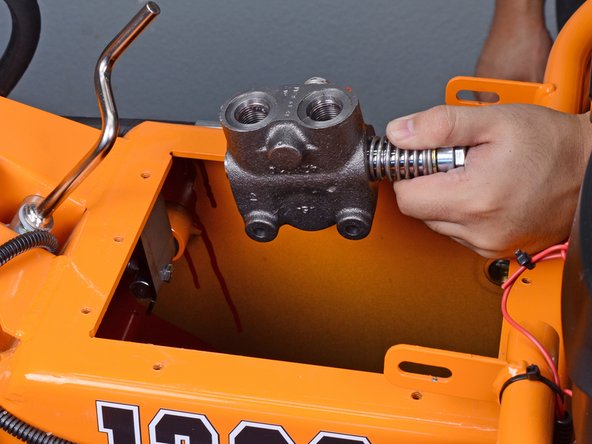

  25. Barreto Tillers E1320HTRLR 2016 Actuator Valve Replacement, Remove the actuator valve: crwdns2935265:025crwdnd2935265:01crwdnd2935265:02crwdne2935265:0 Barreto Tillers E1320HTRLR 2016 Actuator Valve Replacement, Remove the actuator valve: crwdns2935265:025crwdnd2935265:02crwdnd2935265:02crwdne2935265:0
    • Remove the actuator valve.

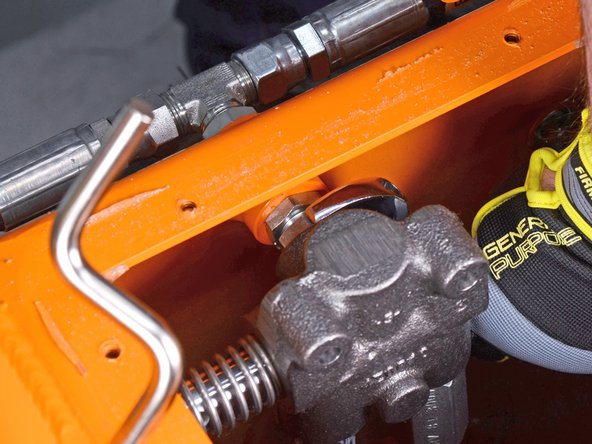

  26. Barreto Tillers E1320HTRLR 2016 Actuator Valve Replacement, Remove the tank fitting: crwdns2935265:026crwdnd2935265:01crwdnd2935265:01crwdne2935265:0
    • Use a 7/8 inch wrench to remove the tank fitting.
    • During reinstallation, install the fitting as shown, with the smaller, stationary nut facing the tank wall.
