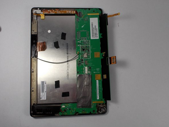

  5. Barnes And Noble Nook HD Tablet Screen Replacement, Flip the nook: crwdns2935265:05crwdnd2935265:01crwdnd2935265:01crwdne2935265:0
    • flip center chassis so that the back of the screen is facing you, and the hole is positioned in the bottom right corner.
  6. Barnes And Noble Nook HD Tablet Screen Replacement, Detach the screen from chassis part 1: crwdns2935265:06crwdnd2935265:01crwdnd2935265:03crwdne2935265:0 Barnes And Noble Nook HD Tablet Screen Replacement, Detach the screen from chassis part 1: crwdns2935265:06crwdnd2935265:02crwdnd2935265:03crwdne2935265:0 Barnes And Noble Nook HD Tablet Screen Replacement, Detach the screen from chassis part 1: crwdns2935265:06crwdnd2935265:03crwdnd2935265:03crwdne2935265:0
    • Remove copper tape above the antenna, 3 quarters of the way up the left side of the nook.
  7. Barnes And Noble Nook HD Tablet Screen Replacement, Detach the screen from chassis part 2: crwdns2935265:07crwdnd2935265:01crwdnd2935265:02crwdne2935265:0 Barnes And Noble Nook HD Tablet Screen Replacement, Detach the screen from chassis part 2: crwdns2935265:07crwdnd2935265:02crwdnd2935265:02crwdne2935265:0
    • Locate thin orange strip on the top side of the motherboard. Apply tweezers to the black casing that locks it into the motherboard (plastic piece will completely come out).

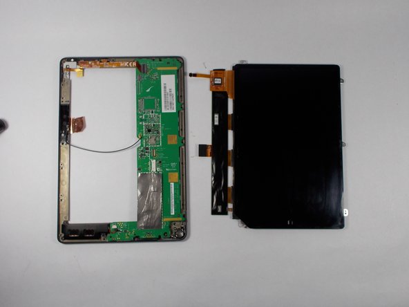

  8. Barnes And Noble Nook HD Tablet Screen Replacement, Detach the screen from chassis part 3: crwdns2935265:08crwdnd2935265:01crwdnd2935265:02crwdne2935265:0 Barnes And Noble Nook HD Tablet Screen Replacement, Detach the screen from chassis part 3: crwdns2935265:08crwdnd2935265:02crwdnd2935265:02crwdne2935265:0
    • Locate the foam covered orange strip on the motherboard. Pull up (away from motherboard) so that it i no longer connected to the motherboard.
  9. Barnes And Noble Nook HD Tablet Screen Replacement, Take motherboard away from the screen: crwdns2935265:09crwdnd2935265:01crwdnd2935265:02crwdne2935265:0 Barnes And Noble Nook HD Tablet Screen Replacement, Take motherboard away from the screen: crwdns2935265:09crwdnd2935265:02crwdnd2935265:02crwdne2935265:0
    • Lift motherboard away from the screen. Pull frame off of the screen.
  10. Barnes And Noble Nook HD Tablet Screen Replacement, Place new screen: crwdns2935265:010crwdnd2935265:01crwdnd2935265:02crwdne2935265:0 Barnes And Noble Nook HD Tablet Screen Replacement, Place new screen: crwdns2935265:010crwdnd2935265:02crwdnd2935265:02crwdne2935265:0
    • Put the new screen back into place in the frame (the reverse of step 9). Place motherboard back into place on the back of the screen. And follow steps in reverse order to reassemble.
