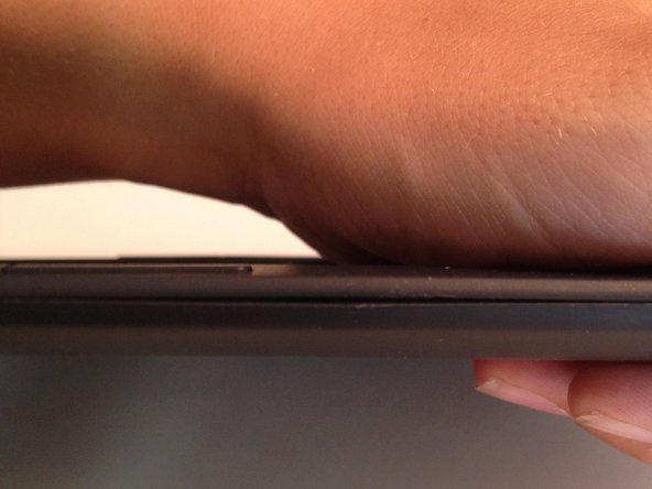

    • First Grab Your Jimmy or any other thin wedge tool and slide it along the edge of the device where the two halves meet.
    • Push firmly until the Jimmy gets wedged into the crack. Then rotate the Jimmy while sliding it down to separate the clips
    • Do This all around the device until the device is able to be split into two halves.

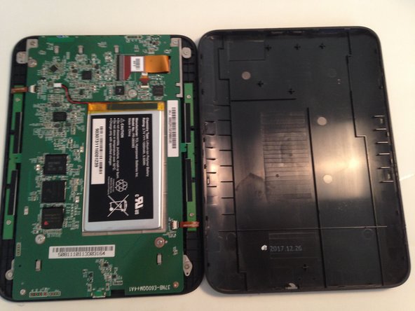

  3. Barnes And Noble Nook Glowlight 3 Screen Replacement: crwdns2935265:03crwdnd2935265:01crwdnd2935265:02crwdne2935265:0 Barnes And Noble Nook Glowlight 3 Screen Replacement: crwdns2935265:03crwdnd2935265:02crwdnd2935265:02crwdne2935265:0
    • When both of the halves are able to be separated move the back cover aside.
    • (To Reassemble push down on the back cover)
  4. Barnes And Noble Nook Glowlight 3 Screen Replacement: crwdns2935265:04crwdnd2935265:01crwdnd2935265:01crwdne2935265:0
    • Remove the screws marked in red
  5. Barnes And Noble Nook Glowlight 3 Screen Replacement: crwdns2935265:05crwdnd2935265:01crwdnd2935265:03crwdne2935265:0 Barnes And Noble Nook Glowlight 3 Screen Replacement: crwdns2935265:05crwdnd2935265:02crwdnd2935265:03crwdne2935265:0 Barnes And Noble Nook Glowlight 3 Screen Replacement: crwdns2935265:05crwdnd2935265:03crwdnd2935265:03crwdne2935265:0

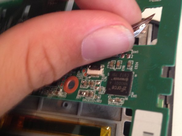

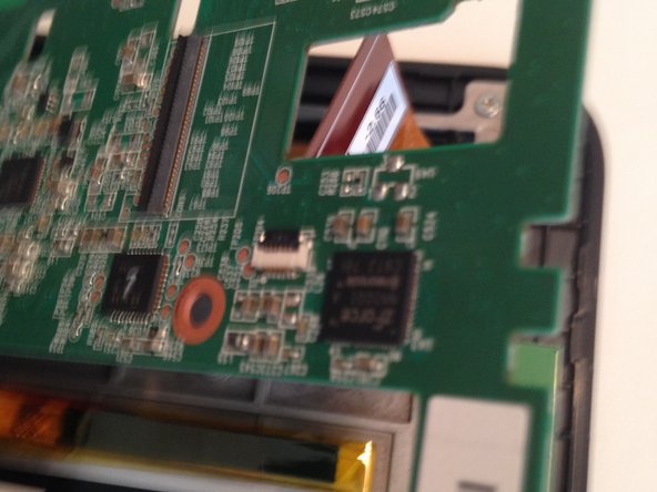

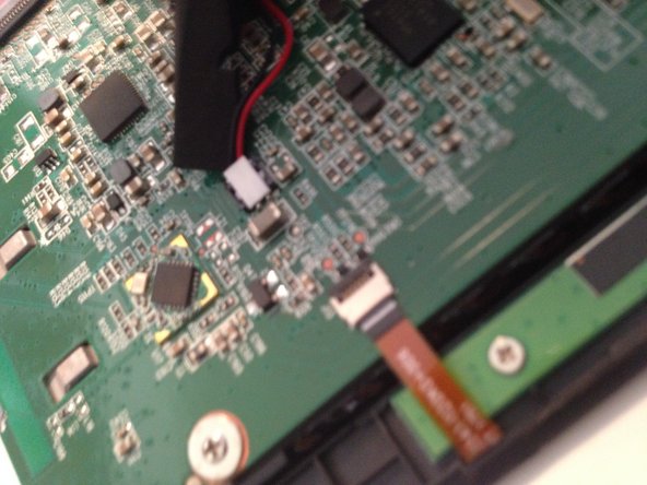

    • Disconnect the battery with a flick of the spudger.

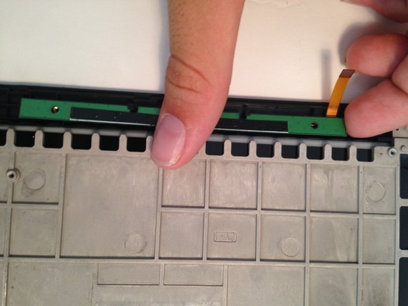

  7. Barnes And Noble Nook Glowlight 3 Screen Replacement: crwdns2935265:07crwdnd2935265:01crwdnd2935265:03crwdne2935265:0 Barnes And Noble Nook Glowlight 3 Screen Replacement: crwdns2935265:07crwdnd2935265:02crwdnd2935265:03crwdne2935265:0 Barnes And Noble Nook Glowlight 3 Screen Replacement: crwdns2935265:07crwdnd2935265:03crwdnd2935265:03crwdne2935265:0

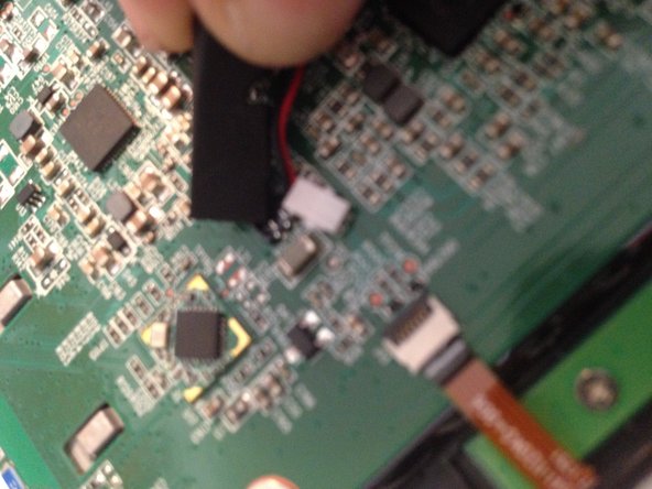

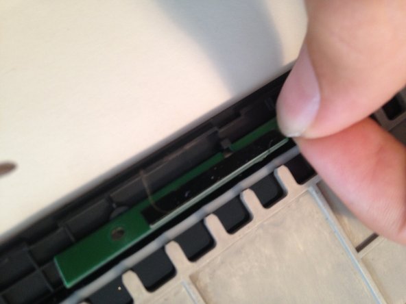

    • On both sides, there are two straight and skinny button panels. These control the side up/down buttons. Please disconnect both of these ribbon cables.

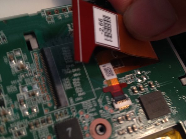

  8. Barnes And Noble Nook Glowlight 3 Screen Replacement: crwdns2935265:08crwdnd2935265:01crwdnd2935265:03crwdne2935265:0 Barnes And Noble Nook Glowlight 3 Screen Replacement: crwdns2935265:08crwdnd2935265:02crwdnd2935265:03crwdne2935265:0 Barnes And Noble Nook Glowlight 3 Screen Replacement: crwdns2935265:08crwdnd2935265:03crwdnd2935265:03crwdne2935265:0

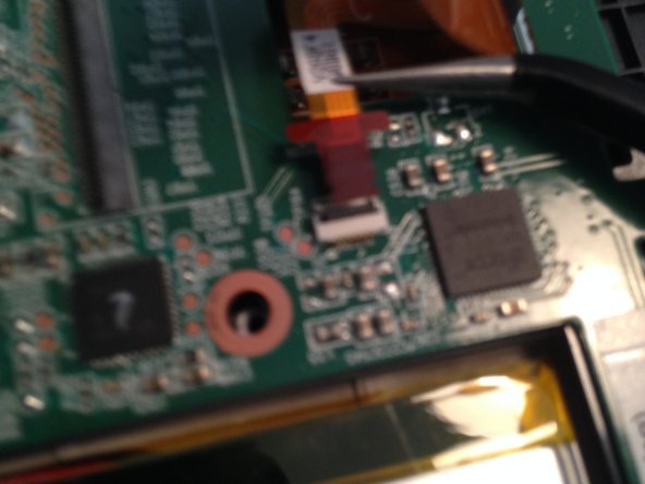

    • Now disconnect the display ribbon cables. ( one is hidden )

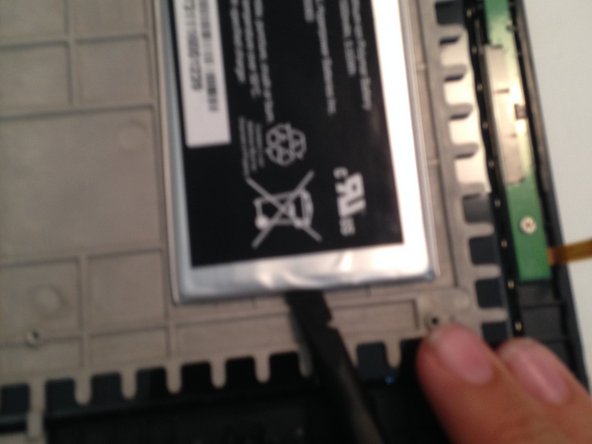

  10. Barnes And Noble Nook Glowlight 3 Screen Replacement: crwdns2935265:010crwdnd2935265:01crwdnd2935265:03crwdne2935265:0 Barnes And Noble Nook Glowlight 3 Screen Replacement: crwdns2935265:010crwdnd2935265:02crwdnd2935265:03crwdne2935265:0 Barnes And Noble Nook Glowlight 3 Screen Replacement: crwdns2935265:010crwdnd2935265:03crwdnd2935265:03crwdne2935265:0

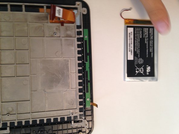

    • Now remove the battery by sliding a spudger underneath the battery and breaking the adhesive.
