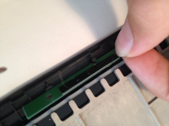

    • First, grab your Jimmy or any other thin tool and slide it along the edge of the device where the two halves meet, (shown in the picture).
    • Push firmly until the tool slides into the crack. Then rotate the tool as you slide it down to separate the clips securing the device.
    • Do this all around the device until the device splits into two halves.

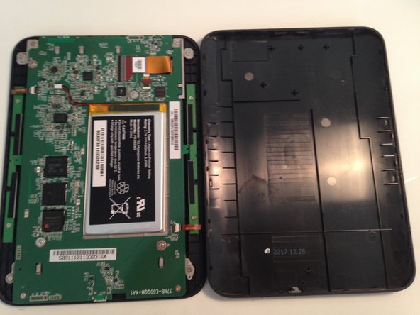

  3. Barnes And Noble Nook Glowlight 3 Disassembly: crwdns2935265:03crwdnd2935265:01crwdnd2935265:02crwdne2935265:0 Barnes And Noble Nook Glowlight 3 Disassembly: crwdns2935265:03crwdnd2935265:02crwdnd2935265:02crwdne2935265:0
    • When both of the halves are able to be separated move the back cover aside.
    • To reassemble the device, push down on the back cover until it snaps into place.

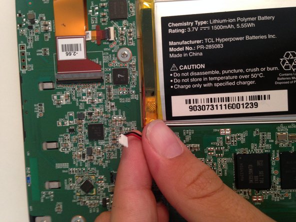

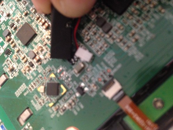

    • Disconnect the battery with a flick of the spudger.

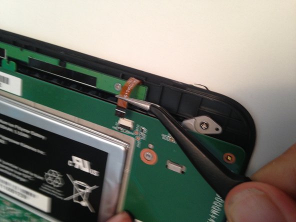

  6. Barnes And Noble Nook Glowlight 3 Disassembly: crwdns2935265:06crwdnd2935265:01crwdnd2935265:02crwdne2935265:0 Barnes And Noble Nook Glowlight 3 Disassembly: crwdns2935265:06crwdnd2935265:02crwdnd2935265:02crwdne2935265:0

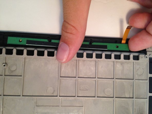

    • On both sides, there are two straight and skinny button panels. These control the side up/down buttons. Please disconnect both of these ribbon cables.

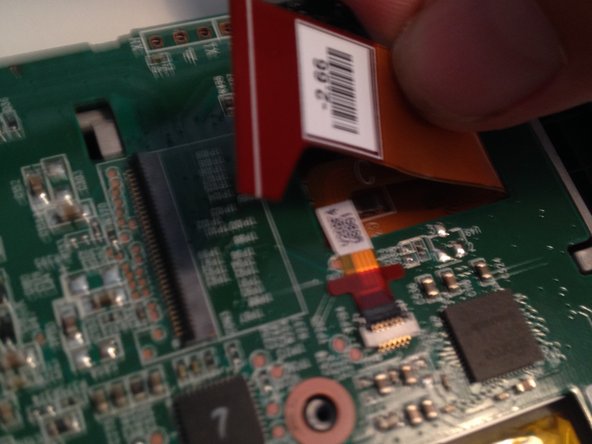

  7. Barnes And Noble Nook Glowlight 3 Disassembly: crwdns2935265:07crwdnd2935265:01crwdnd2935265:03crwdne2935265:0 Barnes And Noble Nook Glowlight 3 Disassembly: crwdns2935265:07crwdnd2935265:02crwdnd2935265:03crwdne2935265:0 Barnes And Noble Nook Glowlight 3 Disassembly: crwdns2935265:07crwdnd2935265:03crwdnd2935265:03crwdne2935265:0

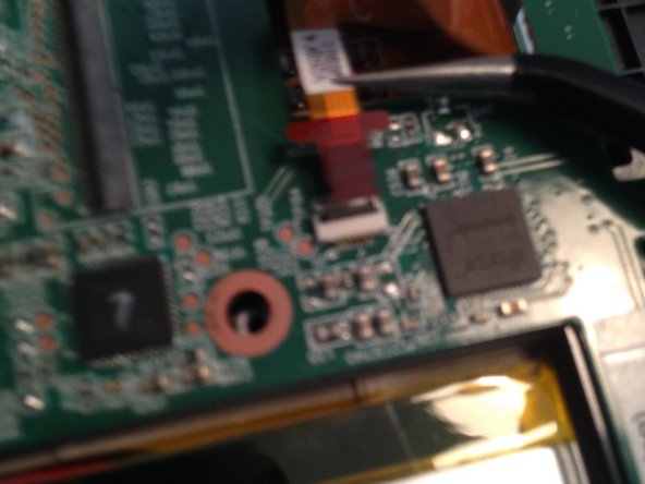

    • Now disconnect the display ribbon cables. ( one is hidden )

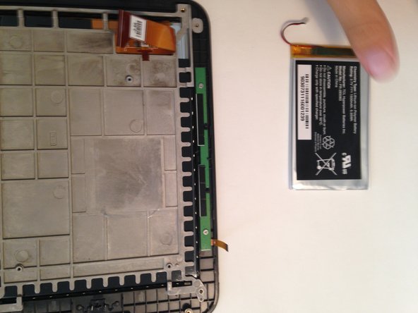

  9. Barnes And Noble Nook Glowlight 3 Disassembly: crwdns2935265:09crwdnd2935265:01crwdnd2935265:02crwdne2935265:0 Barnes And Noble Nook Glowlight 3 Disassembly: crwdns2935265:09crwdnd2935265:02crwdnd2935265:02crwdne2935265:0
    • Now remove the battery by sliding a spudger underneath the battery and breaking the adhesive.

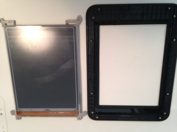

    • Remove the rest of the screws connecting the display to the frame. Remember to take out both of the button boards.
  12. Barnes And Noble Nook Glowlight 3 Disassembly: crwdns2935265:012crwdnd2935265:01crwdnd2935265:02crwdne2935265:0 Barnes And Noble Nook Glowlight 3 Disassembly: crwdns2935265:012crwdnd2935265:02crwdnd2935265:02crwdne2935265:0
    • Push firmly on the display. Going all around the edges until the display becomes loose. (the screen was already cracked)
